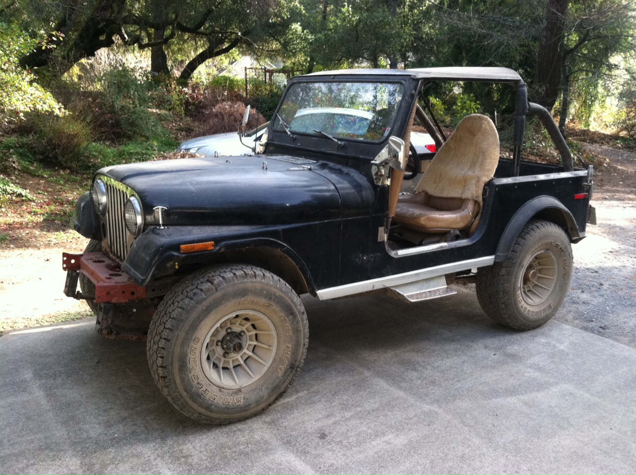

I just decoded my vin and would like to know how do I know what model it is for that year. If it happends to be a golden eagle how do I find out this information?
This vehicle's data:
Year 1977
Plant / Transmission Toledo, 3-speed, Left Hand Drive
(GVW) Rating 4150 lbs GVW, models 83, 84, & 93
Engine V8, 304 CID, 150 HP
Model Year 1977
Thank you

Thank you for the info, looking like it just a old 77 cj7.
