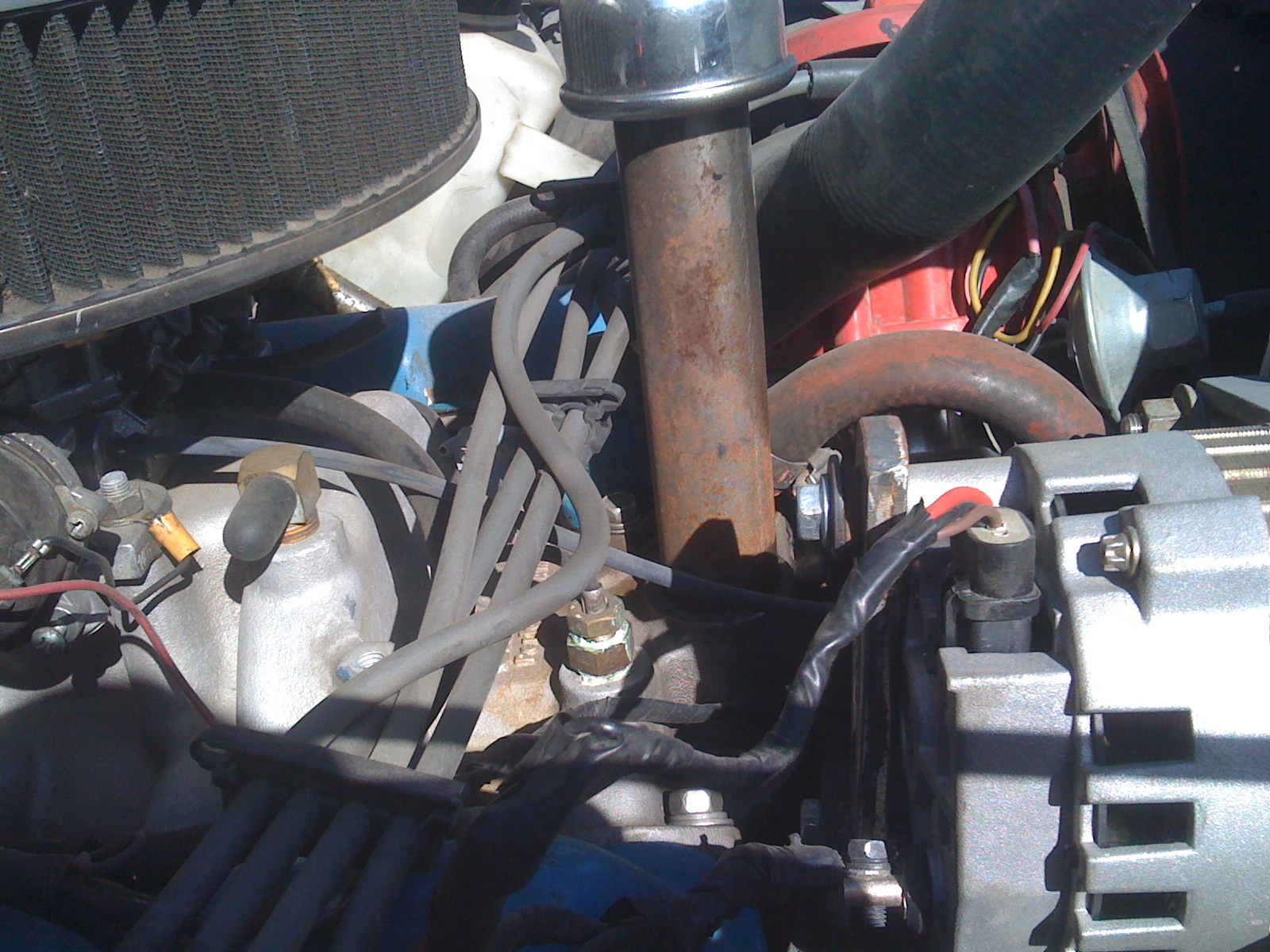

Do not use the fitting for the electric sending unit hole. I just left the electric sending unit there to keep it plugged. On the pic is a water Jacket hole where i installed the mechanical sending unit with an adaptor.

WOW
Now I'm pretty sure when I searched for alternative access on my Performer manifold there was not a plug or boss behind the alternator. But now you've got me wanting to play hooky from work and head home to look at mine again! I'm sure that Edelbrock didn't change manifolds between the 304 and 360 unless like Chevy's 400 block there were additional cooling passages in the manifold and heads.
Just to be certain can you see your manifold's part no.?
Hmmmm,
Well my garage isn't VERY well lit, I'm kinda half lit myself when I come draggin' in from work.:coffee: This lunch I'm going to take another look and post pics if it is different from yours. Thanks again for your responses :drunk:
Hmmm, No wonder I couldn't spot the dang thing.
Now I have a NEW problem....
:bomb: It's hard to see in these photos but the pipe plug seems to have been screwed up long ago by pliers or vice grips. I tried clamping onto the nub myself but it won't budge, any ideas on how to extract this dang pipe plug?
