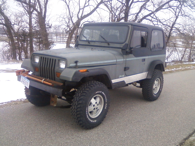

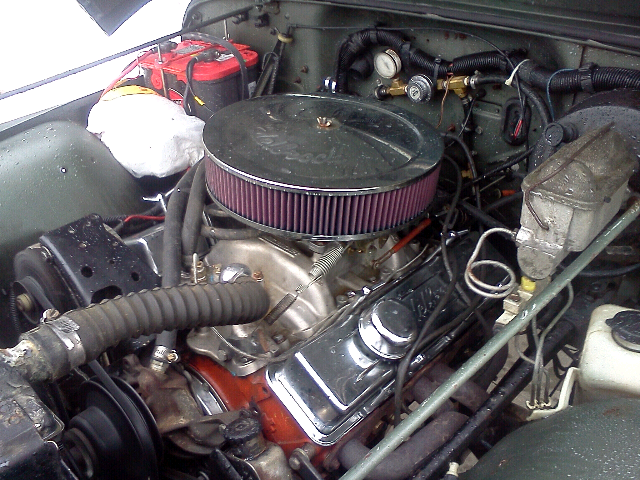

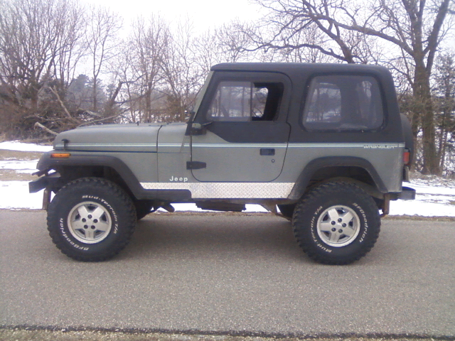

Ive found a kit for $200. I cant have full time 4 wheel drive as I use my heep for a daily driver too. Theres a link im waiting on where a guy is buying the parts needed to do the conversion for $15 and using the stock actuator housing. If I get the diagram I may try this first and take pictures of the process and post them on here when I get the chance. Im kinda stuck in limbo tho cause ide like to do a axel swap front and rear. I get a little nervouse having a turbo 350 trany and a built 283 chevy small block lol
The heep lol

Thanks for explaining that jfrabat I misunderstood that.. I'm going to give it a try tomorrow .. thanks superj I like the power I get from the 283.. I left all the plugs in tact so if I want to go back to the 6 cyl they are their. Might have to with the way gas prices are going...
I just pulled the timing chain out and did a gear drive set up. I like the whine it has now...
