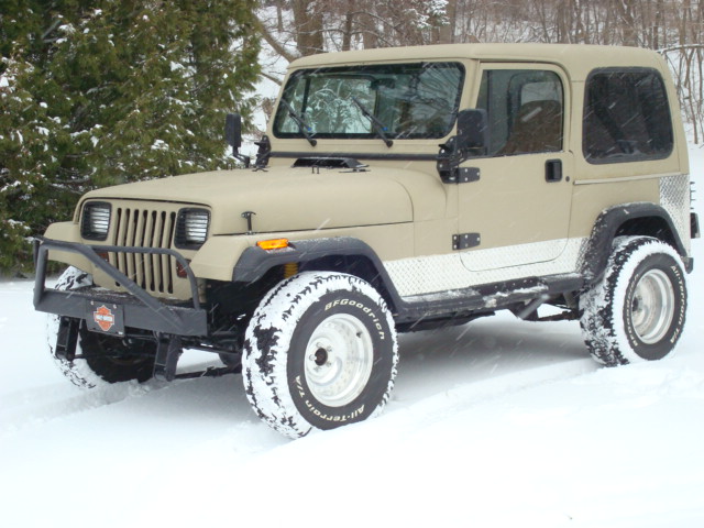

Headlight switch was plugged in upside down. I unpluged and plugged it back in. Works fine now. Thanks for the help got it going good now.
