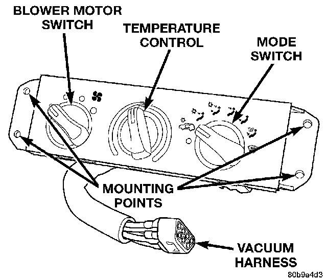

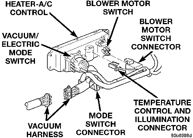

To me it sounds like the Vacuum control mounted behind the HVAC control head. it would have a 3 or 4 electrical spade connector and a series of colored Vacuum lines plugged on to it. the detent section has probbably fallen apart. if thats whats broken, I've got one just laying around. Free but you pay for the shipping. Take a Picture of what you found so we know if i have the correct part for you. and for anybody who needs a Knob, i have 2 of them, also for free, you pay for the shipping. send me a P.M. to who ever is interested.

On my 2001 the switch is hard mounted to the A/C board by a sturdy ring and soldered in. Since yours is a 99 there might be a slight difference, but I doubt that it is very much.
It only takes about 20 minutes to pull the center dash apart to see and less time to put it back together once you have done it.
When the YJ became the TJ starting in 96-97 ( yes folks there are some 1996 TJ's out there) DC started to change over the A/C control module from a part mechanical to full electrical. They completed the changes in 2001 then made a major change in design in 2003 to match the Rubicon model.
But the basic removal of the center beauty cover is the same through out all of the TJ's. The best advise is grab a phillips screw driver and check it out.
