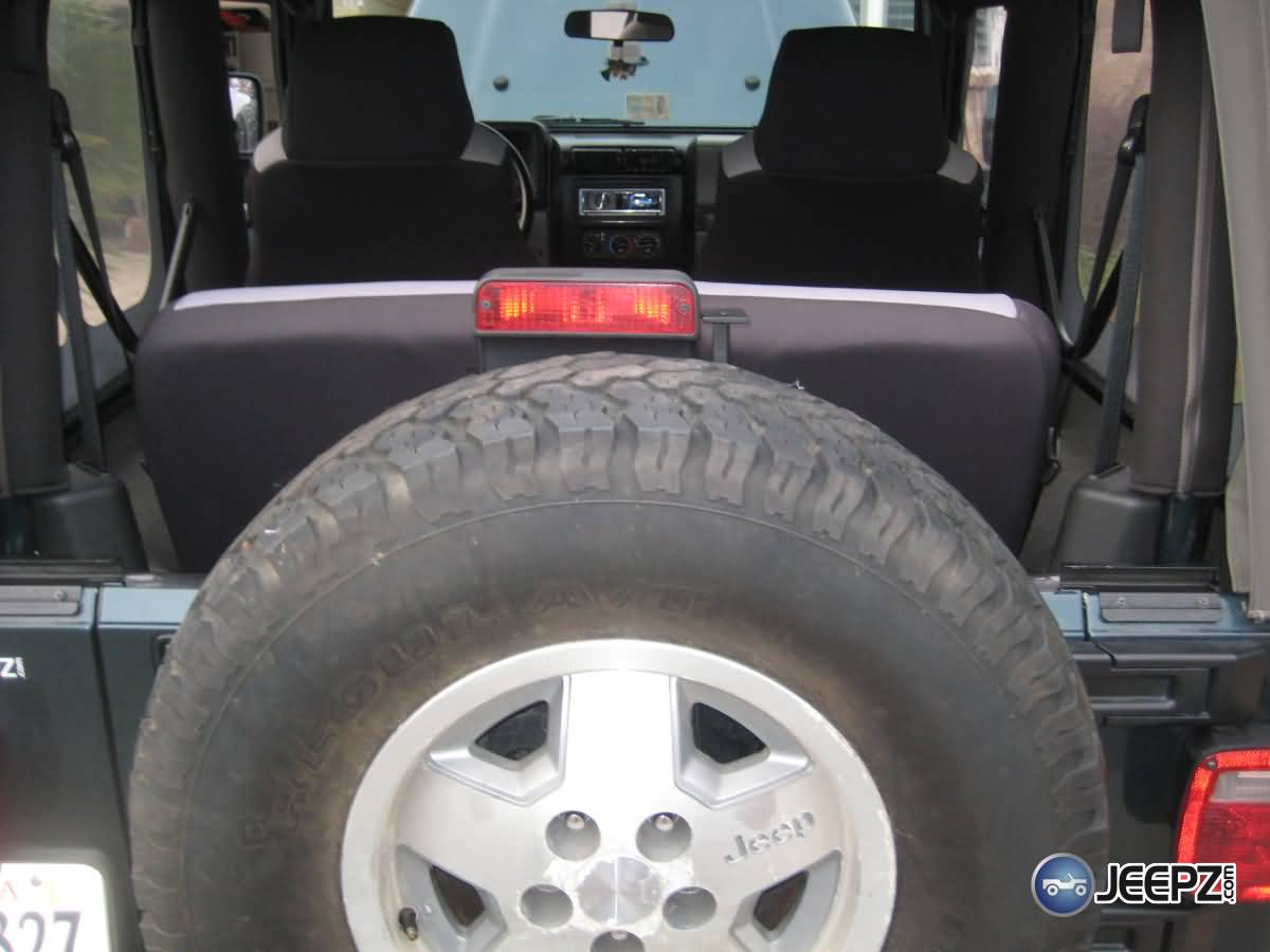

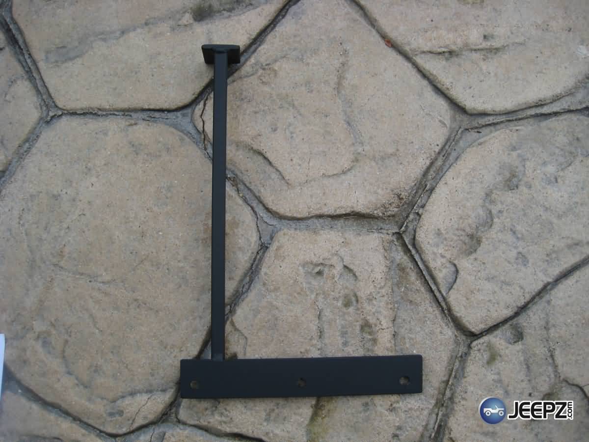

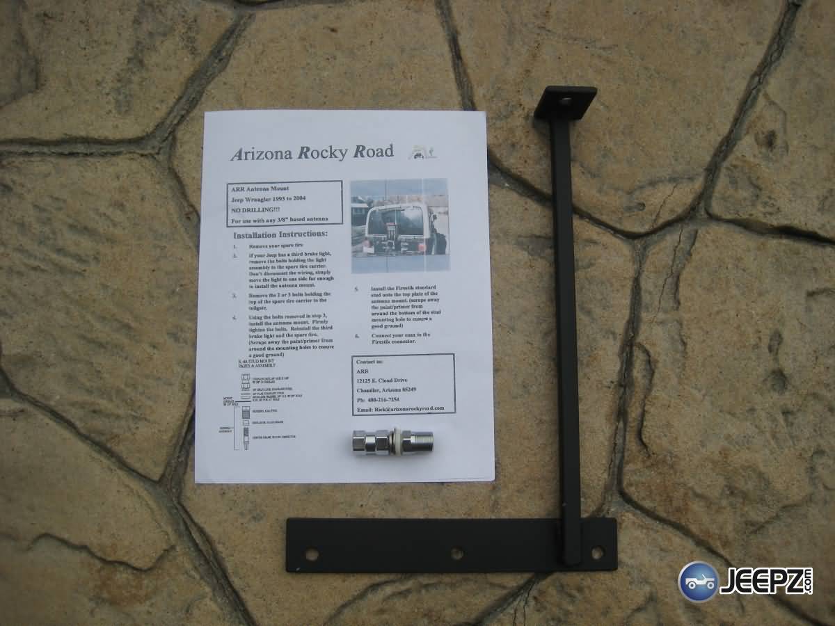

What's included with the CB mount
Here's what comes in the package - The mount itself, and some instructions.

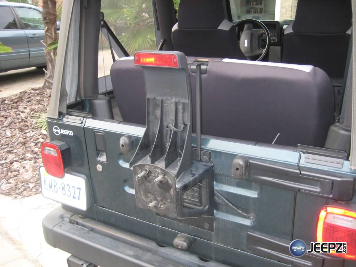

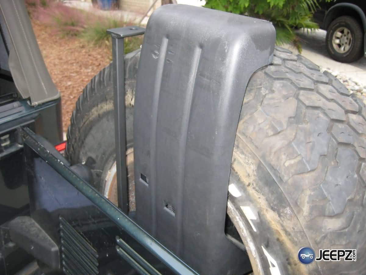

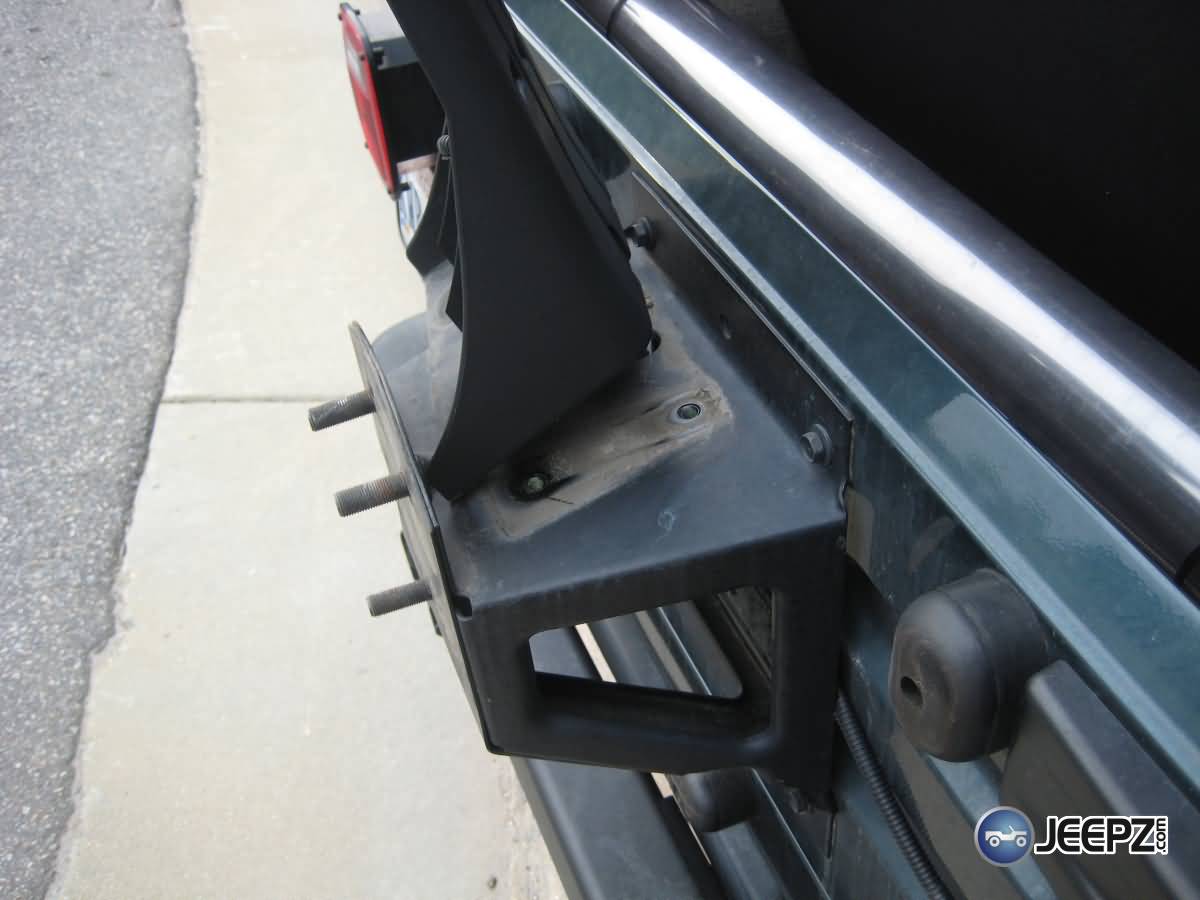

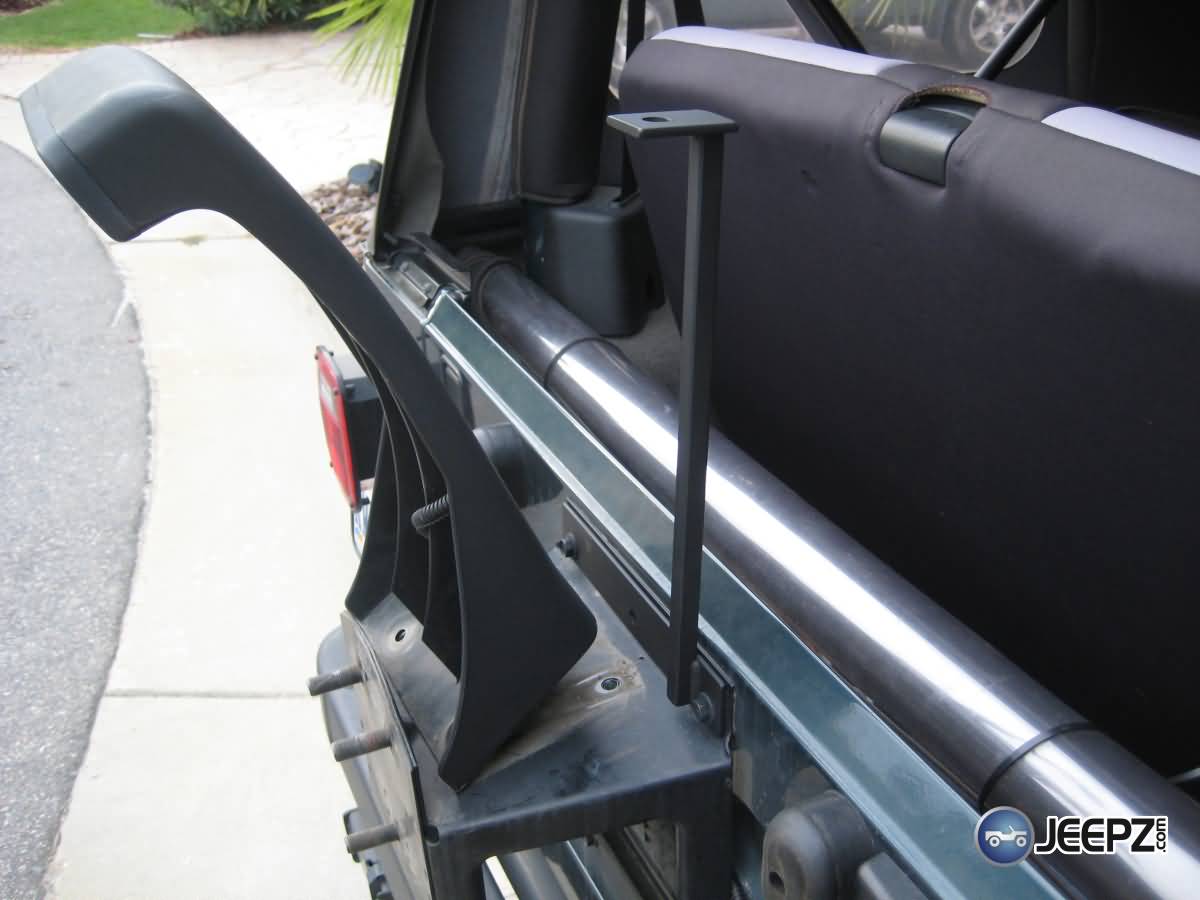

Installing the Wrangler CB mount
To install the CB mount, you just need to remove your spare tire, then take off your tire mount, and bolt it to the tire mount and the body.

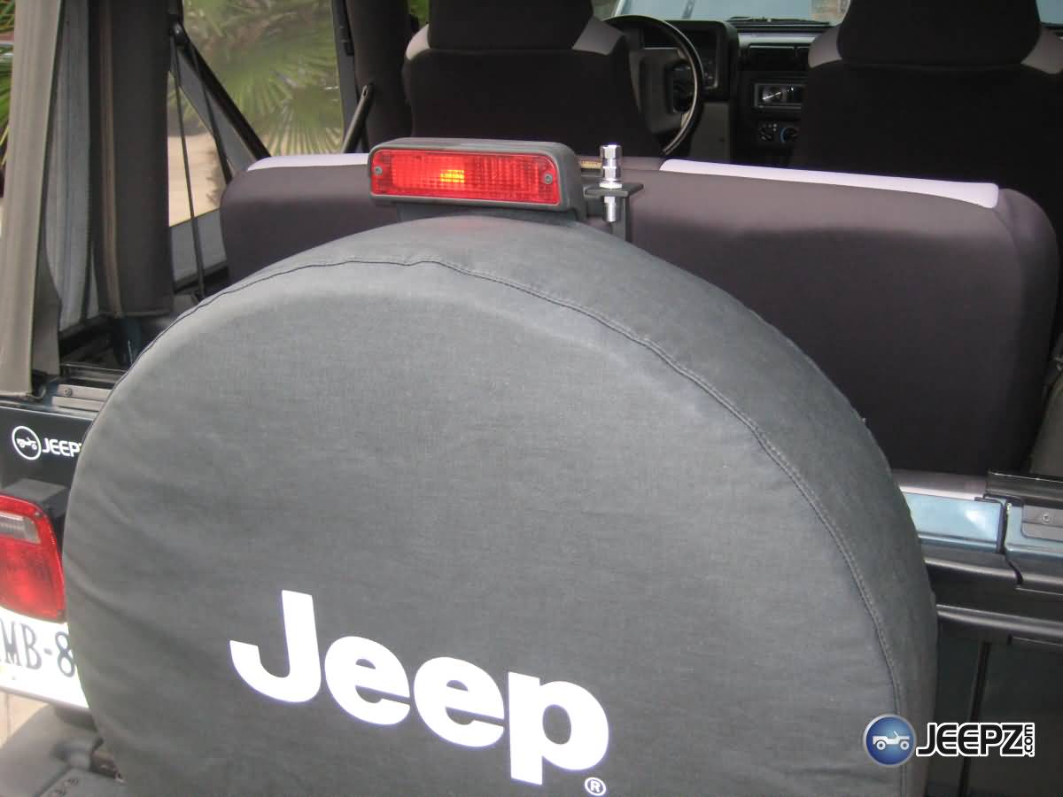

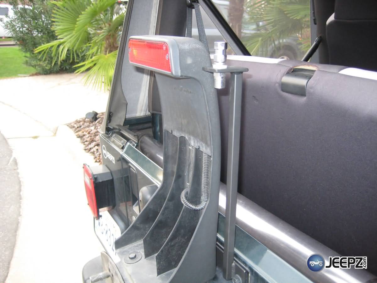

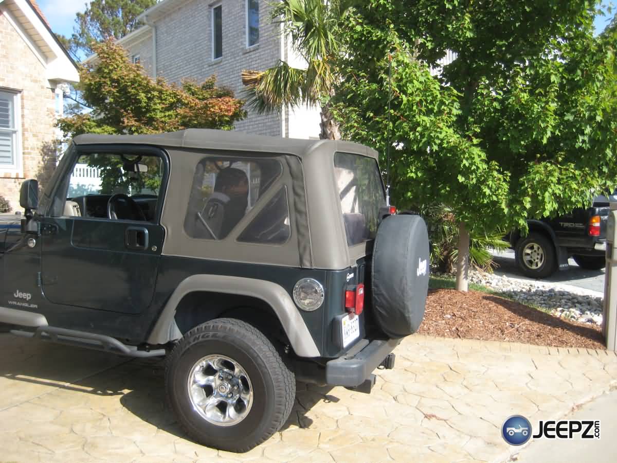

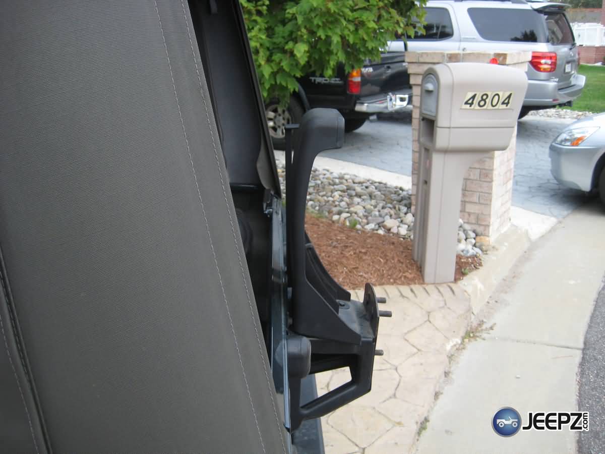

Wrangler CB mount - finished product
And some shots of the finished mount. Overall I think this is the best mounting option for a Wrangler antenna - well worth the money.

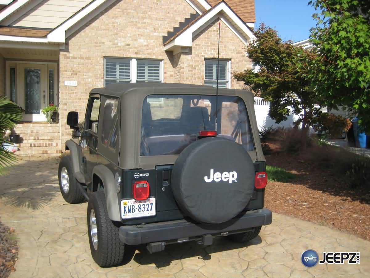

That does seem like it would work well, as long as the top is off. I can see the antenna whipping a hole in your top if you trail ride where a lot of trees are.
I've only been offroading with it on once, and it really didn't seem to be a problem. The spring I purchased for the base is pretty stiff, so you will hear the antenna whack my top, but it takes a tree pulling the antenna back for that to happen. I won't hit the top due to just driving or wind.
