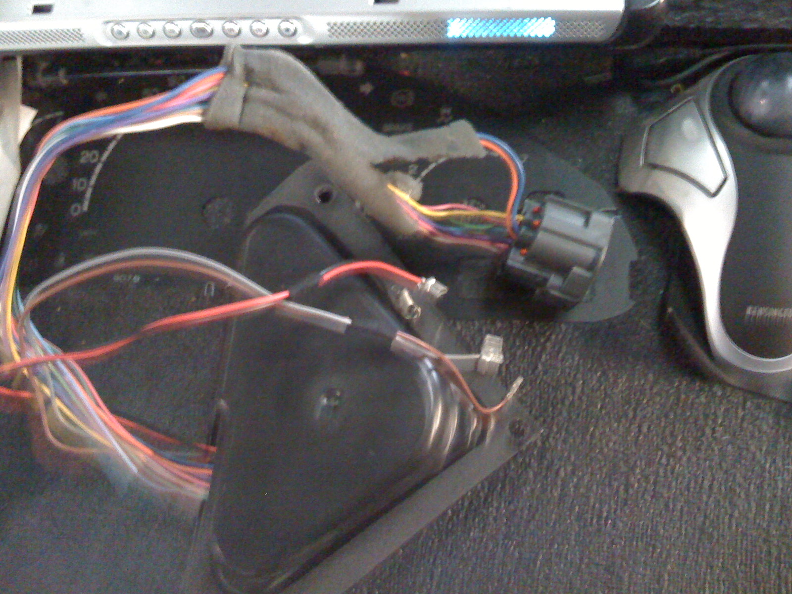

Wrangler stock sub photos
Here are a couple of photos of the stock subwoofer. The black enclosure that holds the sub also has the stock amp built in.

There's no way that you can put anything larger than a 6.5 in the stock enclosure. Take a look at those photos - a 12" sub would be larger than the box itself. As it stands, anything larger than a 6.5 will be too deep for that box.

To anyone else who might need to do this - wiring the new sub from Parts Express was a little different than the stock one. The stock sub had 4 wires connected to it, but doing so on the new one produced no audible response. Hooking up 2 wires only (in my '03, at least) did the trick nicely. Long term affects? Eh, we'll see. It's a $13 sub, so I'm not terribly concerned. Also, I recommend not reusing the screen from the stock sub. Not only did it seem to contribute to the blowout by chaffing the cone where it connects to the frame, but I couldn't see how it would fit with the new one without some mods. Plus, it looks kinda nice.

Well I got the same parts express piece today, unfortunately the screws don't line up where the old four use to be? How are you placing the sub into your consoloe without the four screws, or did you do some sort of modification? Can I get a quick response please..while my car is torn apart.
You have to drill new holes. Just line up the sub where you want it and where the wires don't interfere with anything.
I don't remember what sized bit I used, but it was a bit smaller than the stock screws.
Don't tighten too much, or you'll strip the holes - that plastic is softer than it looks!
