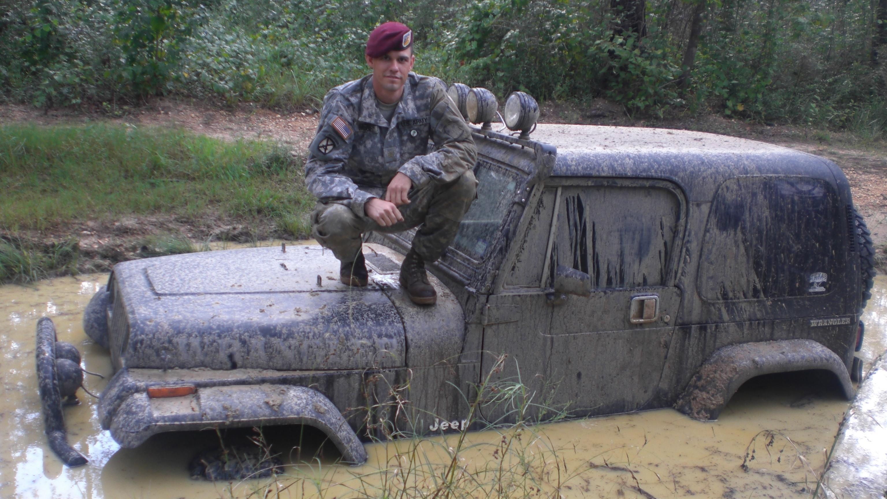

Enjoy the pic! (yes i was on my way to a meeting...which i didn't make it to.)

I'd like to hear that excuse??Cause I'm like an old dog in heat when I'm driving around, just looking for that break in the tree line..
HA! Actually the excuse was honesty... I told the boss that I took a short cut and had a breakdown along the way. See...totally honest!
Coppers Cove huh? I was at Hood for four years myself, I think there was some pretty good at out by BLORA, but I never made it out there.
That was definitely a variation of the truth.8) There are a few good spots left around, but every year we have to drive farther and farther away...Right now I've been stuck in South Korea for the past 12 months. only 21 days left and I figure 4 days after that I'll have my own broke down and ticketed story to tell.:D
