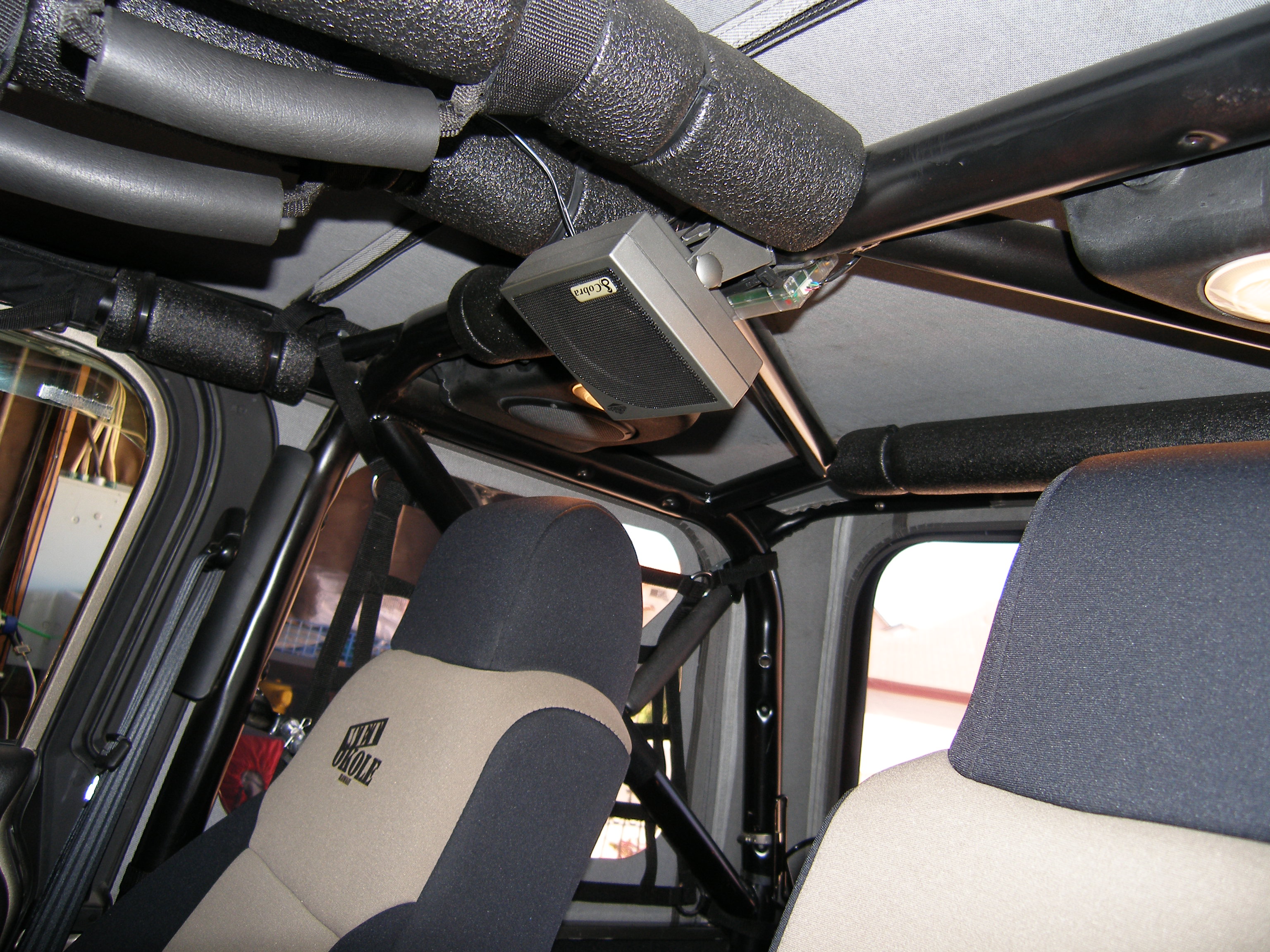

It's a lot easier to just plug in an external speaker to the back of the unit. I have mine mounted between the speaker pods on the 'B' pillar of the roll bar where I can hear it loud and clear regardless of conditions. Besides, if you are tying in the speaker output directly to all your car stereo speakers won't their be a concern about impedance load on the CB, whereas a dedicated external speaker designed for this purpose will be matched perfectly. For example, the Cobra external speaker is rated for 15 watts @ 8 ohms; plenty of power handling capacity at the right impedance match.

Everyone else. I also agree with ya'll. I don't think it'll fit unless i ubber mod the dash. And why would i do that when I could just set up externals. hmm...
