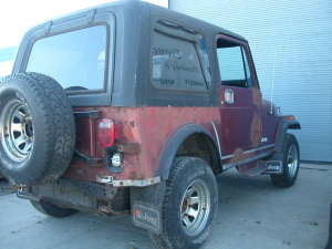

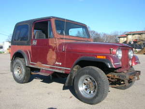

one is a 1986 cj 7 with a hard top 4 speed hard doors decent body clean interor high miles. it has a new carb new windsheild frame but no wipers or wiper motor. Also has some primer spots that worry me. and it is idleing high and no front bumper.

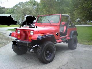

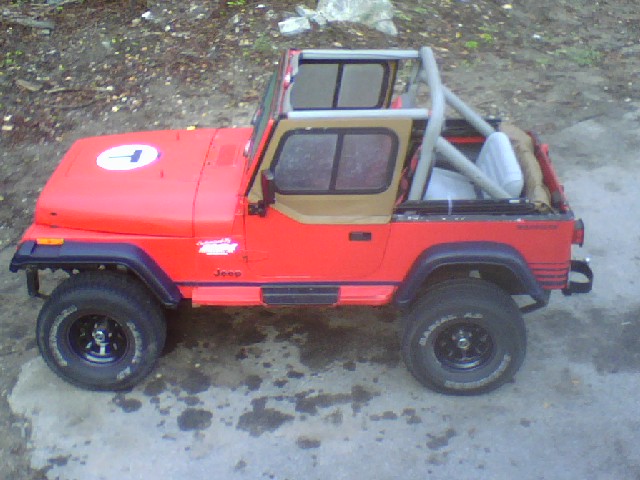

the second is a 1989 yj
it has a soft top that needs to be replaced but has no holes. has half doors with glass sliders. has nice body and frame with a pin hole in the floor. also needs the motor rebuilt or replaced. new transmission and t case. But the transmission is a ba 10/5 the t case is the solid NP231. has new rear axle but it is a dana 35c. This jeep also has new carpet a new weber carb kit not installed, set off 33 alterans a tuff country 3.5 lift with t case drop kit and 1 inch shackle kit. also it does have the unfortunate vacume front disconect axle. needs the motor done needs tilt on colum fixed, needs front drive shaft installed.

They both look like they need a good bit of work. I guess the YJ might be a better choice because of what looks to be extensive and shotty bodywork on the CJ. If the rust issues that warranted that bodywork were not dealt with properly then it'll be back. I'd look the Cj's frame out really well before buying it - especially near the rear shackle hangers ;)
Oh, and the YJ has the superior headlights too !

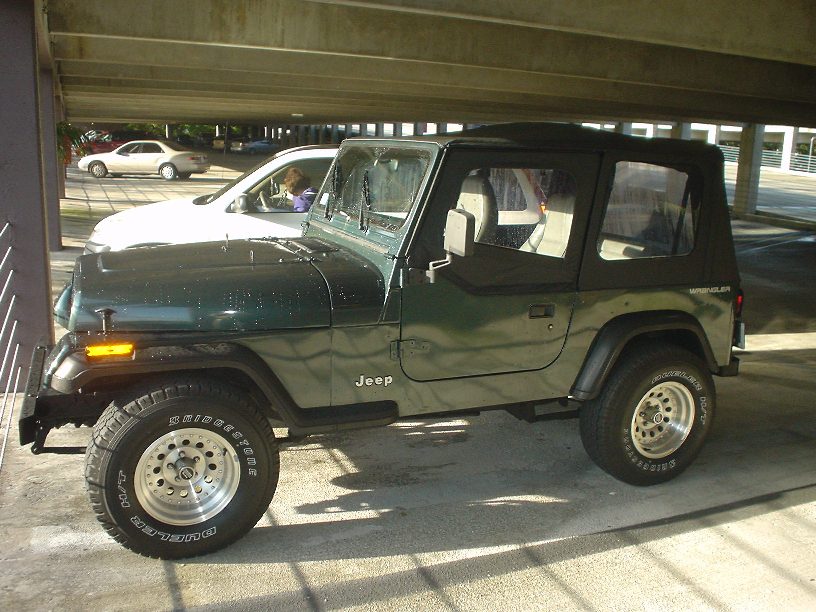

I am fairly new to Jeeps, but I bought a new (mostly stock) 94 YJ with the 2.5L 4 banger, and I am happy with it. I have had to do some minor repairs and have put some minor mods on it, but it is running fine. This YJ was in actually very good condition to start with, although it had 110K miles on it. Just in case, though, I did a COMPLETE maintenance to the car, to avoid any future problems that could have been avoided. The only thing that has really come out is the problem where the engine stutters on hot days after driving for some time, and the fact that the fuel system was dirty as heck! But I do think the problem is the fuel pump, and I will replace that soon...
When I bouth it, the YJ had 31 Duelers (HT) on American Racing outlaw II wheels (offset, so the Jeep has that "wide stance"). There was no lift, so the wheels are running a bit close to the frame for my taste. It's fine for the road, but not for offroading IMHO... But it does look nice, especially with the square lights up front (which only the YJ has and I like better, although some will say it makes it less of a Jeep because of it; I guess to each his/her own!).
Since, I have put a Gibson Cat-Back, the dealer I bouth it from also replaced the cat (for a crappy one, I should mention, but still, a free new crappy cat is not unwelcomed in my book!), removed the 2 air restrictors from the intake box, dropped ina K&N filter, installed KC Daylighters on the windshield bracket, put a console in the center, installed sound system (I do work for Sony, so I could not pass on that! I have a pair of 4 1/4 speakers in mop-pods beneath the doors, 6X9 speakers on sound wedges between the roll cage and the rear wheelwells, and a 12" subwoofer on the back; it sounds SWEEEEET!), and this weekend I plan on installing the hardtop (got a new Pavement Ends one on clearance from eBay to replace my Best Top Soft top during the winter), change the Oxygen Sensor (just received the new Bosch one; let's see how that goes!), and install the Throttle Body Spacer.
Eventually, I do plan to do a 4.0L Throttle Body Swap, to increase HP a bit... After that, I intend to do a Spring Over Axle conversion (with all the implied changes), and go for 33" tires, but I have to wait until I save some more money for that one. This SOA conversion is one of the main reasons I preffer YJs over TJs, as the end result (although A LOT more work) is great! They also tend to be a bit cheaper, as they are older.
I WILL have to get all the paint off this car and repaint it at sme point, as it does have some chips on the paint and you can see the rist starting to form (plus the windshield has a big rust spot that has already made a small hole on the outter frame, so the frame will be changed), but again, that will have to wait until the bank account grows a bit!
After that, I was thinking about a winch, another pair of daylighters, new (wider) fender flares, a new alternator, a new water pump, new bumpers, snorkel, on-board air system, electric fan (was thinking about the Ford Taurus one to keep costs down), changing all the radiator hoses for better ones, rocker guards... Now thinking about it, it seems that for every item I buy and take off the list I end up putting 2 new items!!! The eternal money pit, if I have ever seen one! Looks like this Jeep will end up costing me about 4 to 5 times what I paid for it in the first place!
By the way, at the time of the picture, I had only done the maintenance, and installed the console.
