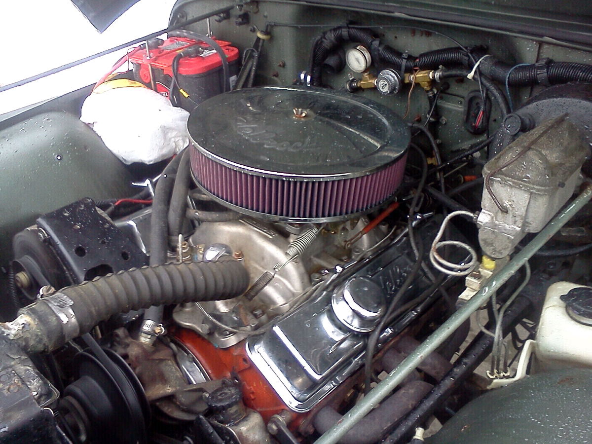

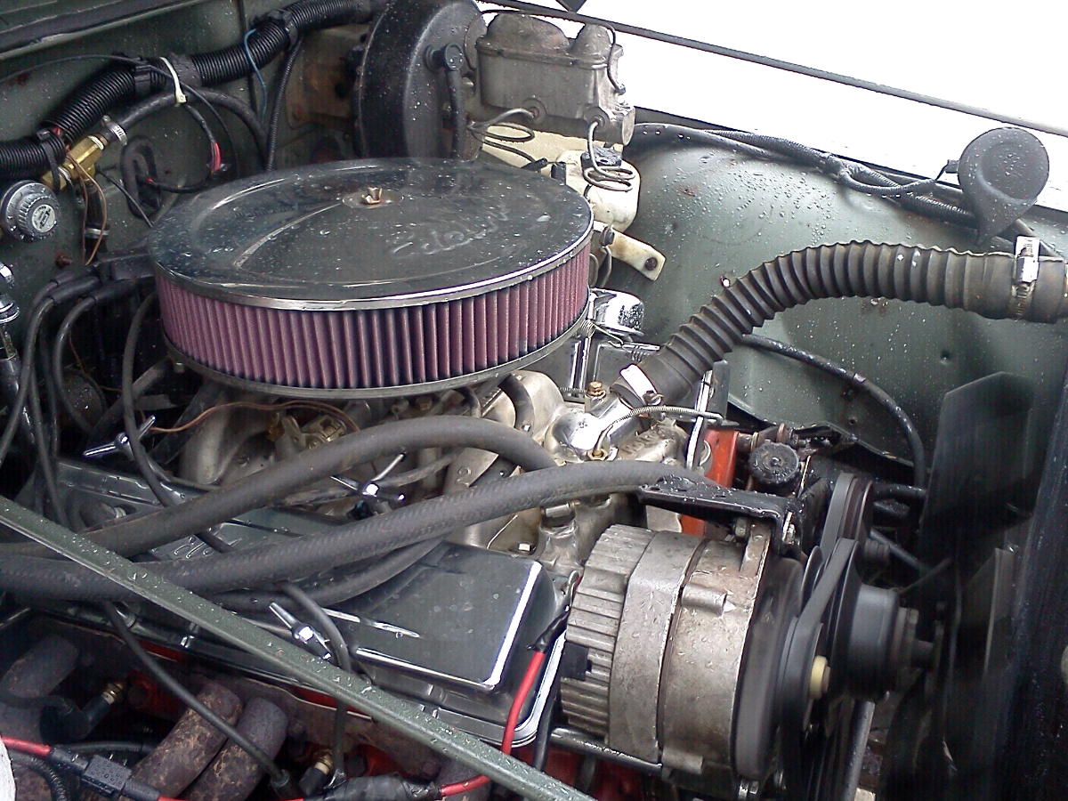

I did a 283 chevy small block and a turbo 350 transmission in my 92 yj and it looks pretty good and wasn't to hard...
