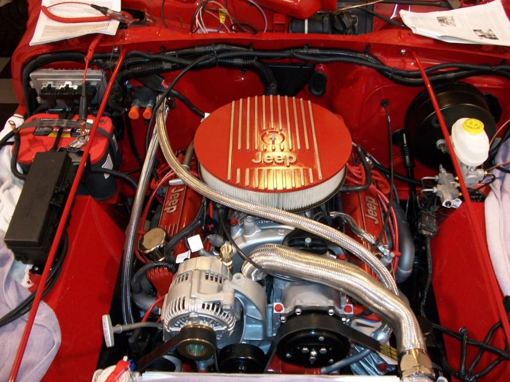

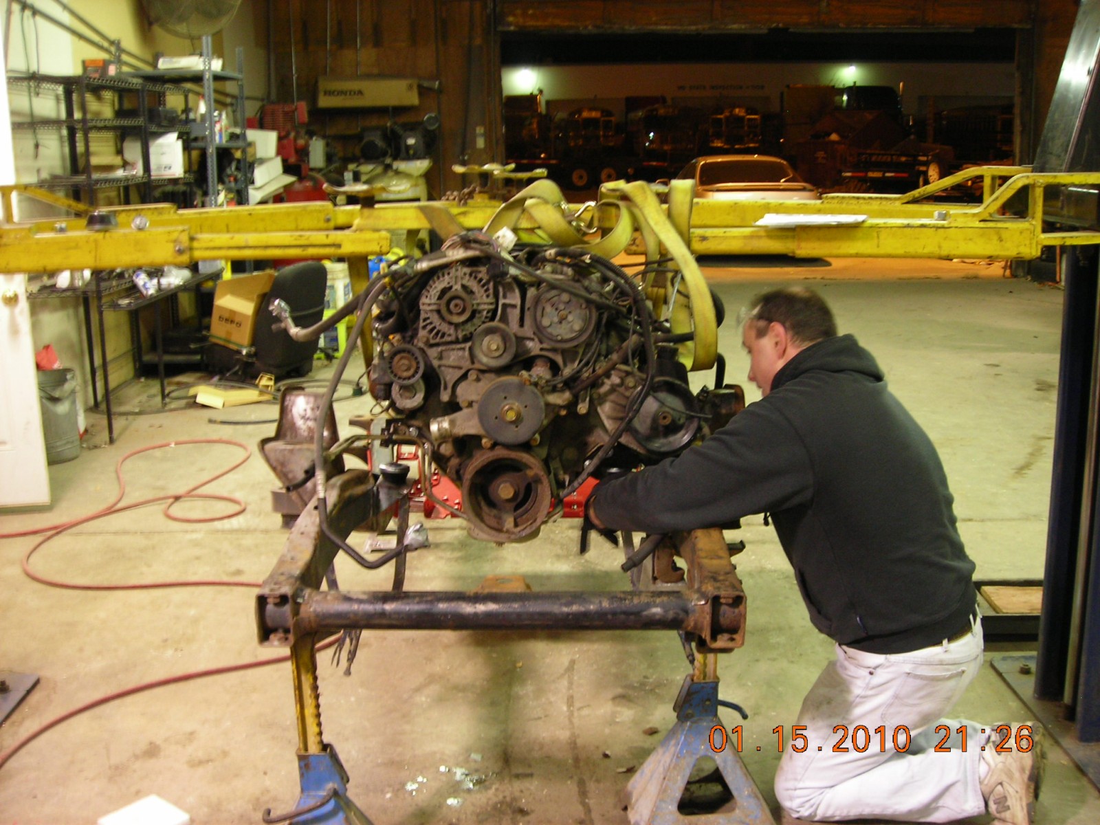

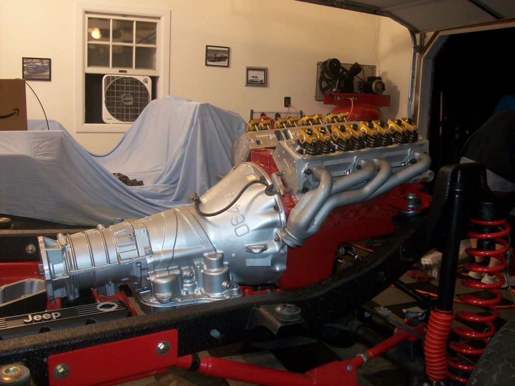

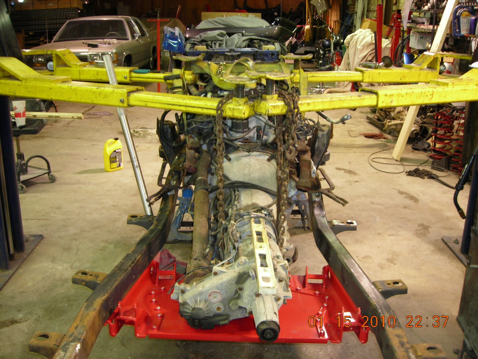

I have a 360 in my 97 TJ. came out of a 2001 dodge ram 2500..with trans..and was able to adapt to TJ t-case ....computer and all ...all I did was buy a wrecked dodge 2500 for a 1000 bux and pilfered all the parts for the build.

the first pic shows where on the frame the engine mounts were welded to.
second pic shows how long the whole assembly was during mock up
third pic was after rebuild and paint...but you really don't need to make it all pretty...just functional
last pic shows how it looks in the engine bay....
