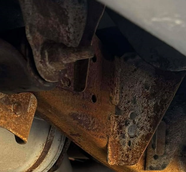

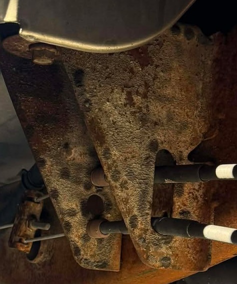

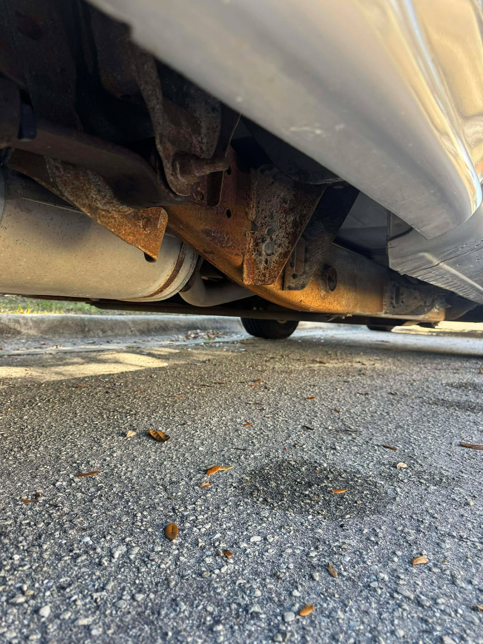

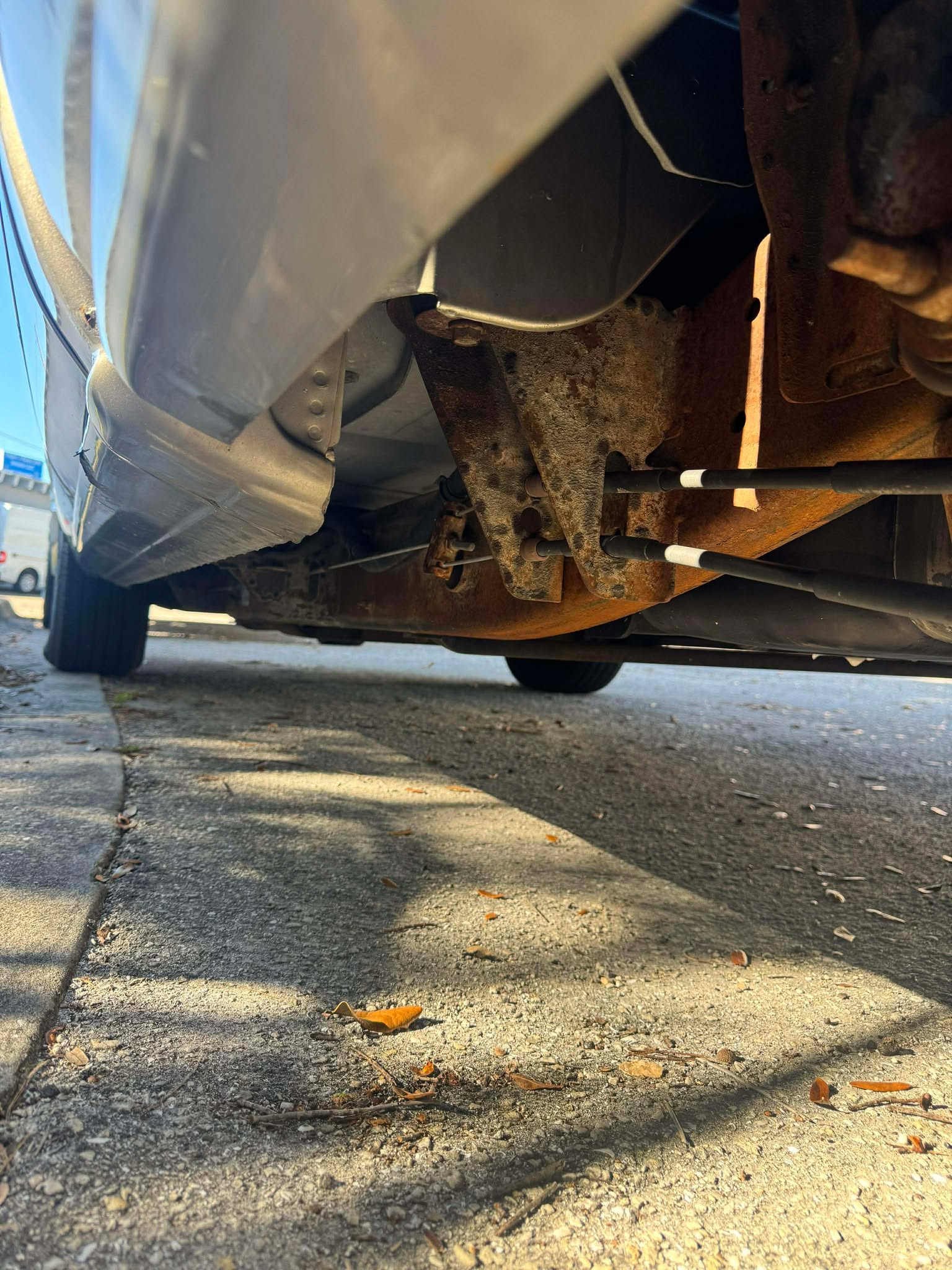

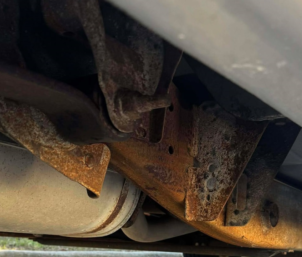

I'm trying to evaluate this 2006 Silverado I'm looking at buying, and since these things are old and prone to rust, I need to understand what I'm getting into before I commit to a really long drive. The guy selling it sent me a few shots of the frame, and even though it's got some rust I'm not sure how bad it is. It's more than I want to see, but is it bad enough to just say no altogether?
Looks OK to me, assuming you're getting a good deal. If I bought it I would immediately treat with something - fluid film will help it for a season. Do inside the frame rails and outside.
As long as there aren't any rust holes or bubbled up areas it wouldn't bother me.
