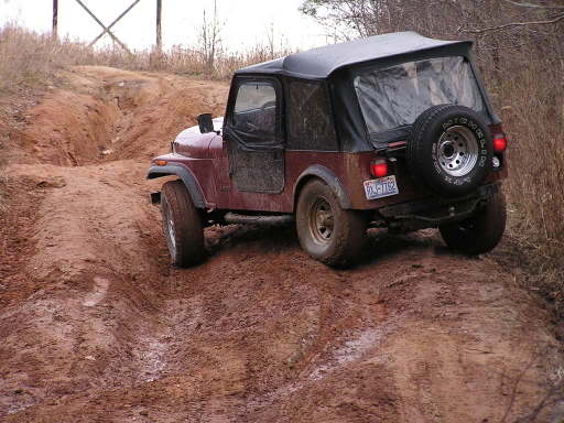

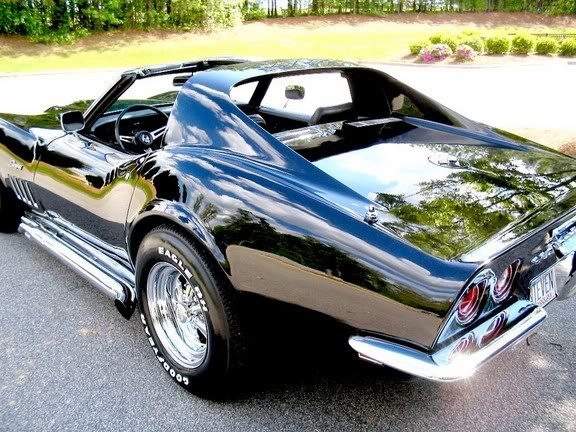

few pics of my toys. my z28 resto pics are not on this pc but this is my beloved CJ7 and my 69 Corvette

I just have to say that is one EXTREMELY NICE Corvette!!! '69 has always been my favorite year...and that one is soooooo clean!
