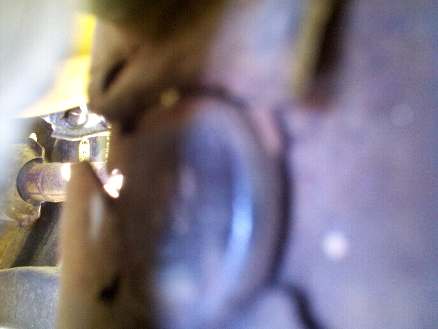

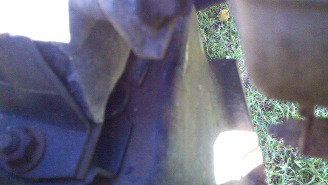

69JeepCJ, Its not the horn but a small metal U shaped bracket the two bolts from the mount connect to. This U shaped bracket has one hole that mounts to the frame horn. I two of the best pics I could with my phone but don't know how to get them on here.
Ok here are the pics
This shows the mount on top of the bracket
This shows the crack that goes through the bracket.
Totaly your prefferance. I would just replace or weld the one, but some would feel better doing both. It looks like its not actualy part of the motor mount but supports it.
