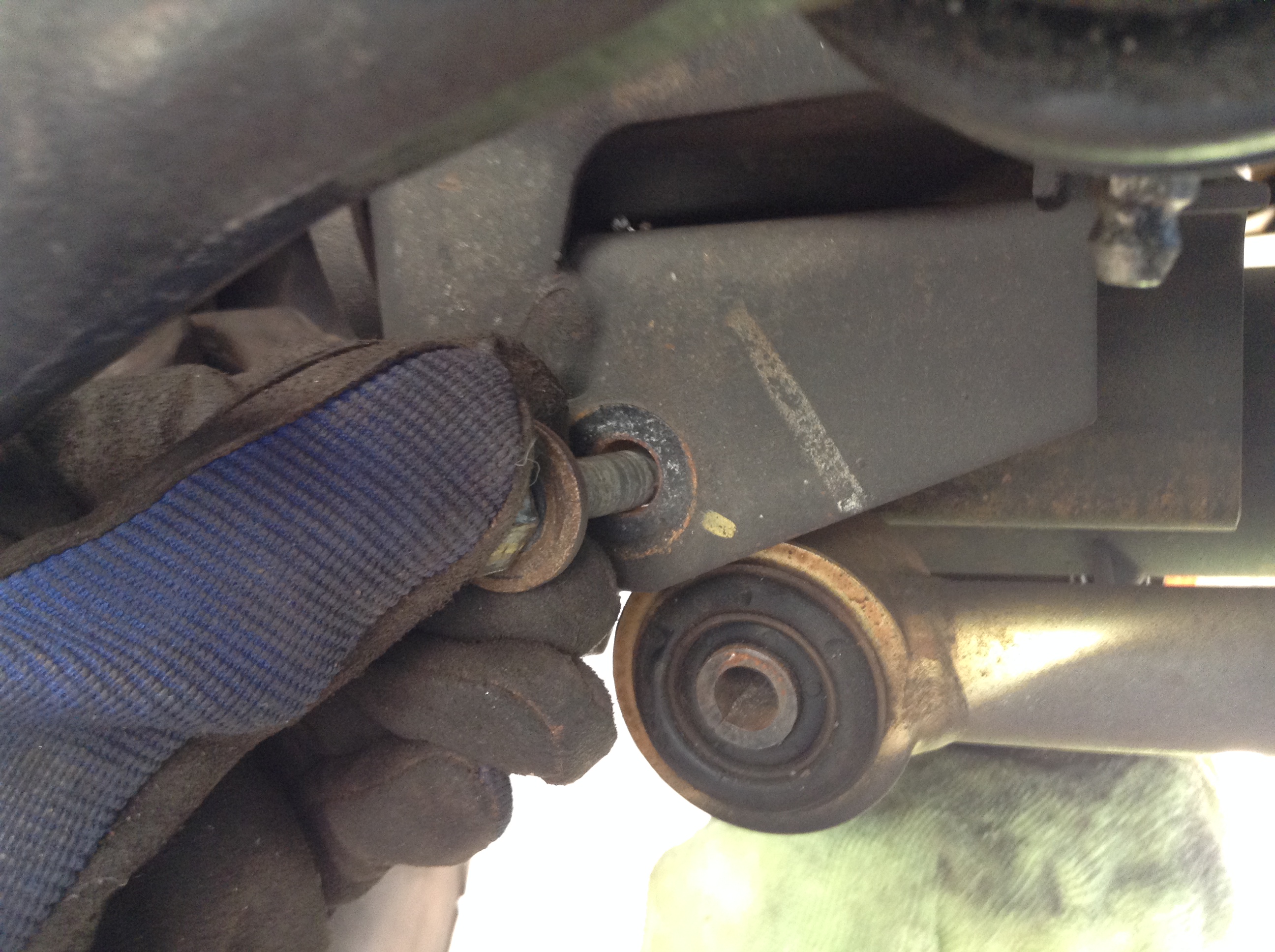

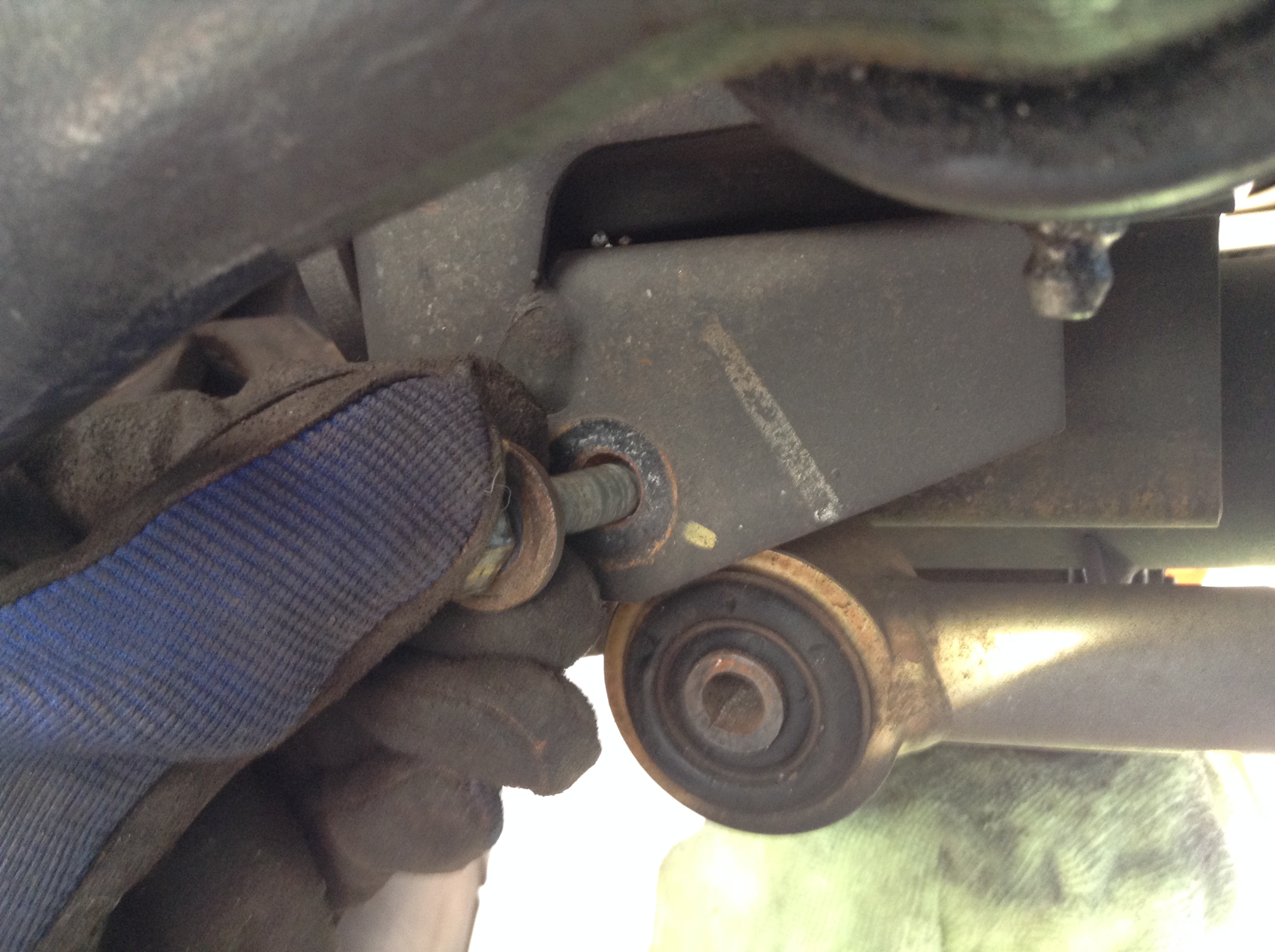

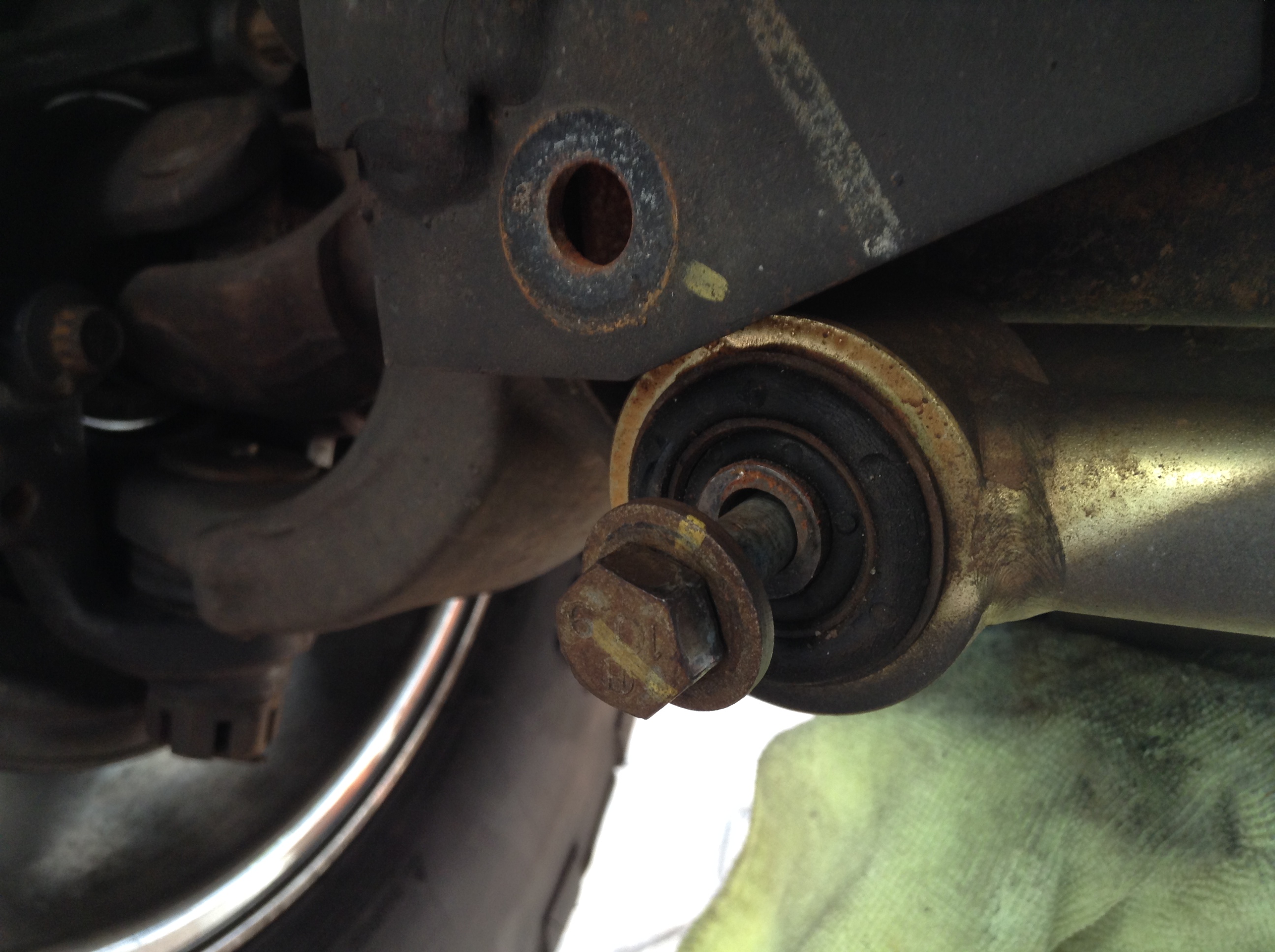

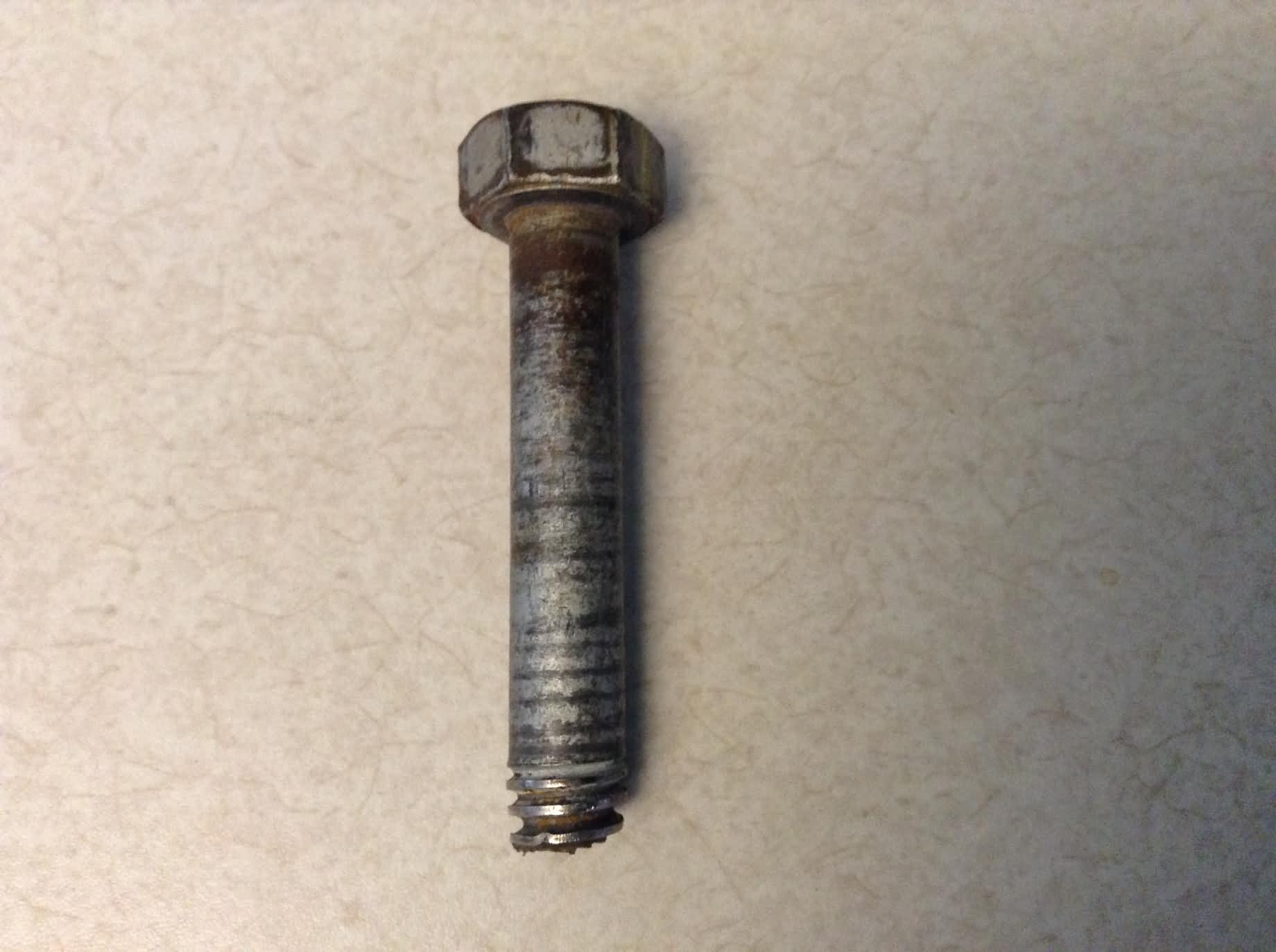

Does this look like too much play to you guys? The stock bolt seems to have plenty of wiggle room in the front trackbar bracket. I ask because I broke the bolt and had to order a new one.

Thanks for checking yours out. I think my TJ is different - it uses a 10mm bolt (with a hardness / grade of 10.9) from the factory. I heard that the later TJs switched over to metric bolts for the trackbar. It's a strange bolt though, because the threads are larger than the shaft.

I got it put back together using a standard 10mm bolt (instead of the factory thinner version) - the fit was much better! A standard bolt with the slightly larger shoulder filled the hole and had much less play.

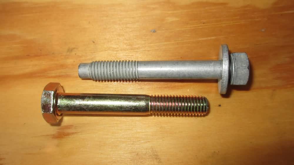

I ended up getting a new 10mm from Fastenal (they had to order it). It is similar to the stock bolt (I bought one of those to compare), except that it has a larger shoulder.
Here are the two bolts - the silver is the stock Jeep bold with threads larger than the body, and the gold is a normal 10mm bolt.
