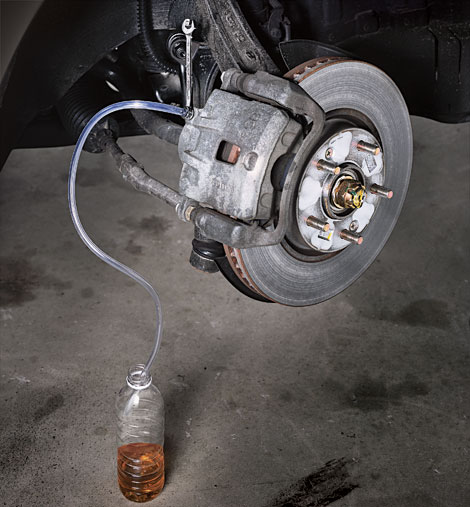

To bleed your brakes, start in the back of the Jeep. Pump your brakes about 15 times, until the pedal gets firm (this is a job for your girlfriend, because you'll be working on the brakes at the back of the jeep). While she has the brake down firm, put your closed end wrench on the bleeder valve, then slip a piece of clear tube over the bleeder valve. Make sure to use the right size wrench, as those guys are easy to round off.
Open the valve - fluid will shoot out (hopefully into the tube), and her foot will hit the floor. Close the valve (this will suck fluid out of the master cylinder and into the lines), have her pump the pedal, hold to the floor, then open the valve. do this about 10 times, then top off the master cylinder. The idea is the flush all the fluid out of the lines, and get good new fluid in them, the whole time not letting any air back in (hence the tube). You'll have to do this probably 10 to 20 times per wheel, and it will take time, but it's not hard.

Also make sure that you dont get the fluid squirted in your eye. not saying it happened to me from my personal experience, im not mentioning names (cough)me. Bleed the brakes starting from the calipers closest to the Master Cylinder to the Farthest.

I've always started with the caliper farthest from the M/C, RR, LR, FR, FL.
Also- after bench bleeding, it is possible, with the right help, to open a bleeder, press the brake pedal down & hold, Close the bleeder and release the pedal, this step is repeated several times and sends a true stream out each time the pedal is pressed. Pumping the pedal and holding prior to opening works though. I have gotten brake fluid in my eyes, and flushed them quickly, it gets the red out.

I've always done rear brakes first as well. Now that doesn't mean that I've been doing it right though...
I've rounded off and broke my share of bleeder valves, and in my younger days I would save money by re-using brake fluid :rolleyes:
But in all seriousness, what's the theory in starting from the front? Is it just easier to push the air though the shorter lines, instead of starting with the longest?
I have always started with the farthest from the m/c and worked my way closer also. Another method I have used after bench bleeding the m/c is "gravity bleeding", open the bleeder valves and don't push the pedal, just let them drip for a while. Then close all bleeders and pressure bleed.
