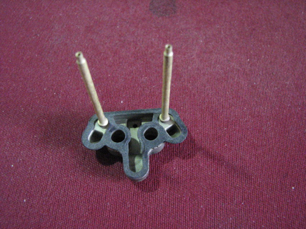

This same thing happened to my 85 CJ7. It turned out the idle jets (aka venturi) were clogged (I was running the original Carter BBD). I eventually became an expert at pulling the idle jets out, running some guitar wire through them, hitting them with carb cleaner and reassembling.
The tubes in this photo are what I mean

How do I pull out the idle jets?
