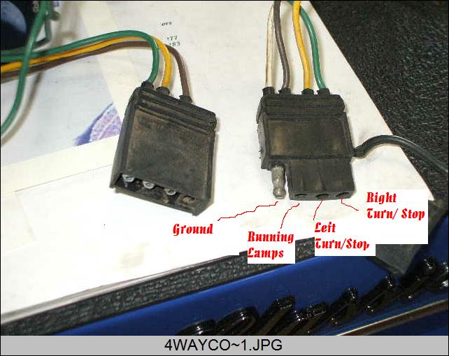

I did some searching and they don't make a plug and play for the 1990 jeep, as usual. I found a universal 4 pin wiring harness online. I guess Ill go to fleet farm and look at them to see if they come with instructions on what to splice into. Does anyone have a diagram if they don't?
I recommend a Test light and a friend to help you with this. Ground the clip of the test lamp and probe the wires on each side of the tail Lamps . take note of the color and their respective functions. after you have found the Right Turn, Left Turn , Running Lamps your ready to wire it up to the 4way connector. i hope this helps.
Oh thats a great idea. Thanks for the suggestion. Now will the wires for both lights be on one side of the jeep or will I need to go to each side to pickup the right and left taillight wires?
If you locate the Harness for the rear lamps where it splits to both sides then you can just splice in from there.
I found the Service Manual for your jeep, unfortunately the schematic diagrams are in black and white and no color coding on them.sorry i cant help you locate the wires by color. the test lamp will be your best friend at this point.
