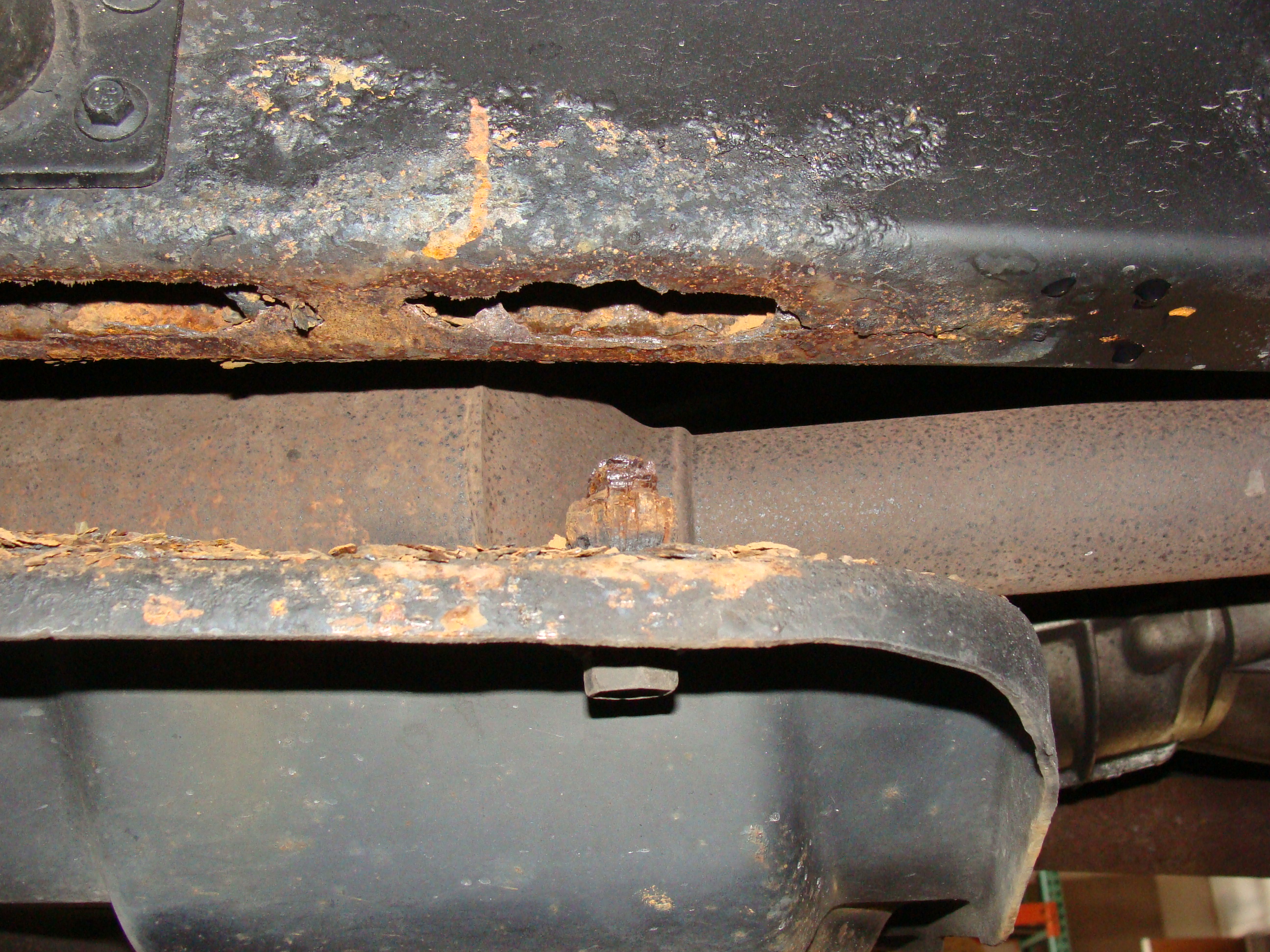

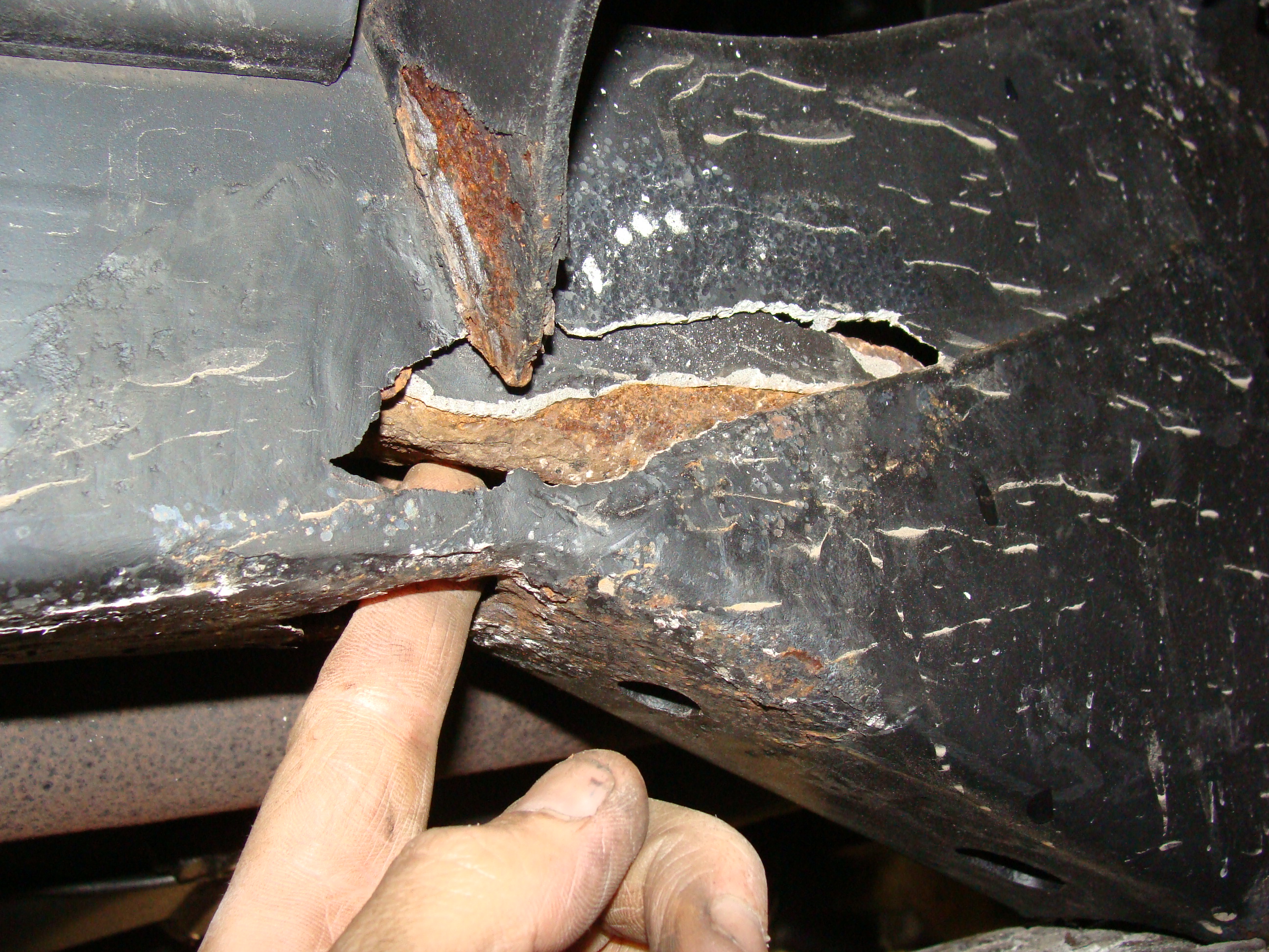

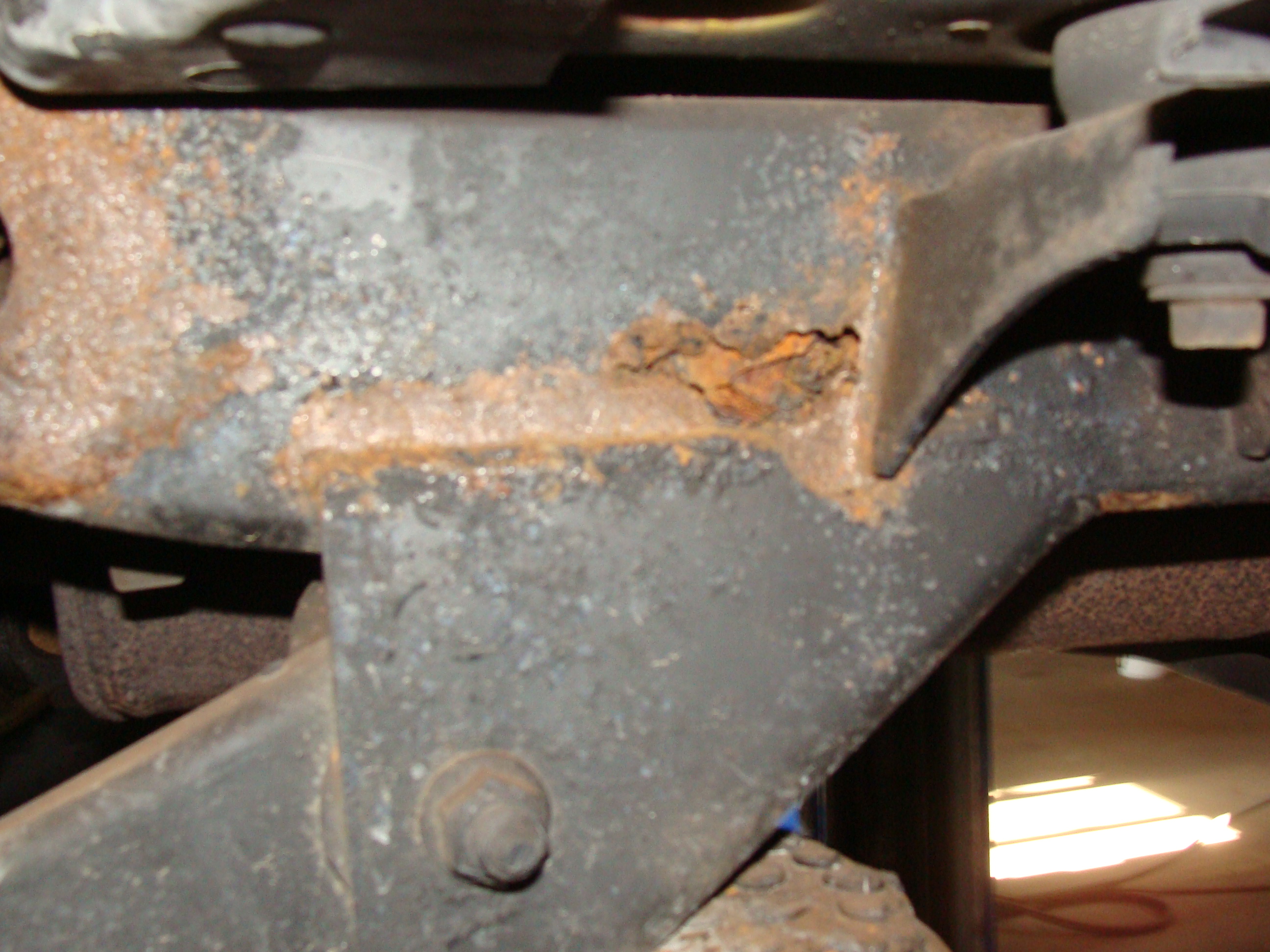

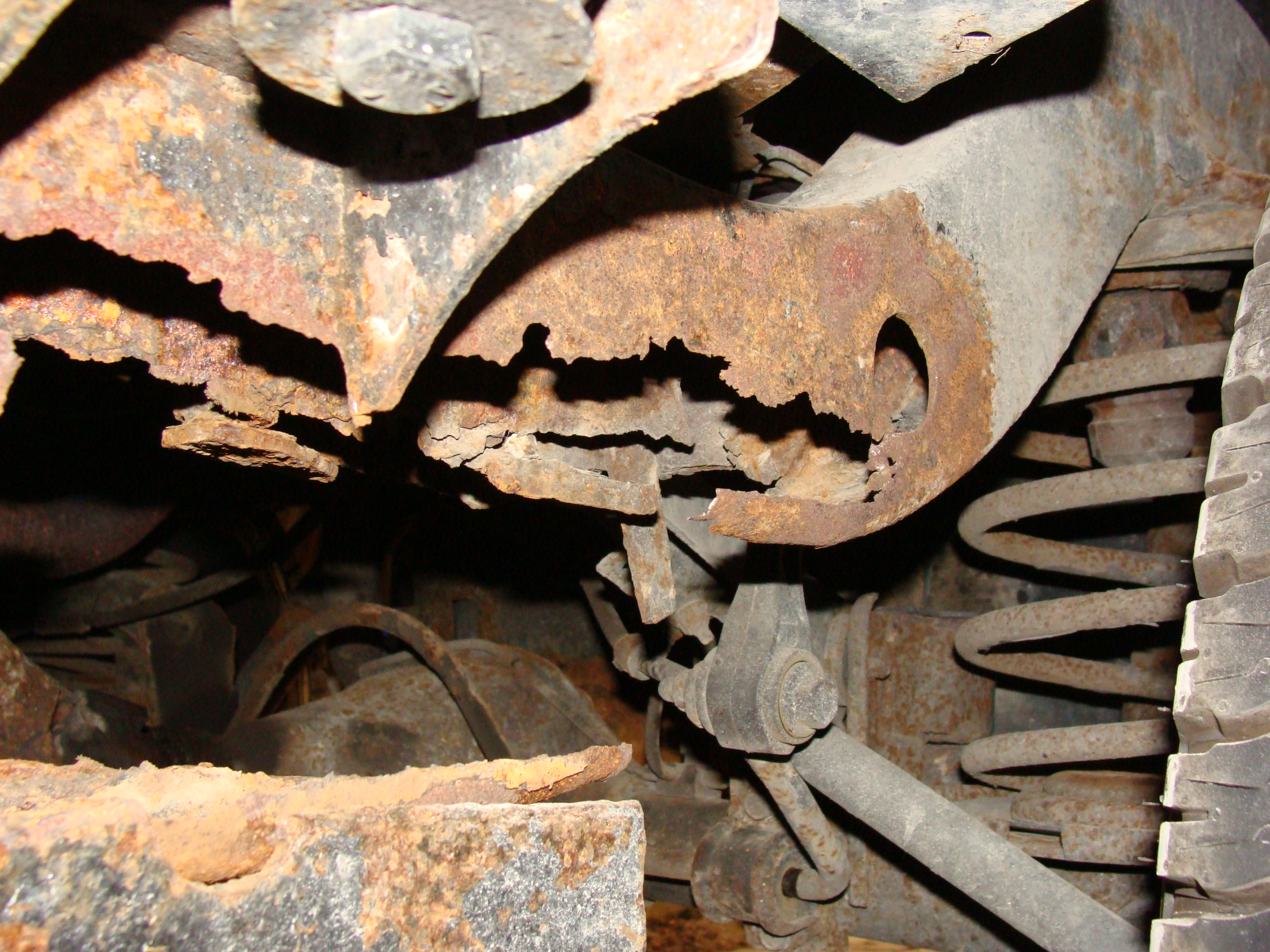

2000 Jeep Wrangler (Severe Mid-Lower Frame Rot)

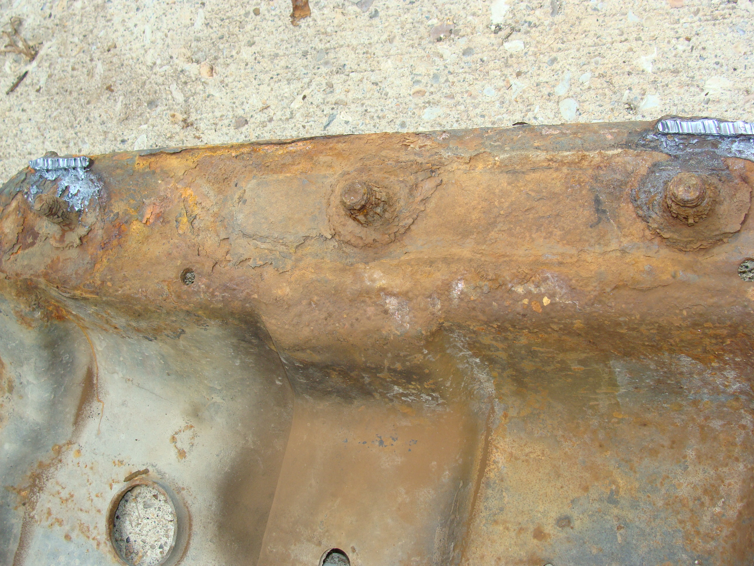

Notice the cut welds where the skid plate was welded to the frame... That is a typical sign that the Frame "Rivet Nuts" either started coming loose or had previously ripped out of the frame, and was an attempt to temporarily fix the problem.

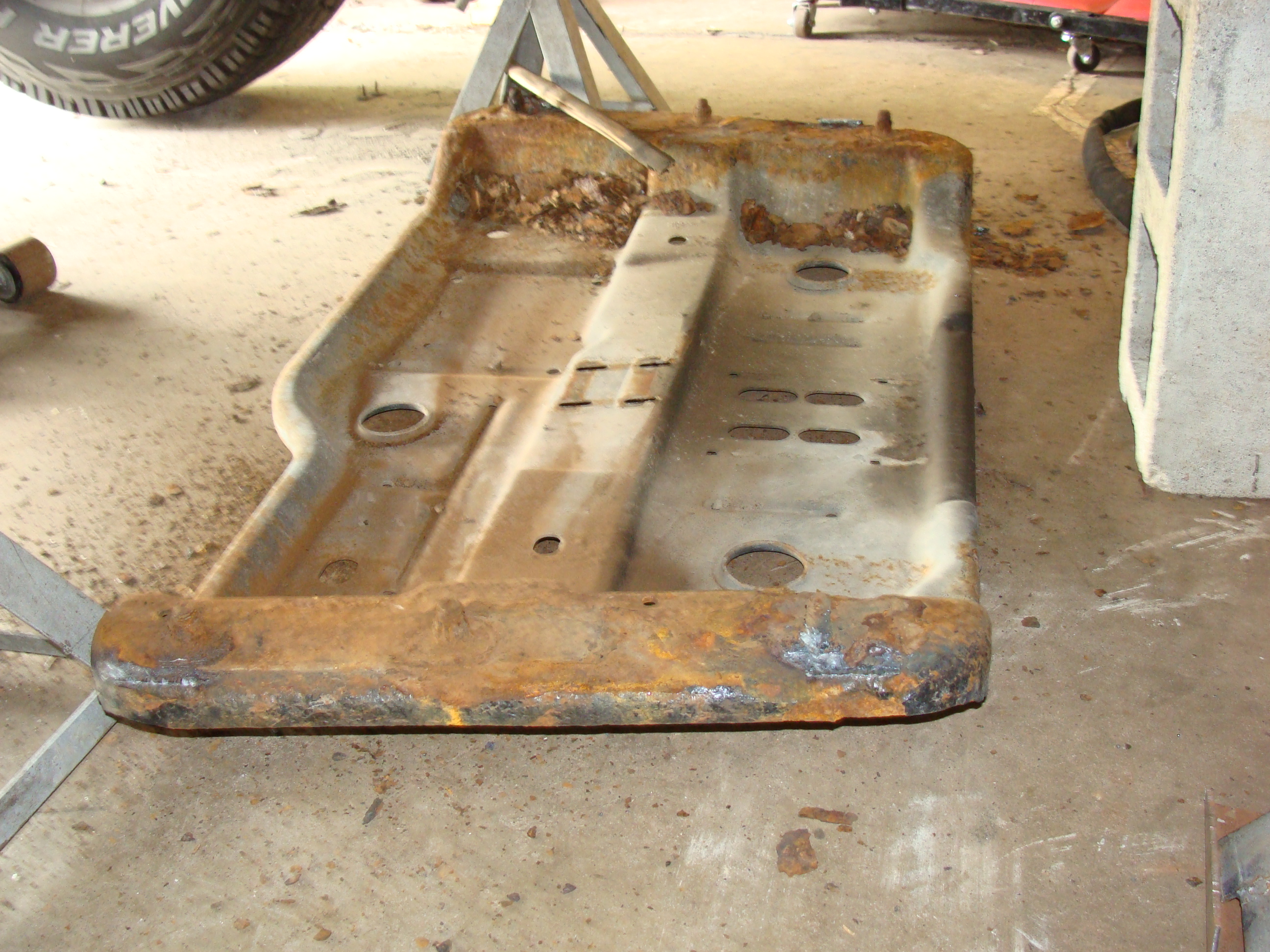

The customer also requested that the skid-plate be restored as well. In this pic, the old bolts/rivet nuts were removed, and the plate had been blasted & acid-etched (phosphatized)
Fitting up the coated skid-plate to the rebuilt frame

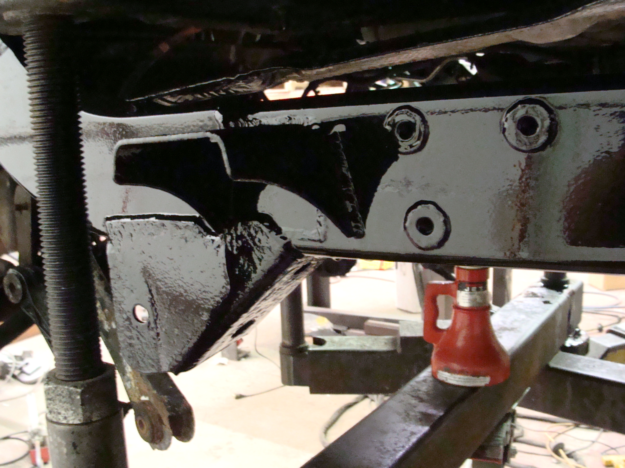

Completed (and Acid-etched) frame ready for coating

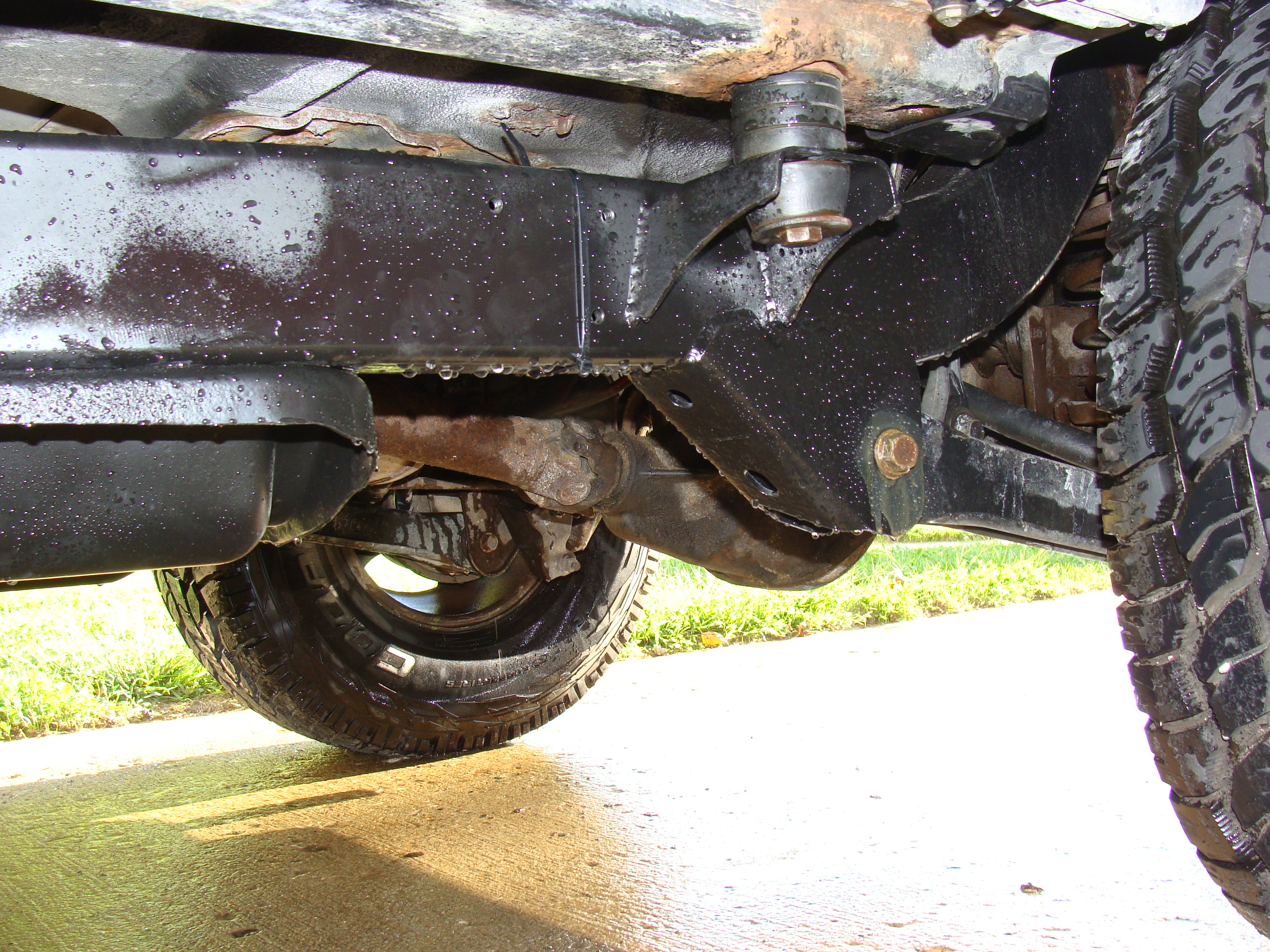

Jeep reassembled with Frame & Skid Plate Rustproofed

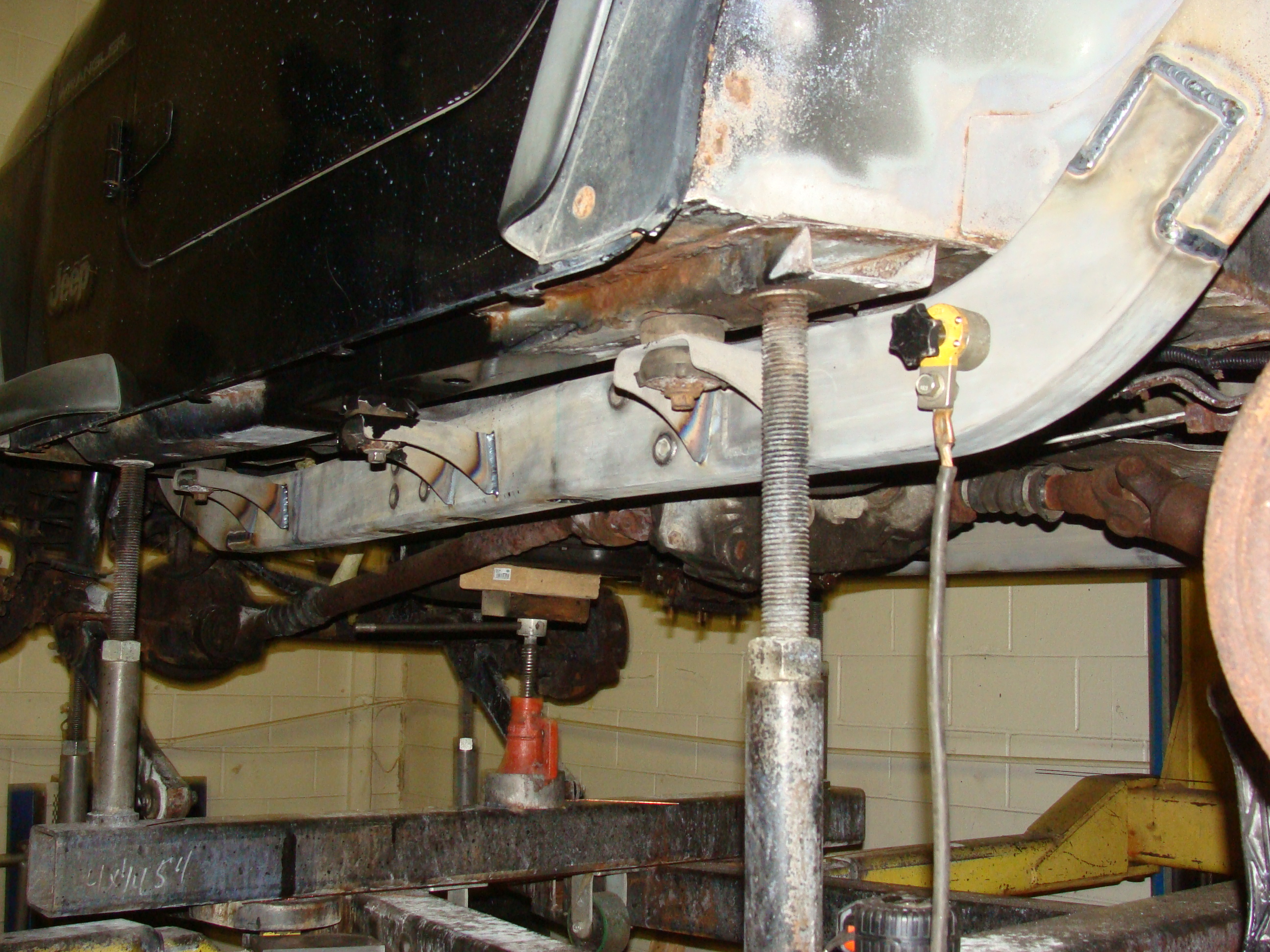

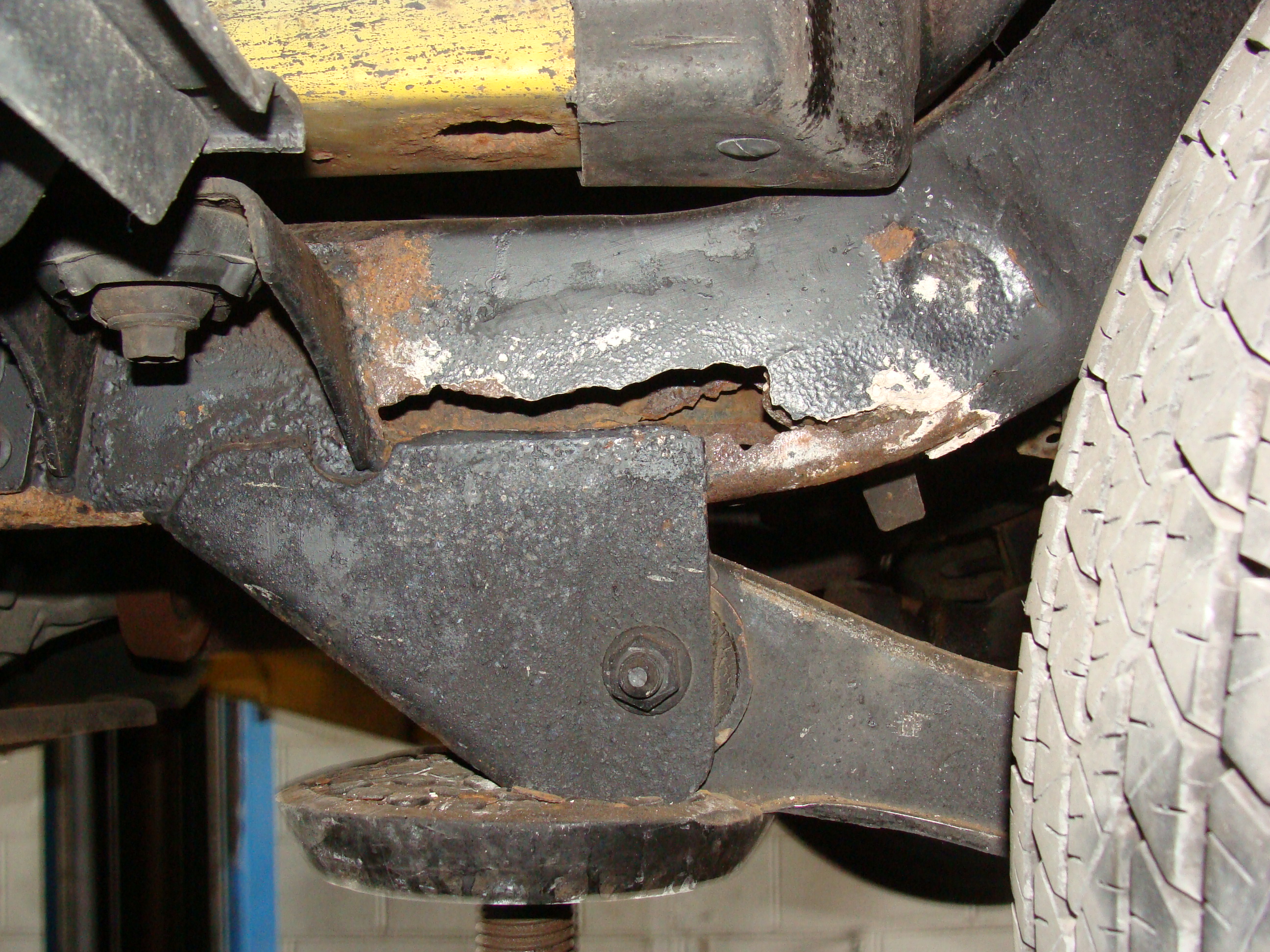

1999 Jeep Wrangler (Moderate Mid-Lower Frame Rot)

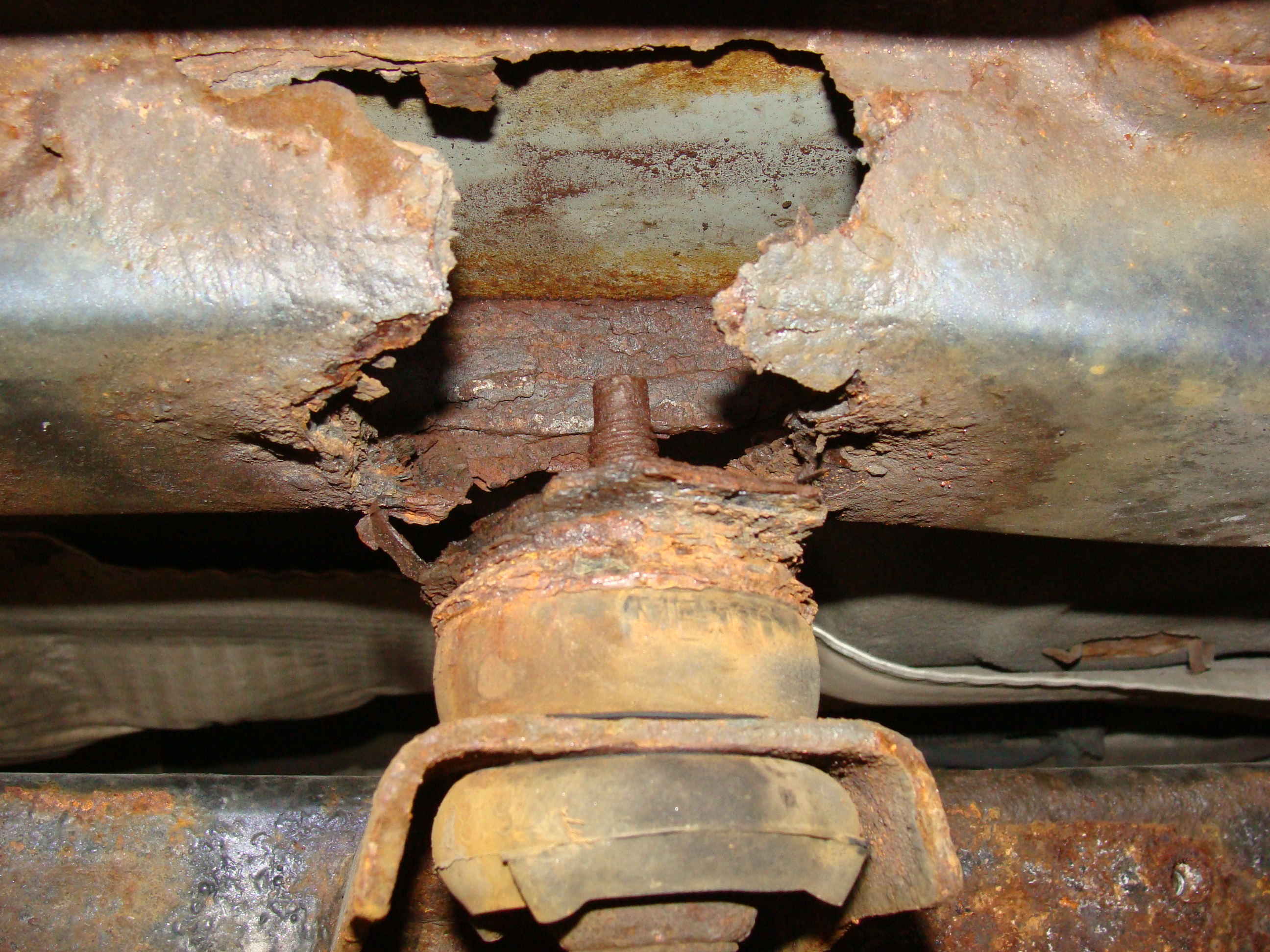

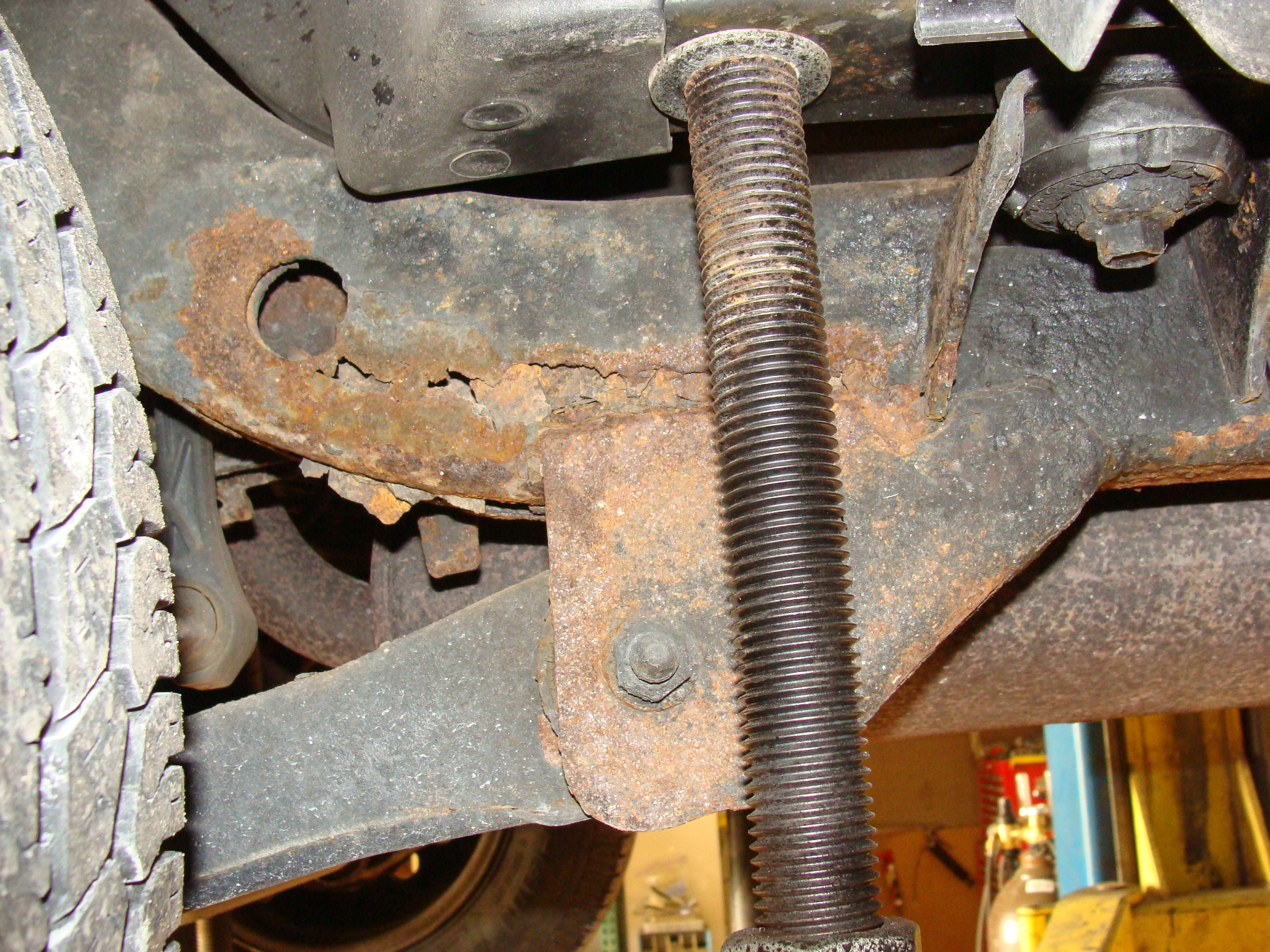

Body Rail Rot (Middle Mount)

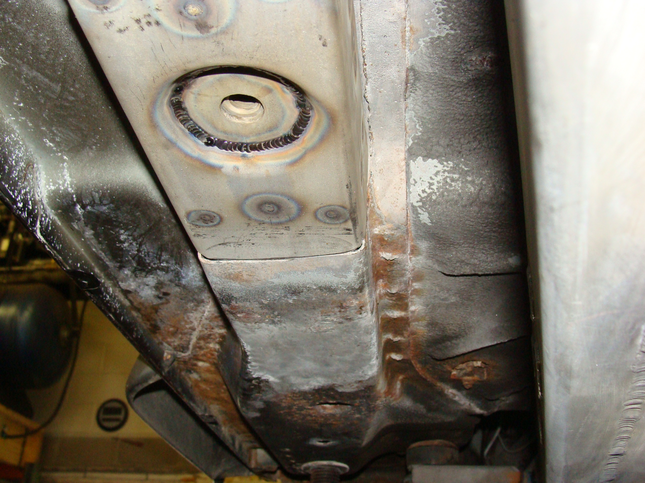

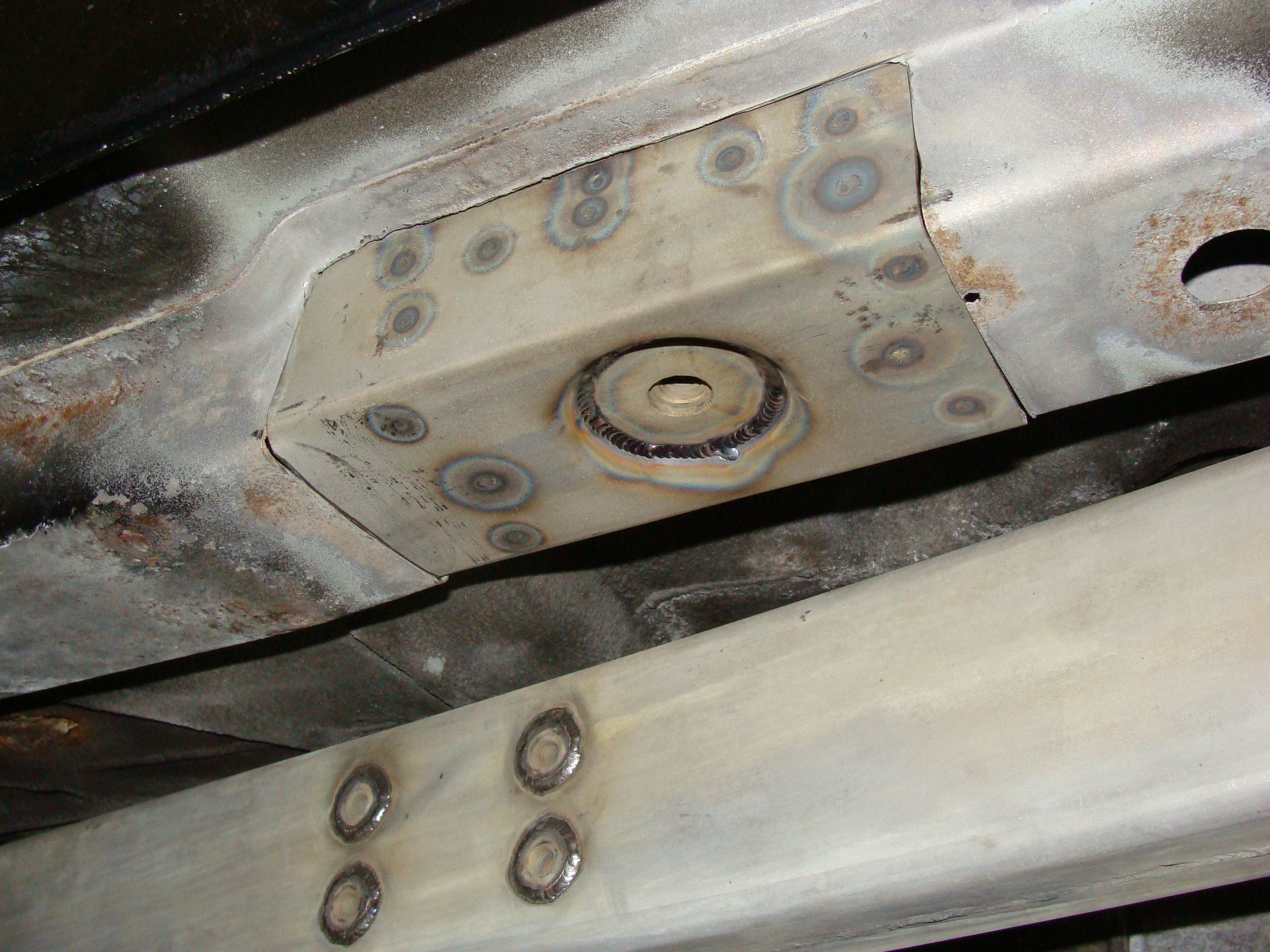

C-Notched Fit-up of "old" to "new" sections

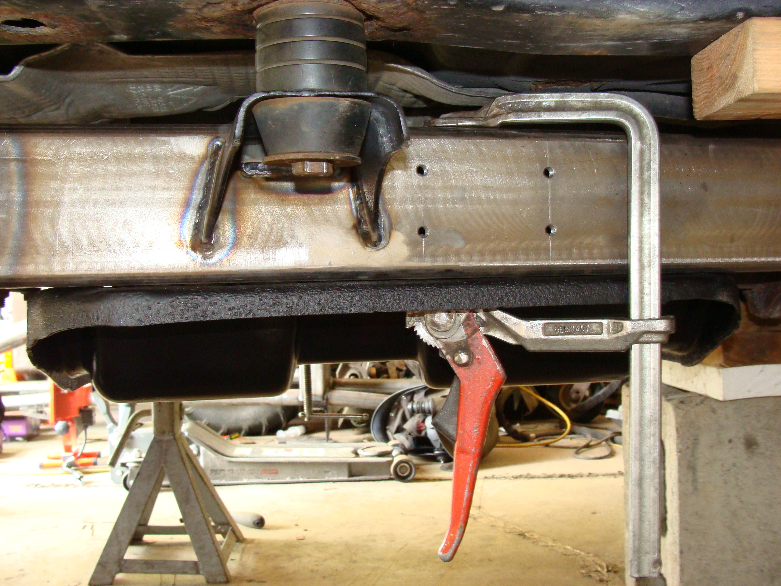

Replacement frame section welded into place
Rebuilt "body-rail mount" fit-up & ready to be welded into place
Rebuilt "body-rail mount" rustproofed

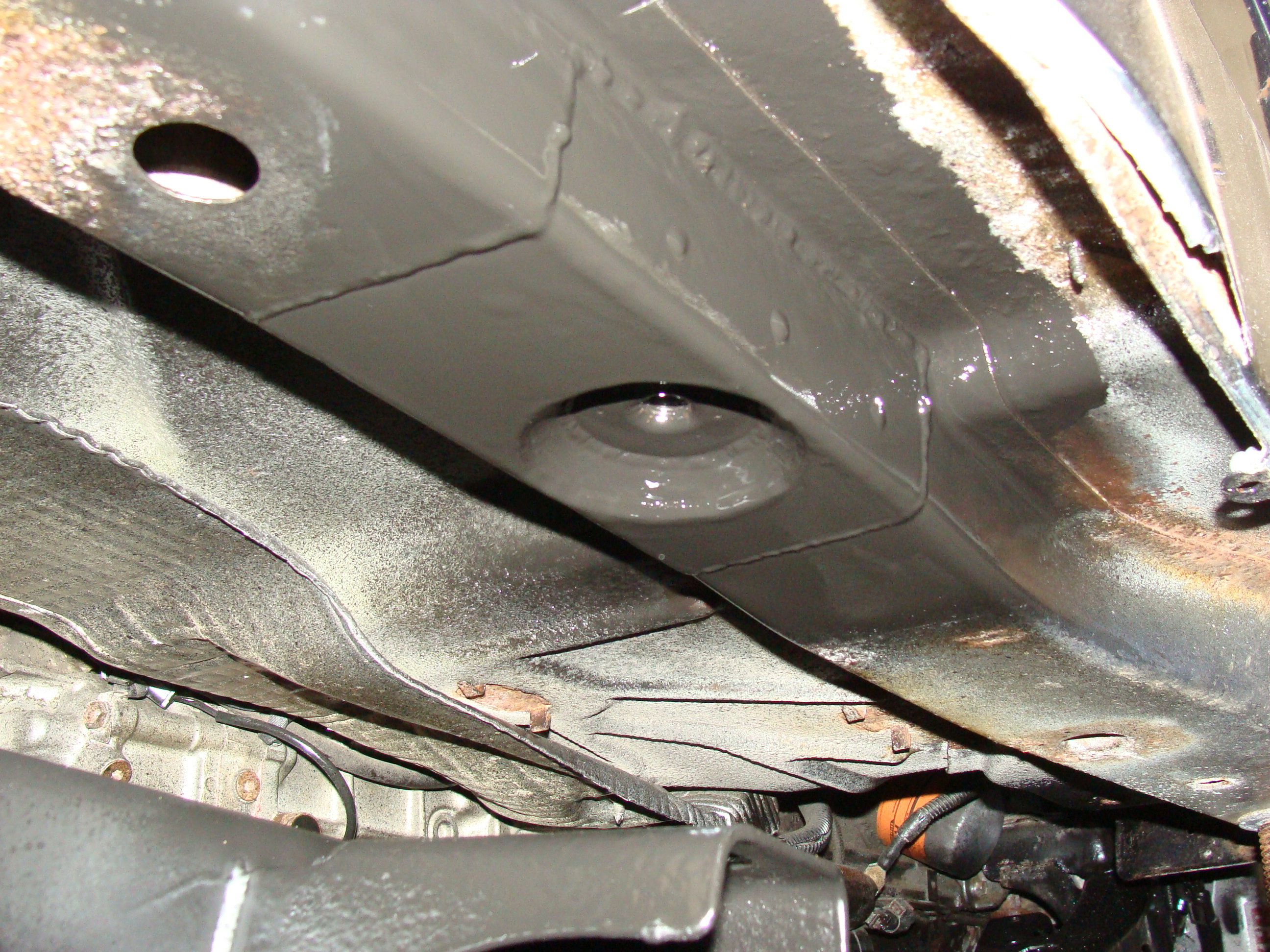

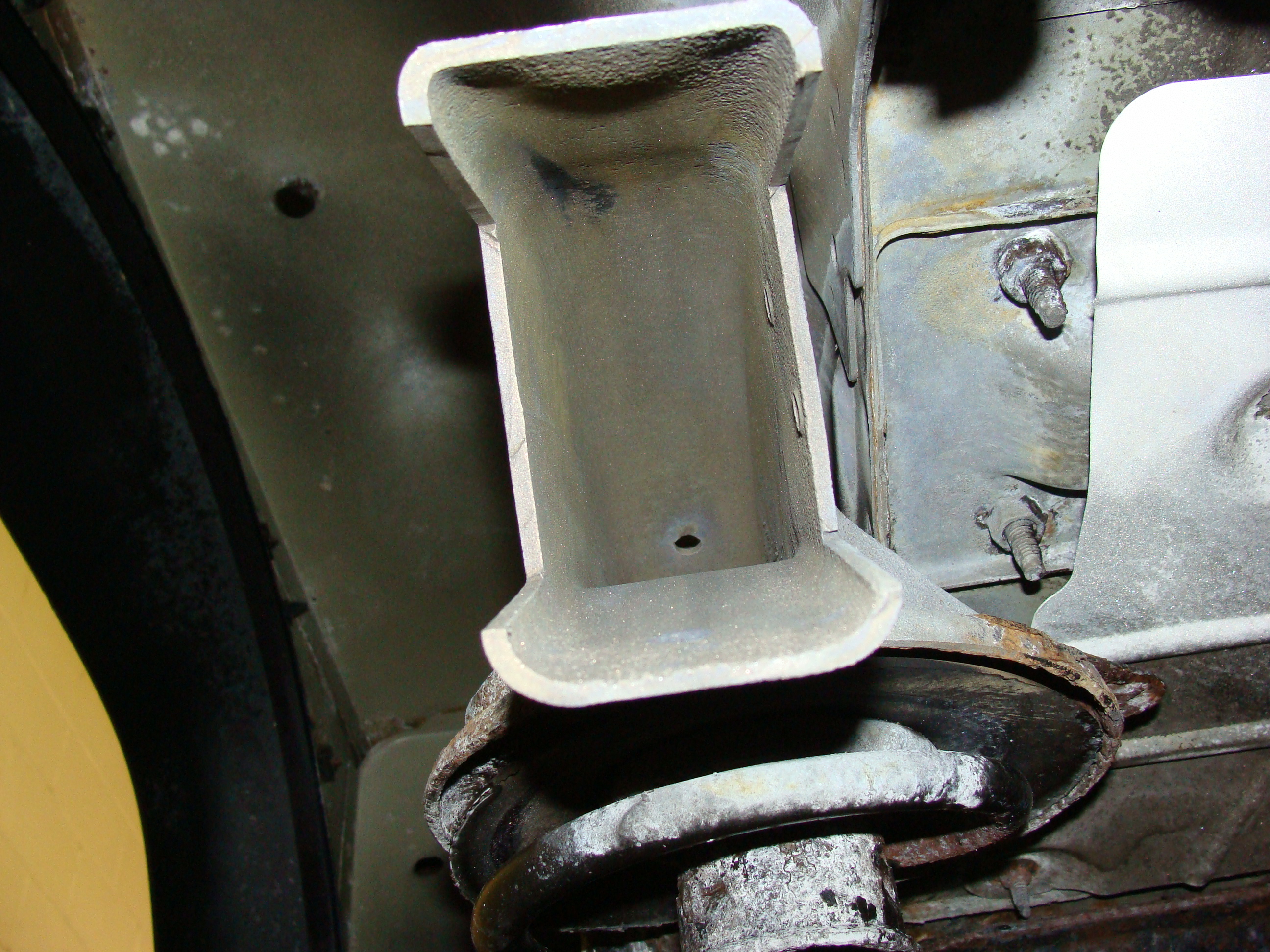

1 of 4 Added Frame Drain Holes (1 shown in "front" Lower Trailing Arm Mount Bracket)

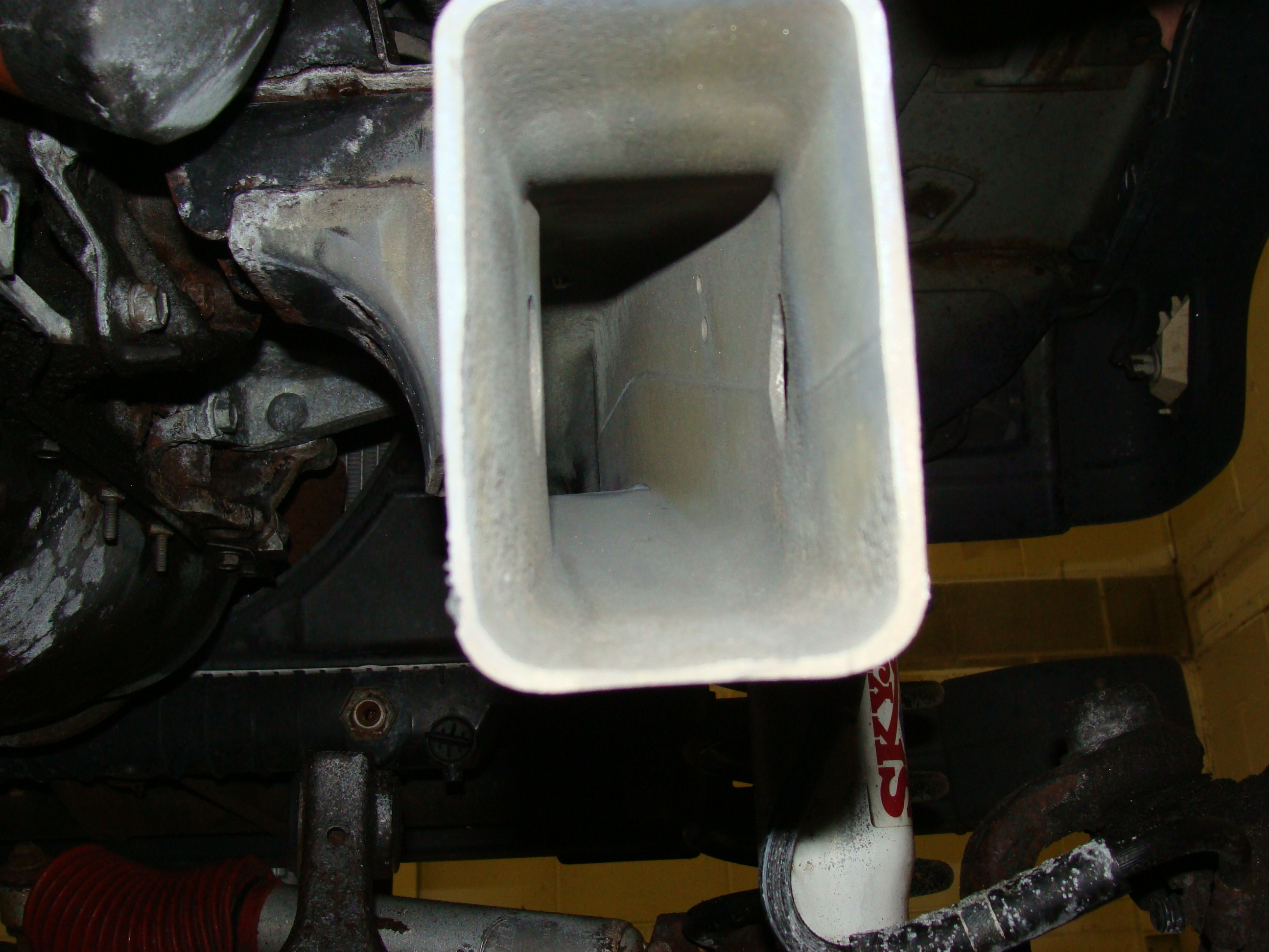

Replacement frame section freshly coated (inside & out)

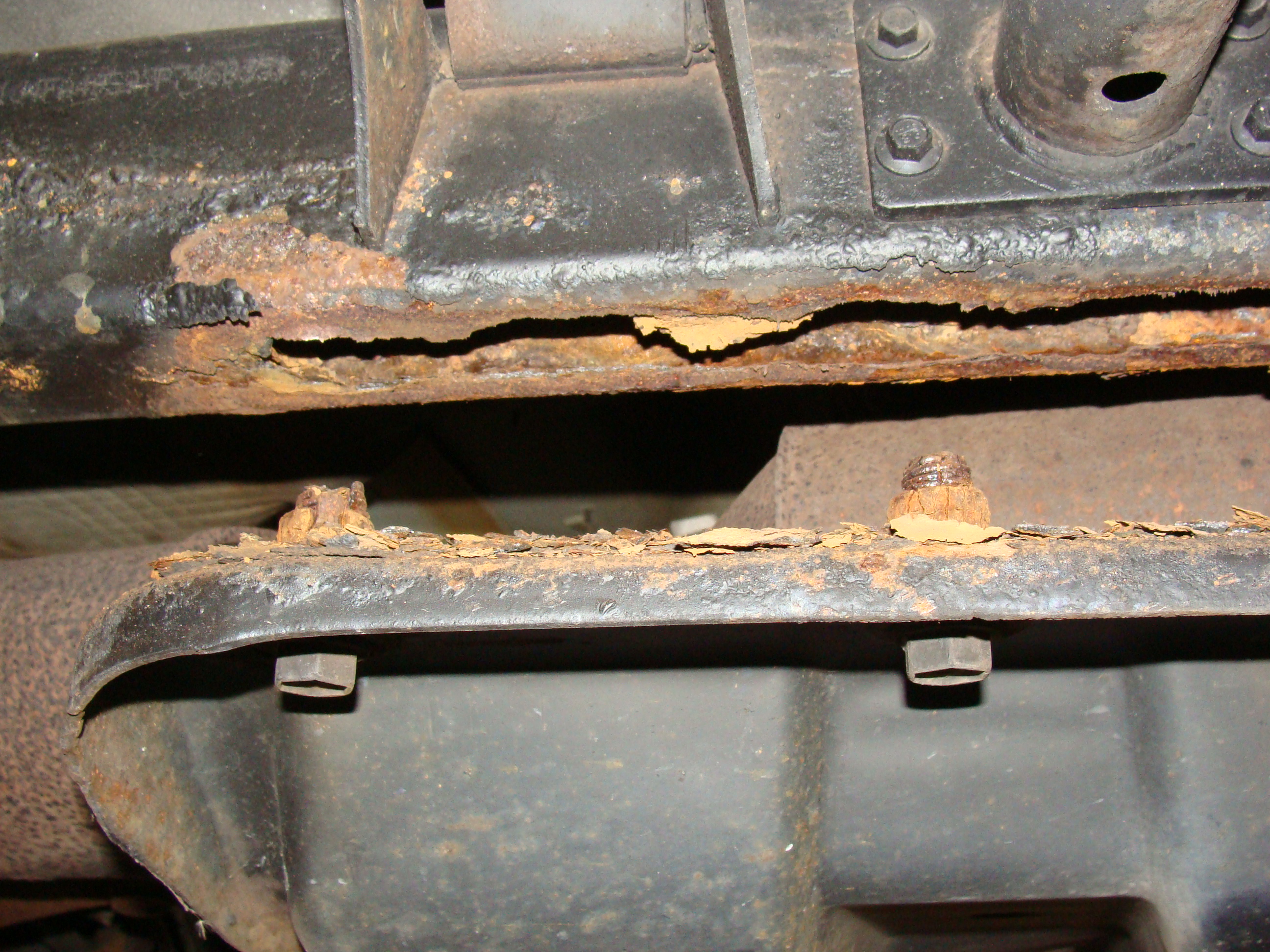

The pics below are of the consultation (explained above) that had body filler applied to the frame to cover up the damage, and shows what some are willing to do to sell a vehicle.
-Pics 01 thru 03 are of a section that “appeared” to be structurally sound, but running a scaler (scale-removing air-tool) knocked the water-proof Bondo (body filler) out of its place in the frame.
-Pic 04 also appeared to be fully intact until that area was tested. Notice this large factory hole, as the next pic will show where body filler was applied over that hole on the other side…
-Pic 05 is a larger area that was completely covered with bondo, and still has certain areas that are filling the inside of the frame. Notice the factory hole that is covered up… The uneven surface under the coating was a clear sign that the frame was covered up with a non-metal substance prior to coating.

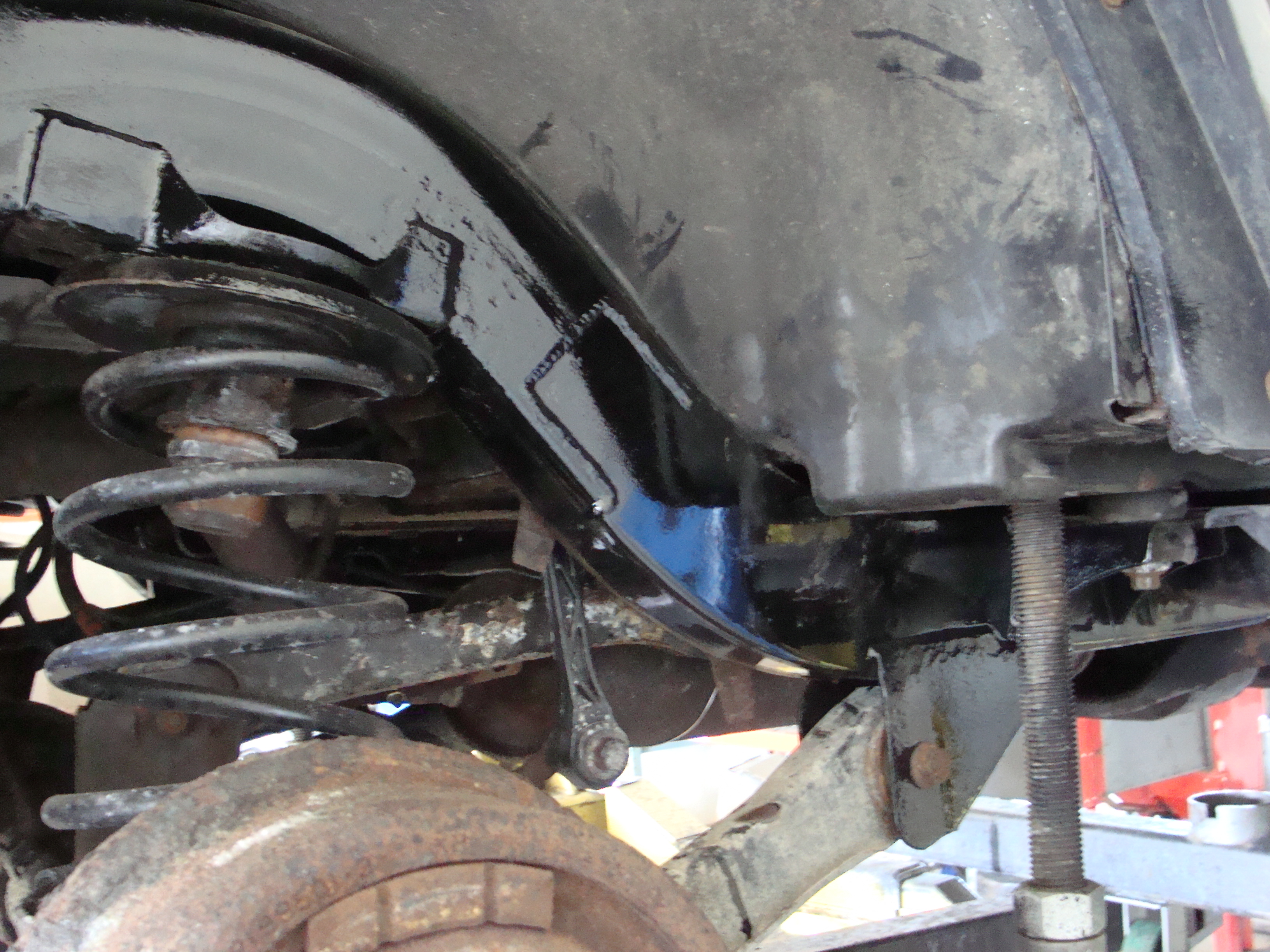

-Pics 06 thru 08 are what happened when the skid plate dropped down. Notice the rusted (splintered) skid-plate rivet nuts are still attached to the bolts… That area looked relatively solid at a glance "before failure".

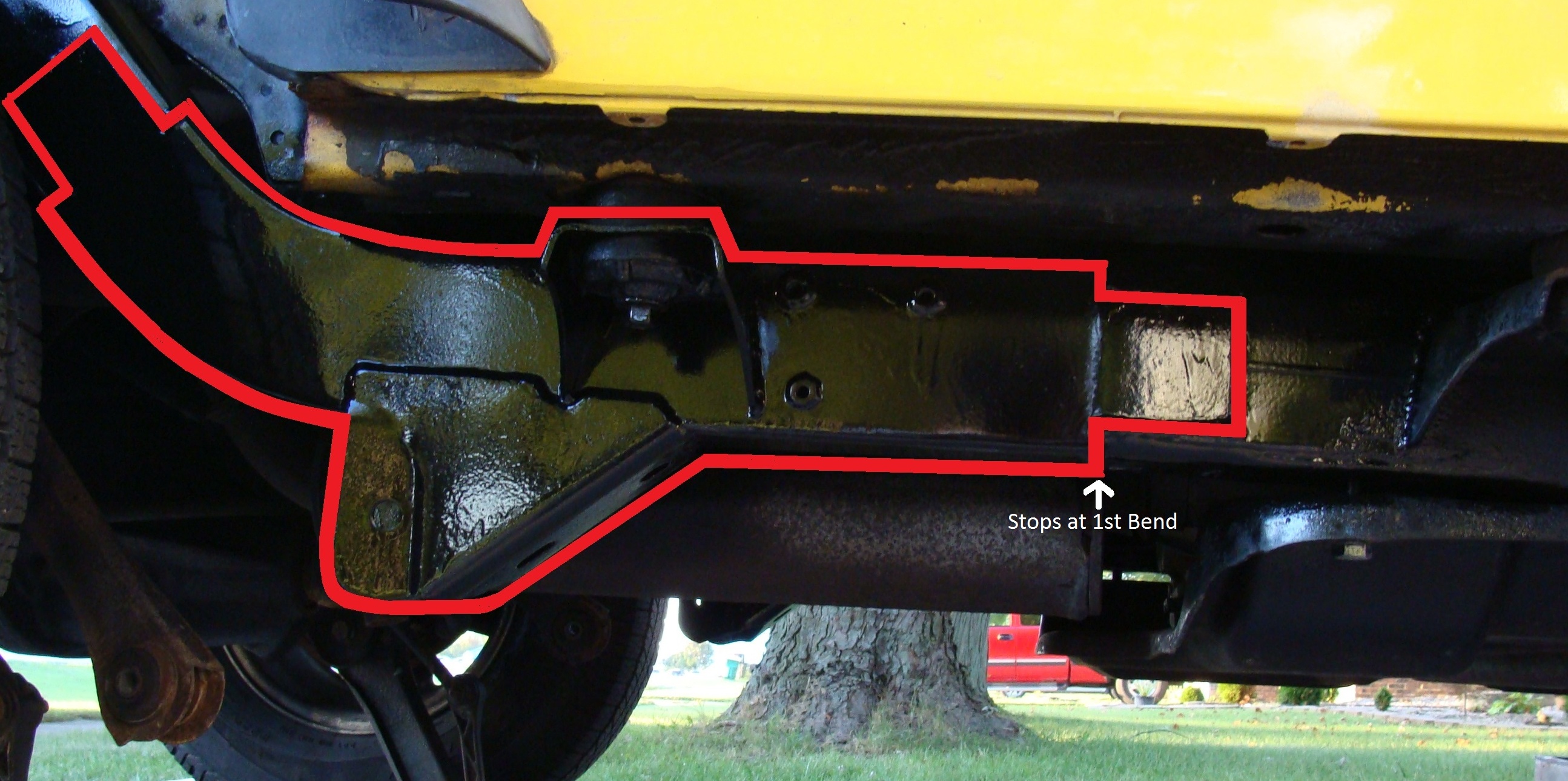

For a Jeep frame which has just the rear lower bends (of the center rail section) extending to the 1st rear bend rotted, the price would be roughly $900/side. The remaining (factory) ends "MUST" be structurally sound for that limited section to be installed.
[Note: That price would also assume the factory brackets are still in tact & structurally sound, as they would typically be restored and reattached. Otherwise, aftermarket brackets can be used instead, but would be at an extra cost (assuming they weren't supplied by the customer].
...that repair is generally for the "few" Jeeps that were regularly parked on steep inclines.
