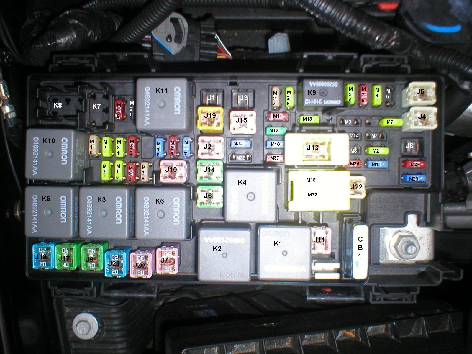

This is a repost to correct two minor cosmetic errors in the original thread. (I don't have edit permission on the original thread, so moderators, please delete the original thread so as to not clutter up the board... sorry for the hassle).
Since the fuse layout map on the inside cover of the fuse box is tough to read for those of us with older eyes, and since there have been several threads requesting such a diagram, I thought I'd go ahead and post this for whoever finds it useful.
See attached image below... if you click on it twice, you'll see the large version.
I've also included the fuse listing from the owner's manual for convenience.
If anyone sees any mistakes, let me know immediately and I'll fix it. Note that this is from my 2-door JK 2009... I don't know if there are any differences between the 2-door and the 4-door, nor if there were any changes between 2007 or 2008.
Cavity
Cartridge Fuse
Mini Fuse
Description
J1
40 Amp Green
Power Folding Seat
J2
30 Amp Pink
Transfer Case/Pwr Liftgate Module
J3
40 Amp Green
Rear Door Module (RR DOOR NODE)
J4
25 Amp Natural
Driver Door Node
J5
25 Amp Natural
Passenger Door Node
J6
40 Amp Green
Anti-Lock Brake System (ABS) Pump/ESP
J7
30 Amp Pink
Anti-Lock Brake System (ABS) Valve/ESP
J8
40 Amp Green
Power Memory Seat (If Equipped)
J9
40 Amp Green
PZEV Motor/Flex Fuel
J10
30 Amp Pink
Headlamp Wash Relay/Manual Tuning Valve
J11
30 Amp Pink
Sway Bar/THATCHAM Lock-Unlock/Power Sliding Door Module
J13
60 Amp Yellow
Ignition Off Draw (IOD) — Main
J14
40 Amp Green
EBL (Rear Window Defogger)
J15
30 Amp Pink
Rear Blower
J17
40 Amp Green
Starter Solenoid
J18
20 Amp Yellow
Powertrain Control Module (PCM) Trans Range
J19
60 Amp Yellow
Radiator Fan
J20
30 Amp Pink
Front Wiper LO/HI
J21
20 Amp Yellow
Front/Rear Washer
J22
25 Amp Natural
Sunroof Module
M1
15 Amp Blue
Center High Mounted Stop Light (CHMSL)/Brake Switch
M2
20 Amp Yellow
Trailer Lighting
M3
20 Amp Yellow
Frt/Rear Axle Lockers
M4
10 Amp Red
Trailer Tow
M5
25 Amp Natural
Inverter
M6
20 Amp Yellow
Power Outlet #1/Rain Sensor
M7
20 Amp Yellow
Power Outlet #2 (BATT/ACC SELECT)
M8
20 Amp Yellow
Front Heated Seat
M9
20 Amp Yellow
Rear Heated Seat (If Equipped)
M10
20 Amp Yellow
Ignition Off Draw — Vehicle Entertainment System (IOD-VES), Satellite Digital Audio Receiver (SDARS), DVD, Hands Free Module (HFM), RADIO, Antenna (ANT), Universal Garage Door Opener (UGDO), Vanity Lamp (VANITY LP)
M11
10 Amp Red
(Ignition Off Draw) IOD-HVAC/ATC, MW SENSR, Underhood Lamp (UH LMP)
M12
30 Amp Green
Amplifier (AMP)
M13
20 Amp Yellow
Ignition Off Draw— Cabin Compartment Node (IOD-CCN), Wireless Control Module (WCM), SIREN, Clock Module (CLK MOD), Multi-Function Control Switch (MULTIFCTN SW)
M14
20 Amp Yellow
Trailer Tow (Export Only)
M15
20 Amp Yellow
COL MOD, IR SNS, Heater Ventilation, Air Conditioning/Automatic Temperature Control (HVAC/ATC), Rear View Mirror (RR VW MIR), Cabin Compartment Node (CCN), Transfer Case Switch (T-CASE SW), RUN/ST, Multi-Function Control Switch (MULTIFTCN SW), Tire Pressure Monitor (TPM), Glow Plug Module (GLW PLG MOD) — Export Diesel Only
M16
10 Amp Red
Occupant Restraint Controller/Occupant Classification Module (ORC/OCM)
M17
15 Amp Blue
Left Tail/License/Park Lamp (LT-TAIL/LIC/PRK LMP)
M18
15 Amp Blue
Right Tail/Park/Run Lamp (RT-TAIL/PRK/RUN LMP)
M19
25 Amp Natural
Auto Shut Down (ASD #1 and #2)
M20
15 Amp Blue
Cabin Compartment Node Interior Light (CCN INT LIGHT), Switch Bank (SW BANK), Steering Control Module (SCM)
M21
20 Amp Yellow
Auto Shut Down (ASD #3)
M22
10 Amp Red
Right Horn (RT HORN (HI/LOW)
M23
10 Amp Red
Left Horn (LT HORN (HI/LOW)
M24
25 Amp Natural
Rear Wiper (REAR WIPER)
M25
20 Amp Yellow
Fuel Pump (FUEL PUMP), Diesel Lift Pump (DSL LIFT PUMP) — Export Only
M26
10 Amp Red
Power Mirror Switch (PWR MIRR SW), Driver Window Switch (DRVR WIND SW)
M27
10 Amp Red
Ignition Switch (IGN SW), Window Module (WIN MOD)
M28
10 Amp Red
Next Generation Controller (NGC), Transmission Feed (TRANS FEED), J1962
M29
10 Amp Red
Occupant Classification Module (OCM)
M30
15 Amp Blue
Rear Wiper Module (RR WIPER MOD), Power Folding Mirror (PWR FOLD MIR)
M31
20 Amp Yellow
Back-Up Lamps (B/U LAMPS)
M32
10 Amp Red
Occupant Restraint Controller (ORC), TT EUROPE
M33
10 Amp Red
Next Generation Controller (NGC), Global Powertrain Engine Controller (GPEC)
M34
10 Amp Red
Park Assist (PRK ASST), Heater Ventilation, Air Conditioning Module (HVAC MOD), Headlamp Wash (HDLP WASH), Compass (COMPAS)
M35
10 Amp Red
Heated Mirrors
M36
20 Amp Yellow
Power Outlet #3 (BATT)
M37
10 Amp Red
Anti-Lock Brake System (ABS) , Electronic Stability Program (ESP), Stop Lamp Switch (STP LP SW), Fuel Pump Rly Hi Control
M38
25 Amp Natural
Lock/Unlock Motors (LOCK/UNLOCK MTRS)
