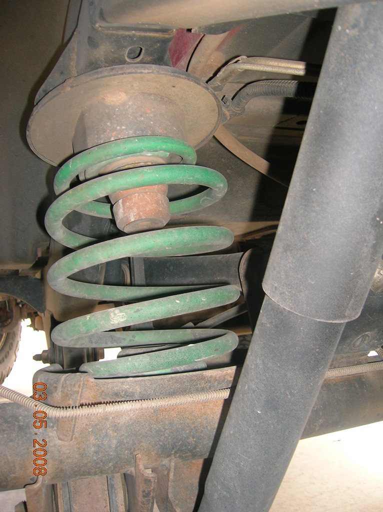

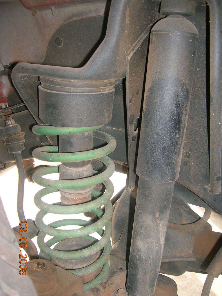

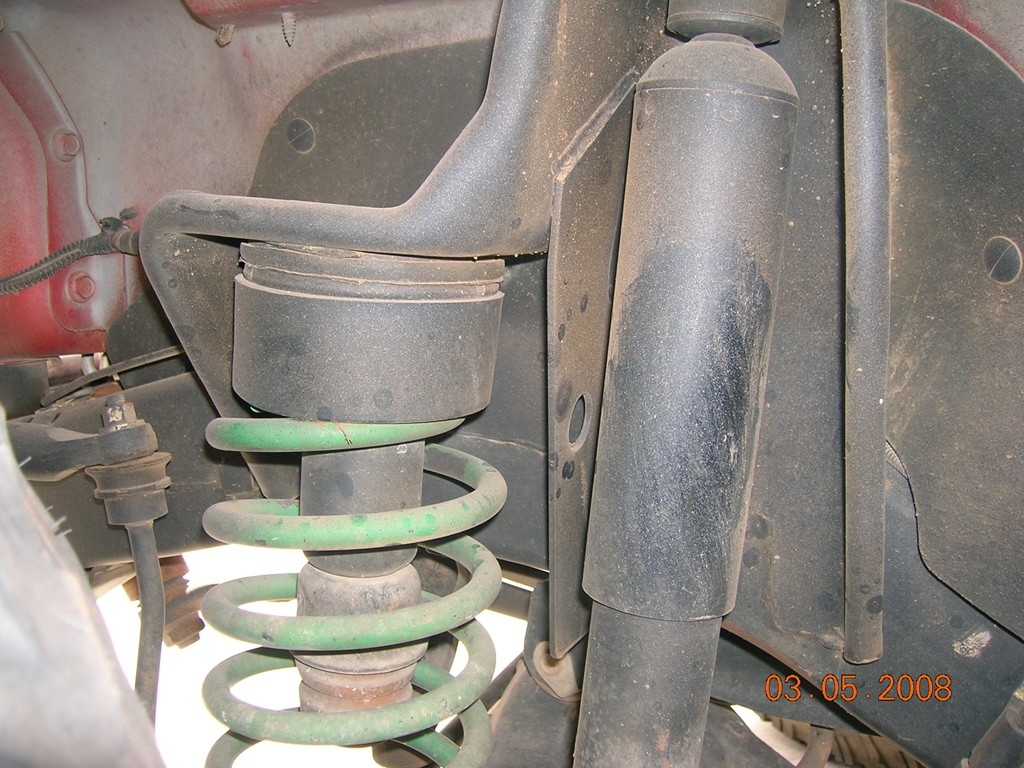

Your bumpstops are located in the middle of your coils. I had a 4" lift on my 99 tj with 33" tsl and it stuffed them in the fenders with no rubbing. You will have to do something with your shocks. If on a budget relocate the shock mounts if not on a budget get longer ones. Next time you go offroad disconnect the shocks and see if you get anymore travel. Just drive slow so you maintain control. And relocate the brake line mounts also so you dont rip them apart. You could always piece your lift together. There are companys that sell the springs seperate (or ebay). I installed stock front tj coils on the rear of my cj and had alot of travel. The coils are great for flexing. You also need to watch the lower control arms. They come in contact with the coil spring buckets if the suspension travels down too much. As for as your gears, regearing always helps but it depends on your driving style and terrain. Do you have the 4.0 or the 2.5 engine? Is it stick or auto transmission?

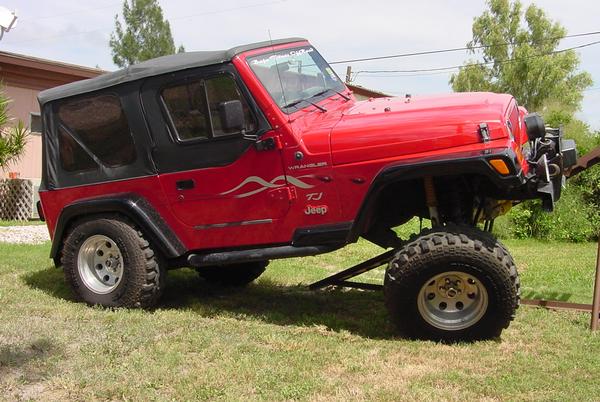

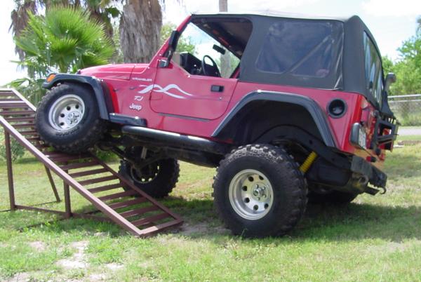

At the time when I lifted my 4" was the biggest they sold. I bought the superlift kit and it came with everything. I know that you can get coils from rubicon express. They sell them in pairs. If you piece yours together just get all the parts before starting. You will need the 4 coils, shocks, pitman arm, trackbar brackets, and possibly the spacers to lower your skidplate to reduce your rear driveshaft angle. They sell slipyoke eliminator kits for that, but some can be pricey. You are going to need to either lengthen your brakelines or relocate them so they dont stretch when flexed. You can get a basic 4" lift cheap these days. I think I have seen them for around $300-$400 range. That will save you from alot of headaches in the long run. You and a buddy can install this in a day or two with basic handtools. The little parts will nickle and dime you to death. Here is a pic of my 99 that I had.

What you did to your jeep is EXACTLY what I want to do with mine. I'm pretty uninformed when it comes to all the diy stuff but I'll be posting lots of questions when I get ready to do it. With your jeep, you only had a 4" lift and 33" tires and were able to flex that much?!?! That's ridiculous impressive, I'd like to be able to do the same, with some help from everyone haha.
