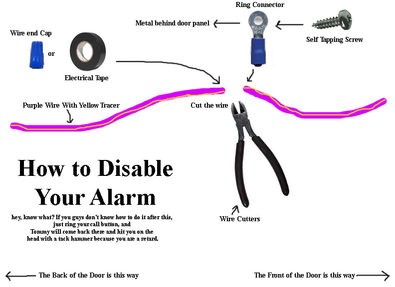

Just went through this with my 98 5.2 Zj. We took the easy way out and disabled the alarm. Keyless lock/unlock still works, the alarm just doesn't arm anymore. :shades:
My husband followed the directions in a post on another jeep forum. (thanks to Matt for the absolutely fabulous diagram.):lol:
first you need to take off your door panel
there are a total of 5 screws
then just pull the door panel off... all that is holding it on is clips... be sure to unhook any electrical connectors so that the door panel can come completely off
once inside, find the purple wire with a yellow tracer.. it will be in the bundle of wires
