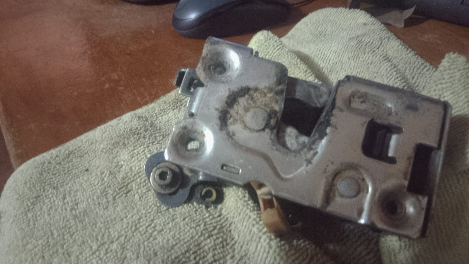

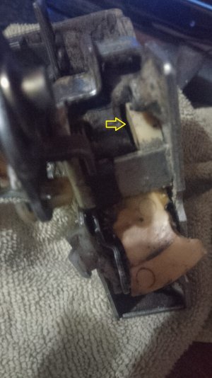

I got the door open with some help from a friend but when we got it open and was looking at it the latch went into full close and is stuck. We have tried many things soaked it cleaning and penetrating oil nothing works none of the rods are binding so I am getting a T30 to remove the latch.
What we think happened at this point is when I removed the inside levers for the door and lock and moved it forward to get the hooks at the back of the small panel out and then remove the rods as part of removing panel to install a new lock that moving these things pulling on them something snapped or jammed in the latch, it is original equipment from 87 so I am going to remove it and see what I find.
