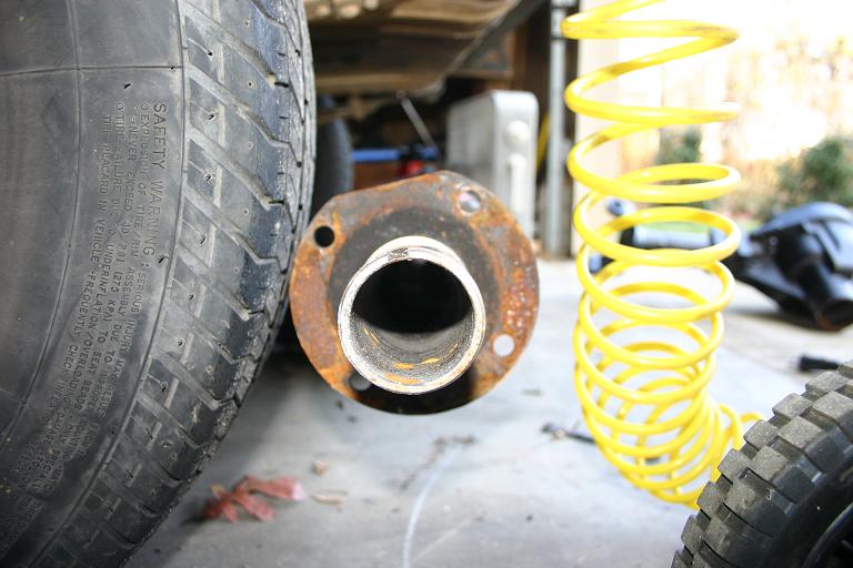

my winter build is finally done. im on 38's, with a 44 frotn and 60 rear. the 60 is 35 spline adn the 44 will be all alloy shafts and joints in about a month, right now the inners are spicer. its got 5.13 gears with hummer dual beadlocks, soon to have a e350 master cylinder that will lock up the 38s and it has lock rites front and rear. the rear will get swapped for a spool in about a year.

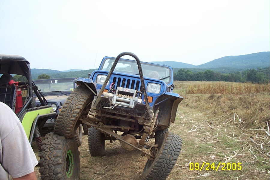

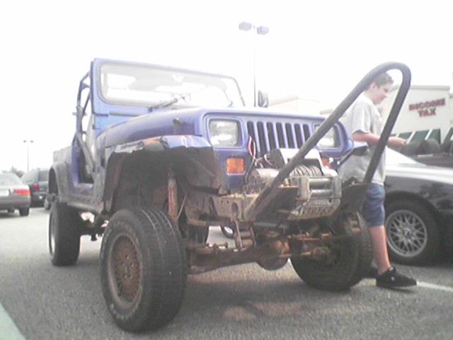

(the pic on the trailer doesnt do it justice, it was chained down really tight, its stance is jsut bad@$$ now)

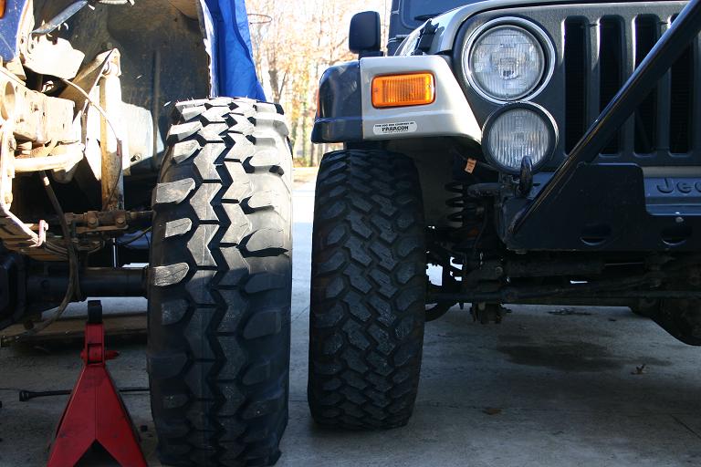

mounted on the jeep with 5 psi next to 33's (oh and thats a 3 ton jackstand under my axle for height reference)

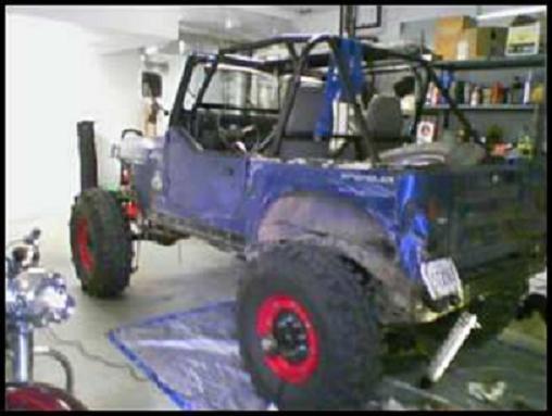

the only one i have of it fully done was off my phone

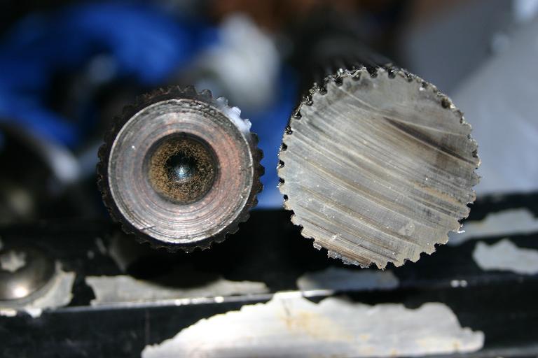

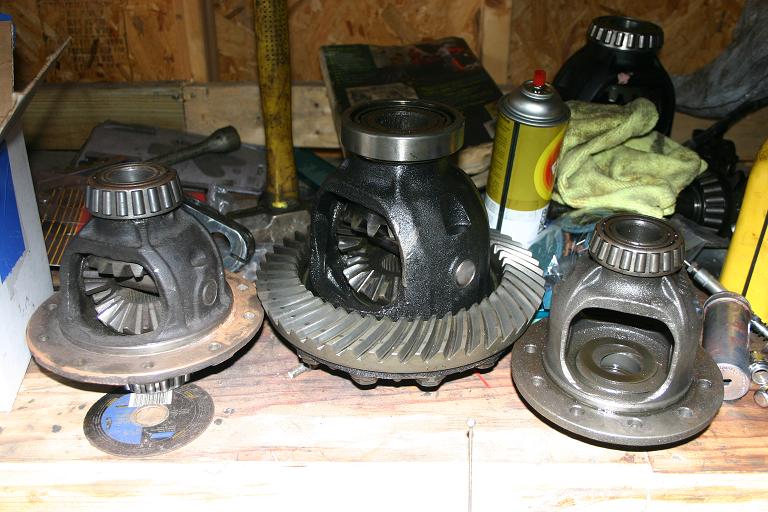

60 35 spl vs d44 30 spl
44, 60, 30 carriers

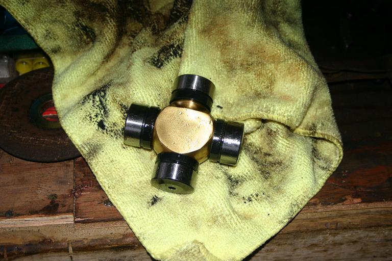

yukon alloy joints

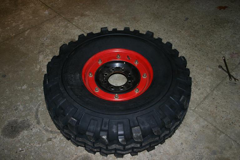

tires on rims

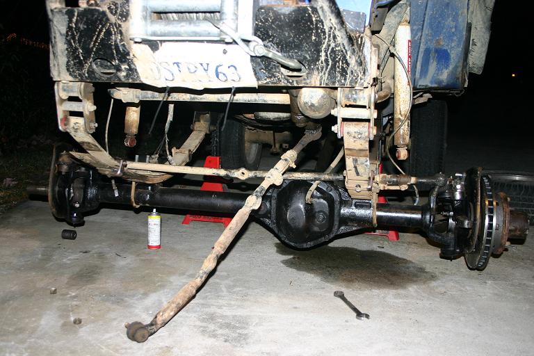

front axle hung

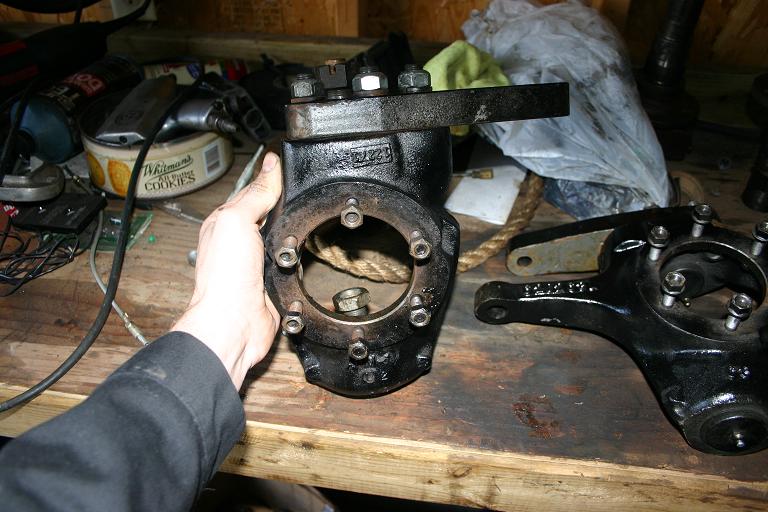

flat tops with hi steer
Does your tierod clear the springs suffeciently without using tall steering arms?
Looks great, I'm currently sourcing all the parts for the highsteer and then my D44's will go in. Got an extra PS knuckle?
ive got an inch or maybe less between my tie rod and my springs. the knuckles are chevys with parts mikes parts arms, theyre an inch thick. i just took a tie rod froma GM one ton truck, got it shortened a couple inches and flipped it so my drag link goes to where the steering stabilizer used to, it worked out perfectly.
i sure dont have an extra passenger knuckle though, i scored those of a guy on pirate (71rckcrzyryan or something like that, he owns twisted custom fab i think) with the arms for 175, they had new balljoints and the passenger knuckle was a parts mikes parts new casting, thats why in the pic it doesnt have the stock steering arm
What did you do with the magnesium run flats in the Hummer wheels. A lot of people get the PVC rings for those wheels or cut down the rund flats. If you run the air pressure low enough for the tire to make occassional contact with the run flat, it can cause holes in the tire. I saw this happen twice to a brand new set of 39.5" Boggers.
i cut them down to around 3/4 inch above the ring itself, it was as low as i could get. i tried to keep them around the height of the bolt flange
That should do it.
