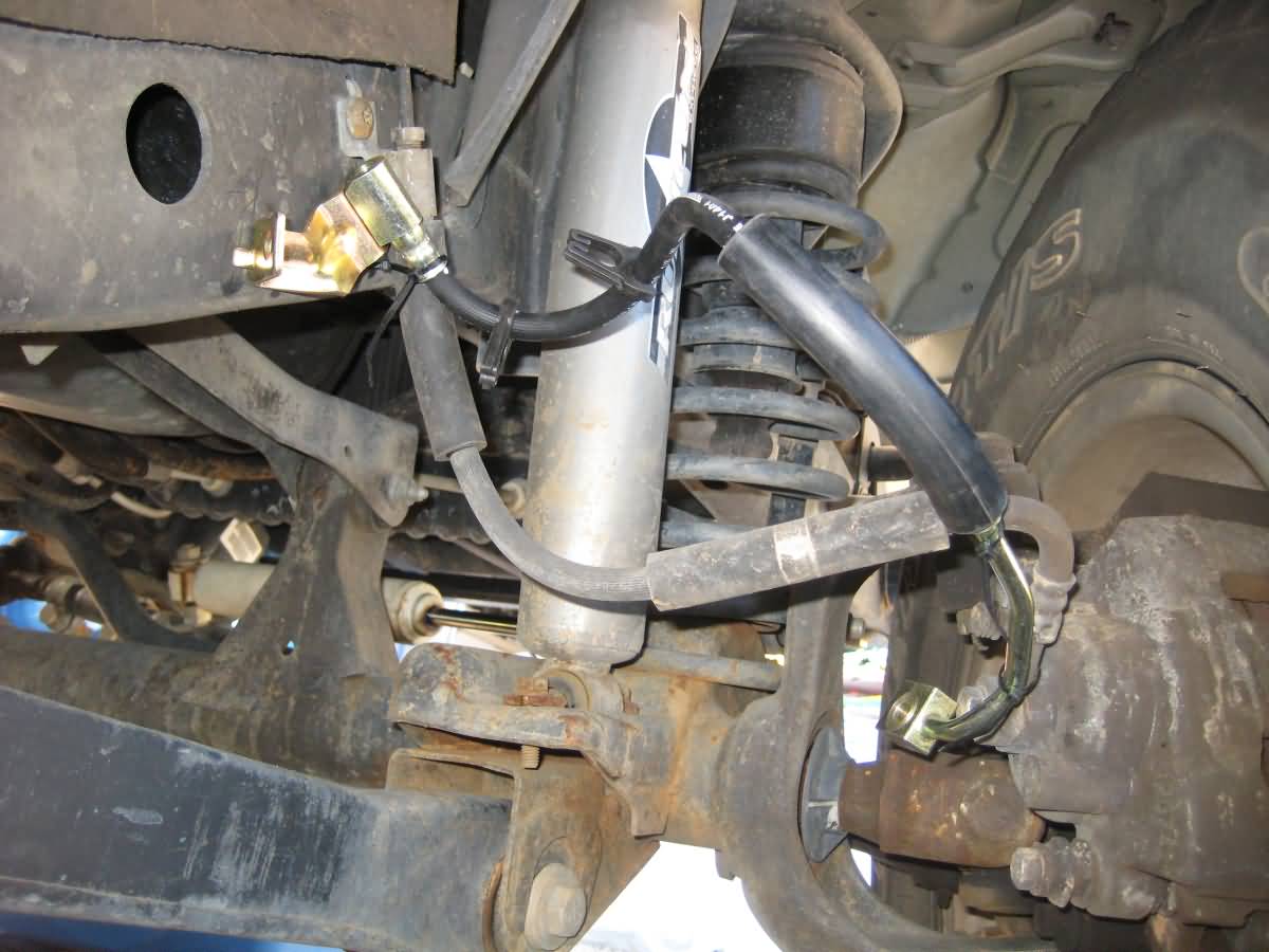

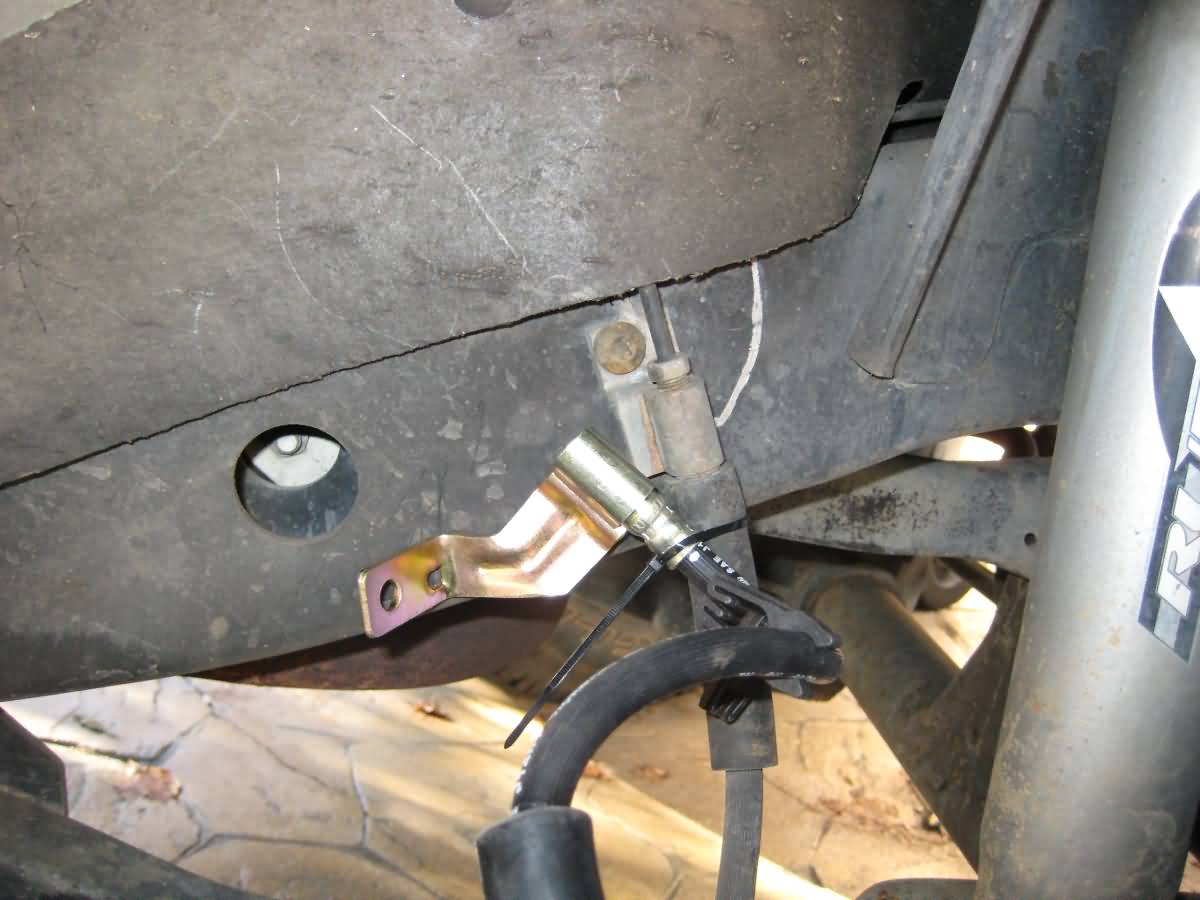

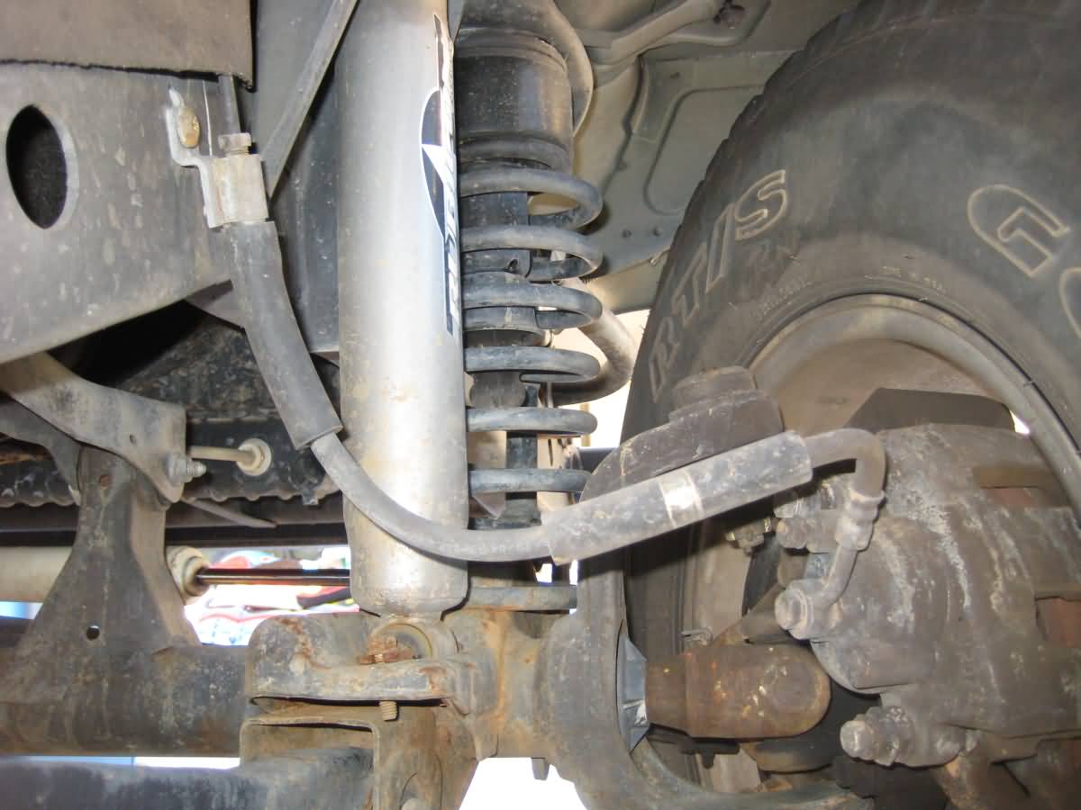

I picked up some brake hoses for a 2005 F150 with ABS. The were $35 for the front and $11 for the single back line. They look like they would mount up fine (same adapters on both ends), but I don't really think they are any longer than stock, plus the mounting hardware looks like it would have to be bent into position. I ended up taking them back, and will probably just buy extended ones made for my TJ (since they are only $20 more).
ok i looked up the 2005 ford f- 150 brake lines and im not sure they look different than the ones in this pic did u get two passenger lines or did u get a driver side too. i know u too them back. just a question.
I made sure to get driver, pass and rear - or at least that's what the computer printout from pepboys said.
