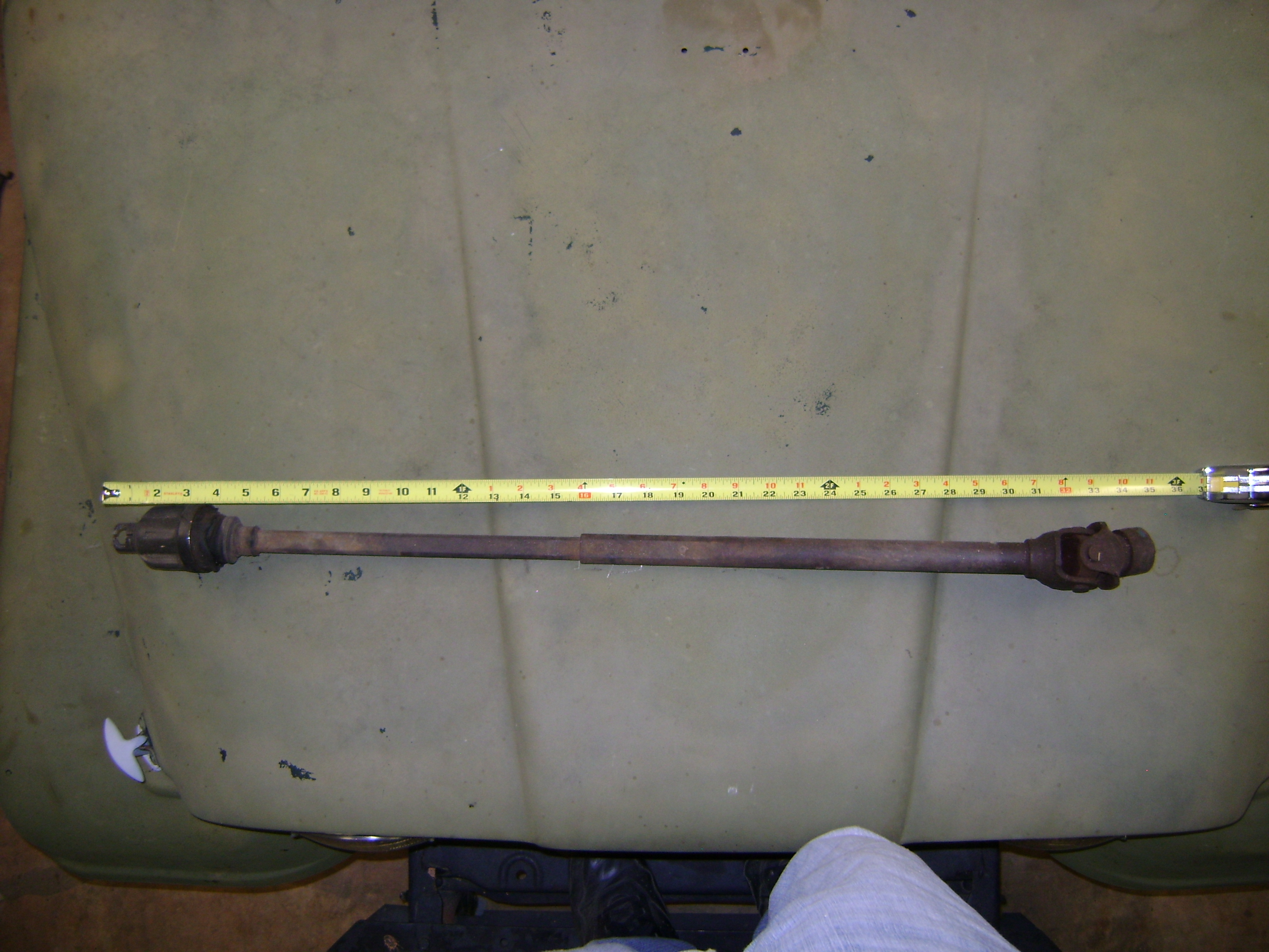

Let me know if you want a picture of it.
A 78 cj column should work just fine. You will probably need to use your existing shaft from the column to the box, other than that it should work, the plugs under the column should be the same as well. The only diff between the power and manual columns is the spline on the intermediate shafts for the diff spline count between power and manual boxes, the actual columns are the same.
Took a picture with a tape measure beside it.
Hopefully this will help.
If you can use it, I'll be glad to ship it to you.
It does have play in the knuckle joint, not real bad. The guy I bought my Jeep from, already had a real good spare, so I stuck it on.
