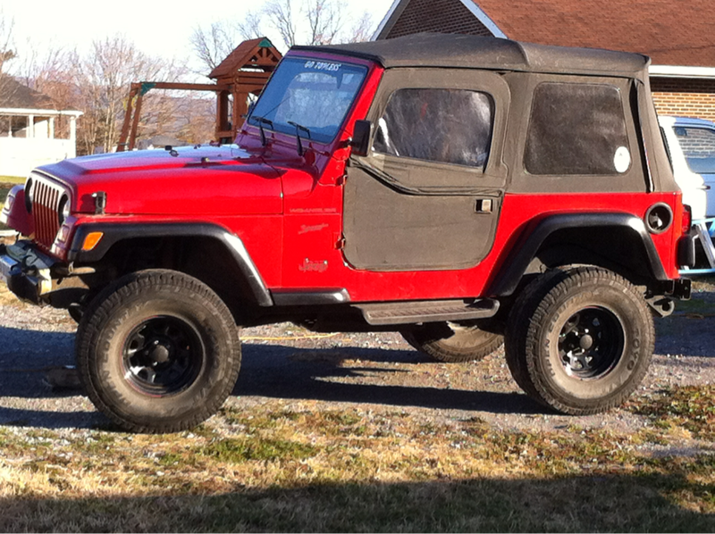

Looks like your missing a passenger front tire.
And why are there 2 of the same posts on here?? Sometimes there is one and sometimes I see 2.
Yes I was missing a tire we were checking joints and hubs and brakes again for the umteenth time. And checking pulleys and drive shaft, and jacked up the rear again ran through the gears listening to the transmission. And I Dk why it posted twice, probably cut in and out of service and the iPhone app double posted it.
