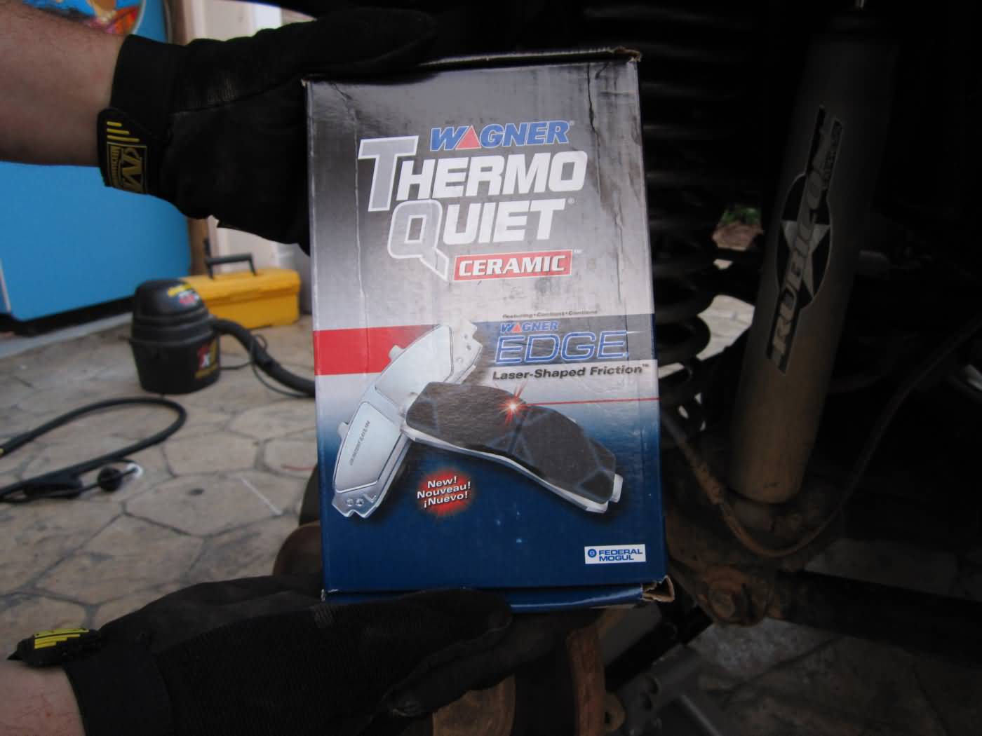

The Wagner Thermo Quiet that I'm running work great with no brake dust.
