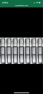

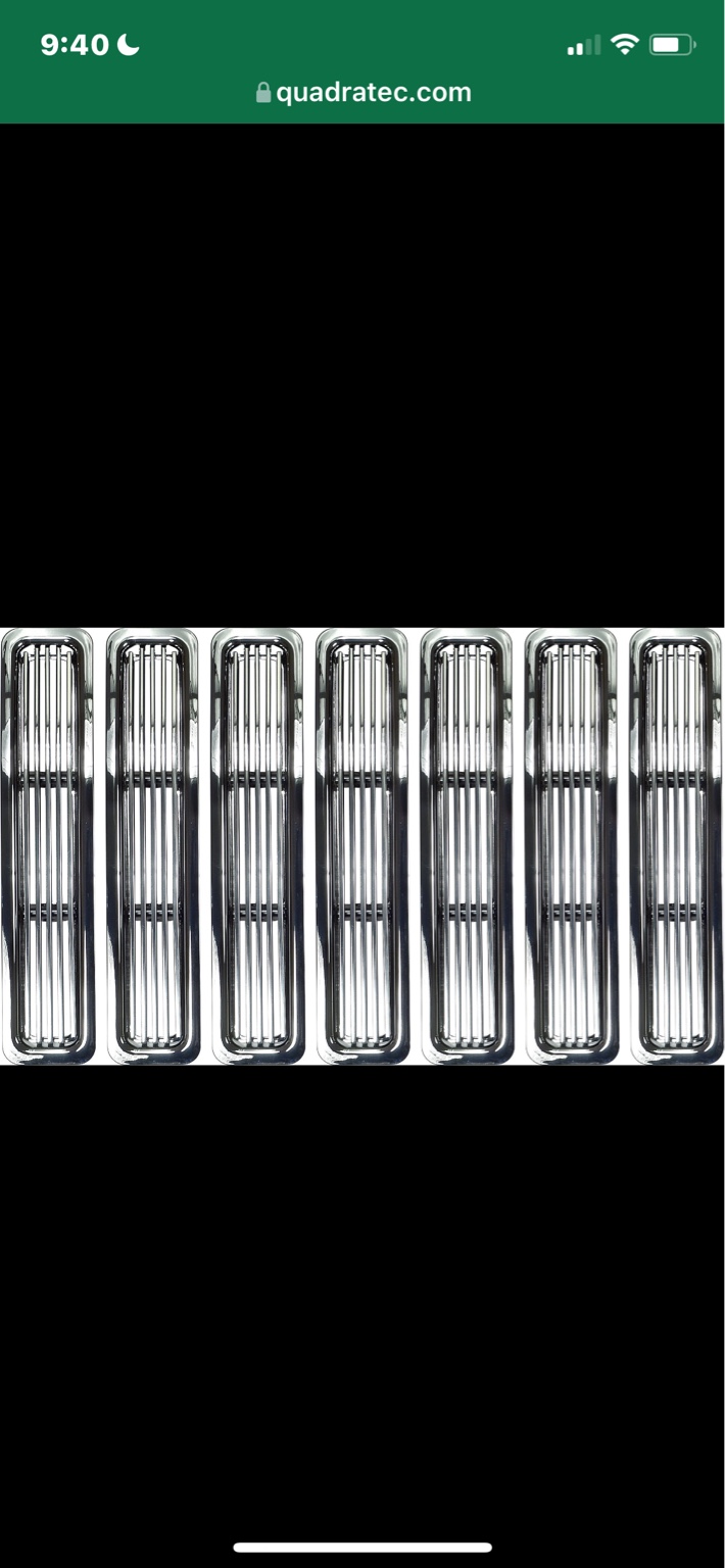

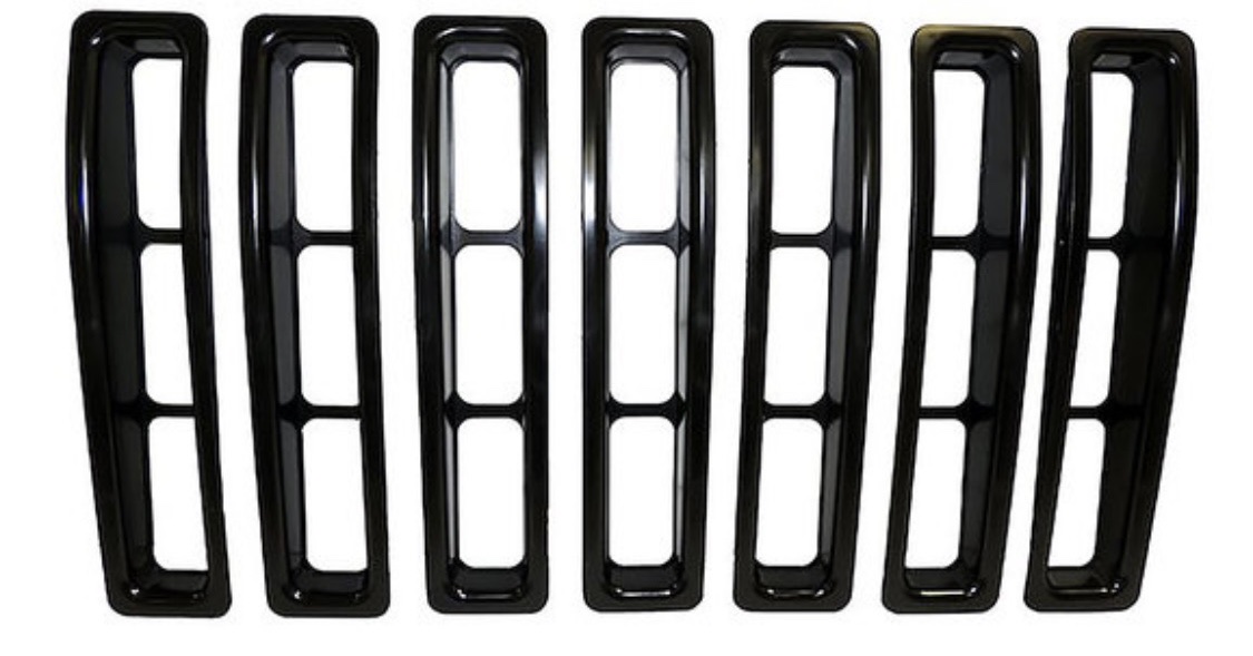

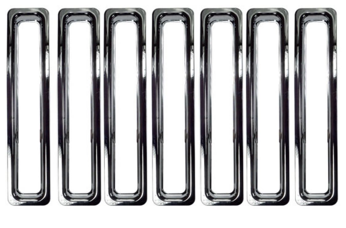

Well maybe. But it is something in front of the radiator disrupting airflow and pressure.
Others have found the same, wench has block air flow causing-overheating.

And nothing like these in the grill?
