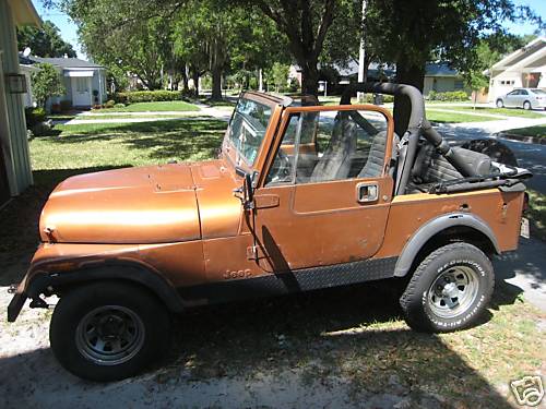

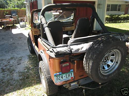

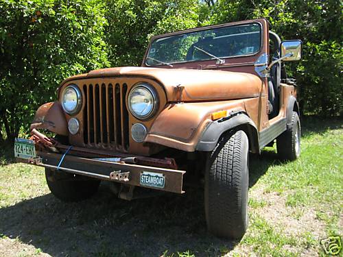

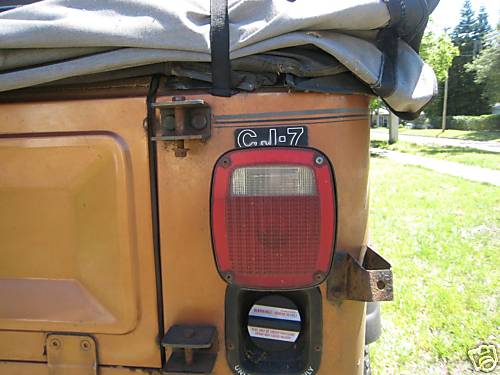

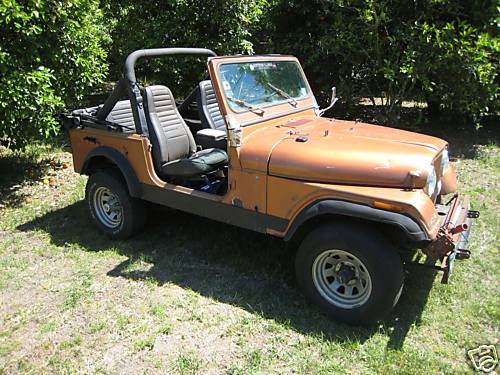

I have attached some photos - quality isn't great but I will take more when it arrives.
I expect that rust over the wheel wells is deep, and overall body has some bubbles. The Engine (258) was replaced 30K miles ago, brakes recently redone, as was the rear axle bearings.
The frame has some rusting at the very ends after the last mounts. Windshield is cracked. Fender flares cracked. Front driver's fender is bent down. Front passenger's fender has a dent in it. One of the headlights is out. No power steering or power brakes.
I have an excellent and reliable mechanic to assist me with any engine, transmission, electrical, brakes , ... misc work. The body would likely go to a bodyshop - I hear a full tub replacement runs about 75 hours, so that can get pricey.

Well it does look like it needs some work but there is no time the present to start learning how to do it yourself. Tub replacement isn't so bad; you need a helper to move to tubs on & off the frame.
