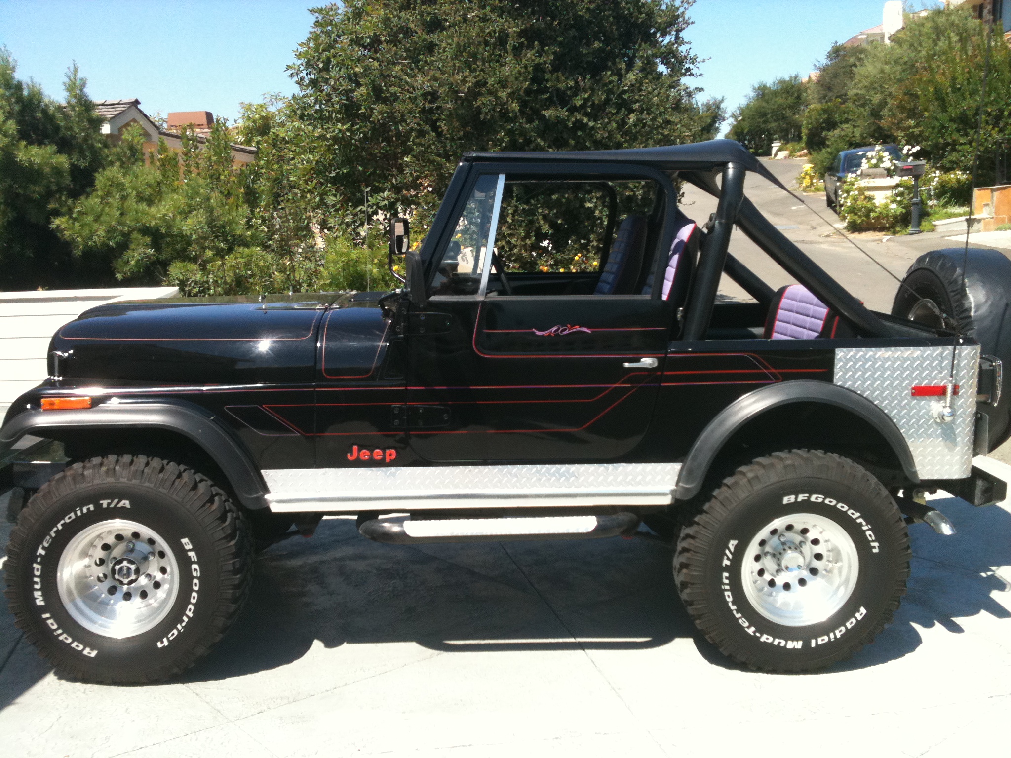

I have a 1980 CJ7 that has been completely rebuilt with a 360V8, Dana 300, 3.73 gears, with the exception of the stock SR4 from the original 6 cylinder.  Last week, it exploded on me.  I need to upgrade the transmission now to handle the rest of the truck.  I did a little research and it looks like there are no bolt in upgrades available, so I will need to modify drivelines, bellhousings, and purchase adaptors.  I drive the Jeep on the street mostly, so do not need a transmission with a compound low.  I would like something that shifts easy, but can handle the power of a V8 with about 300HP.  Is a T-176 is my best option if I go with a manual?  Has anyone ever converted to a TH400, and if so, is it difficult?
