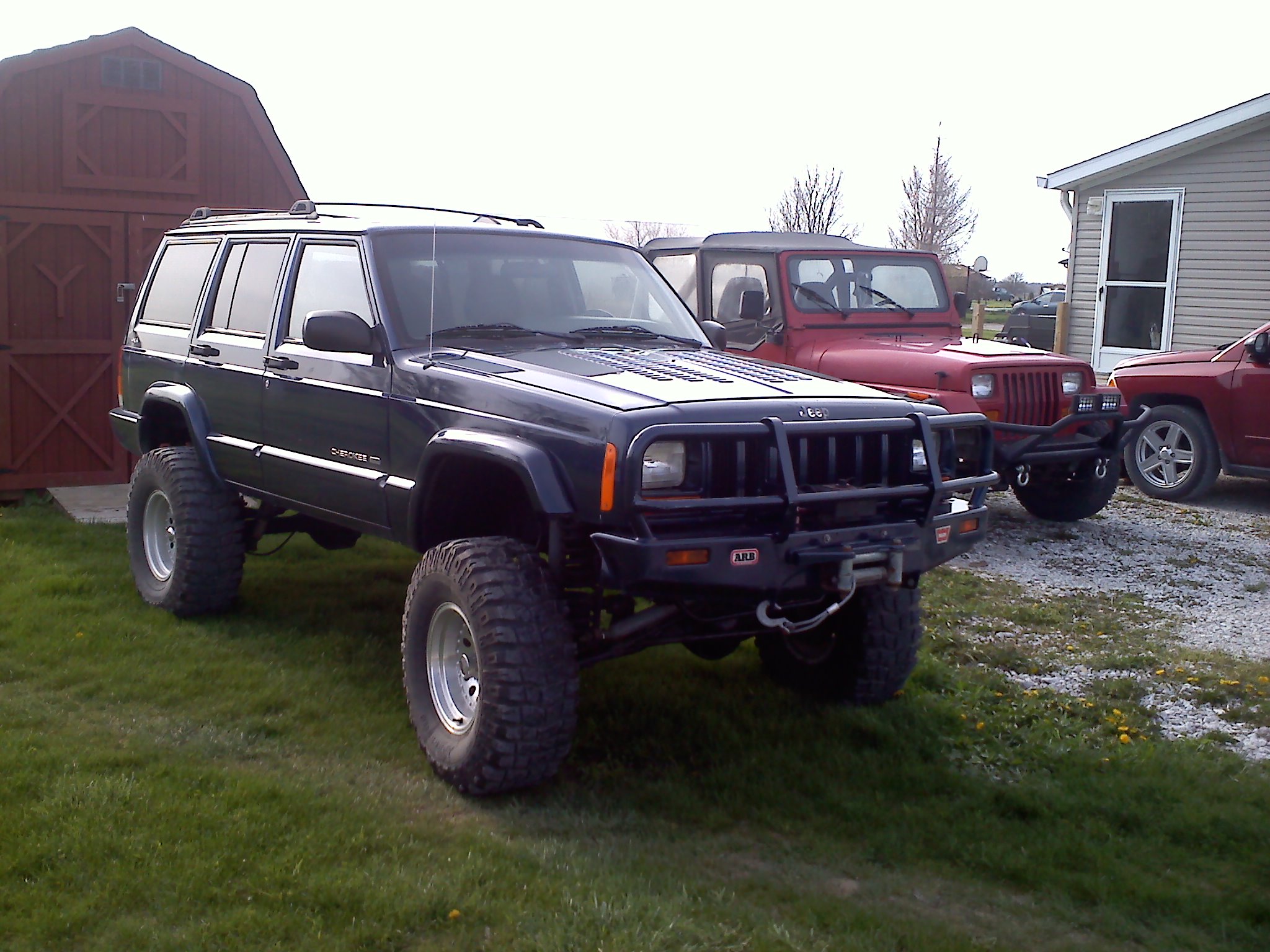

here is a pic of the vehicle in question. My new toy!!! :D

Great to hear it will be roadable soonest ! Glad to help and that I had the right info for you too ! I didn't get it at first or would have replied the same time you posted . Just wanted to be sure of my research was right , but you got good people looking out for you in our forum so don't worry , the replies will roll in so you can keep your jeep on the road and off your drive way ! LOL !
All to glad to help if I can , hope to hear good news when you can , when your not too busy putting mileage on your new jeep !
Best of luck and thanks for your reply . Greg92jeepxj .
P.S. - wish my jeep were as shiny as your , working on it though
