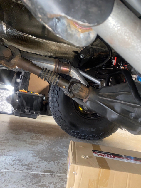

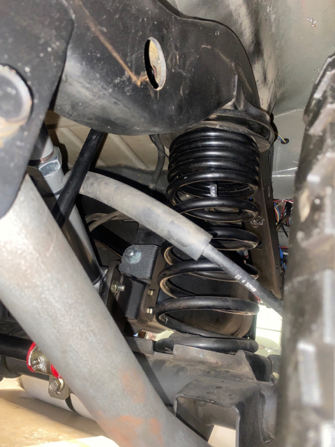

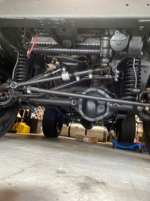

Hi there,
I have 2004 TJ Rubicon. I have upgraded from 4 inch lift to 5.5 in the rear with heavy duty coils. In the front I have added 1.5 inch coil spacers. I am running 35inch Falkens.
I also replaced upper rear control arms to adjustable once, so is rear and front track bars.
My problem is: I get into sway around 35-50 mph on any road and death wobble if I uneven pavement. Alignment and tire balance have been done (didn’t help.) My front and rear axles are centered. I have tried to set a pinion angle of rear drive shaft, it seams going higher angle helps, which is strange, because I don’t have yoke eliminator.
I have longer drop pitman arm I want to swap, so far had no luck removing PA nut... will try again.
Anyone can help with suggestions?
