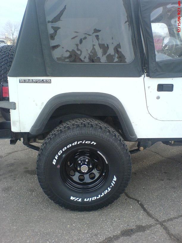

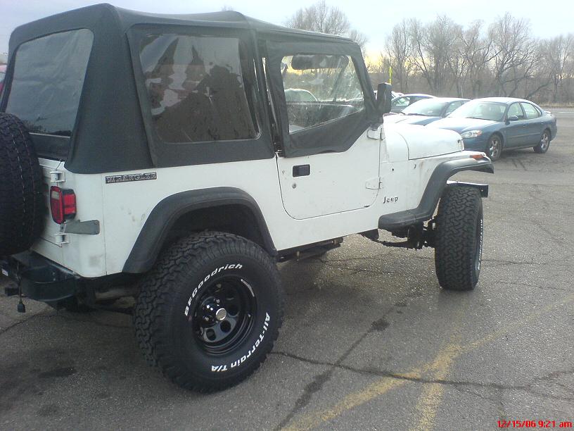

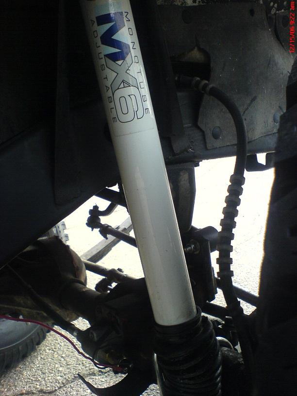

Well Hell, Project is complete, and I have removed all existance of the Sway Bar (Kept the part just in case), Funny thing is, I decided to take them just cause I was tired of trying to remove the bolts. What do you know, the damn bolts slid right out once diconnected. Oh Well... I will post pics Sometime tomarrow, Thanx for the help.... By the way, the ride is great, can't tell the Sway Bars are gone...8) 8) 8) 8) 8)
here are the recent pics of the kit I put on last week:purple: :purple:
