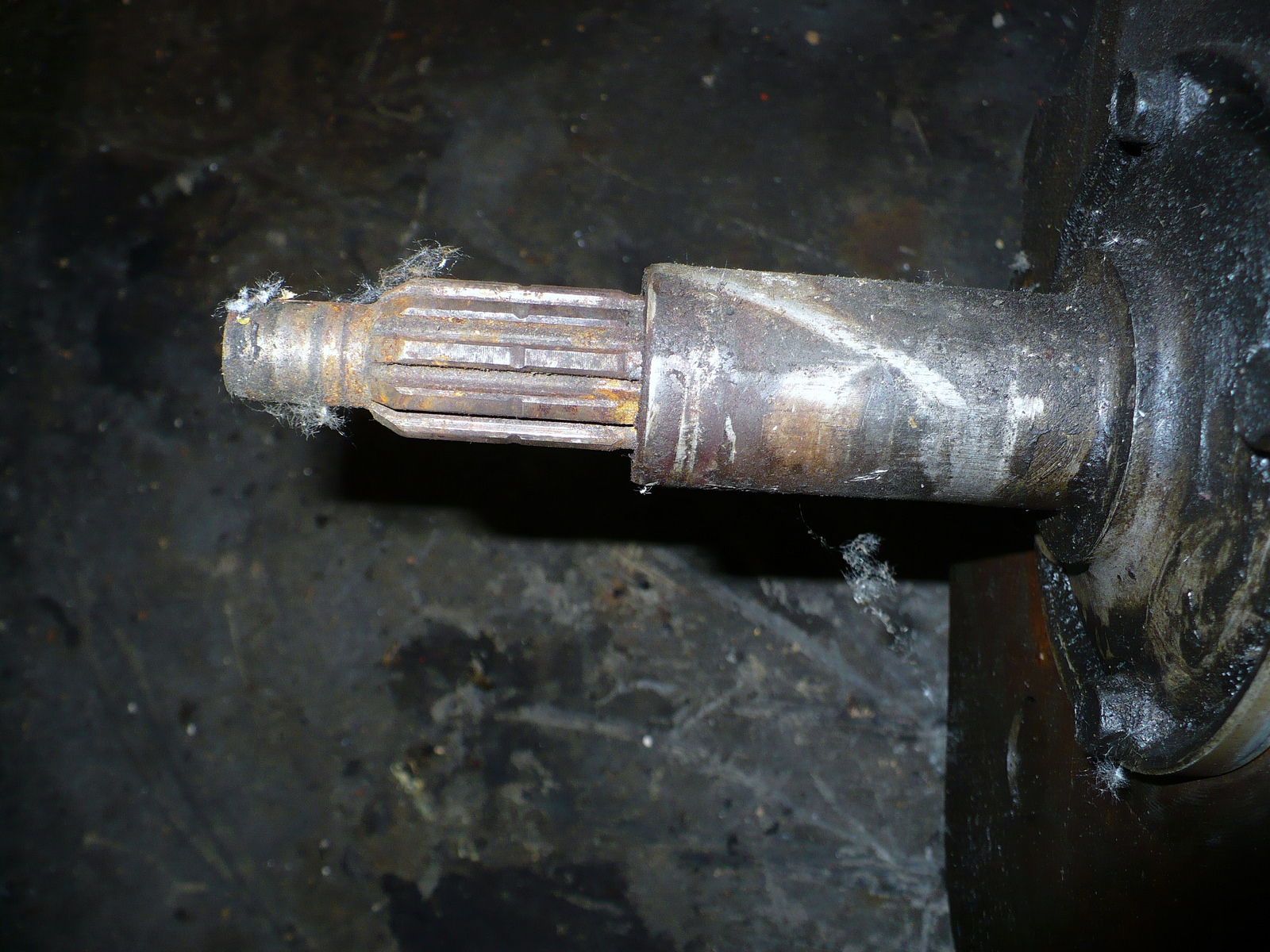

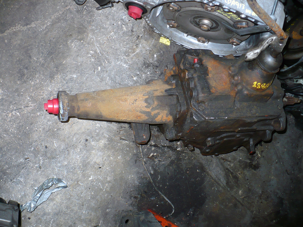

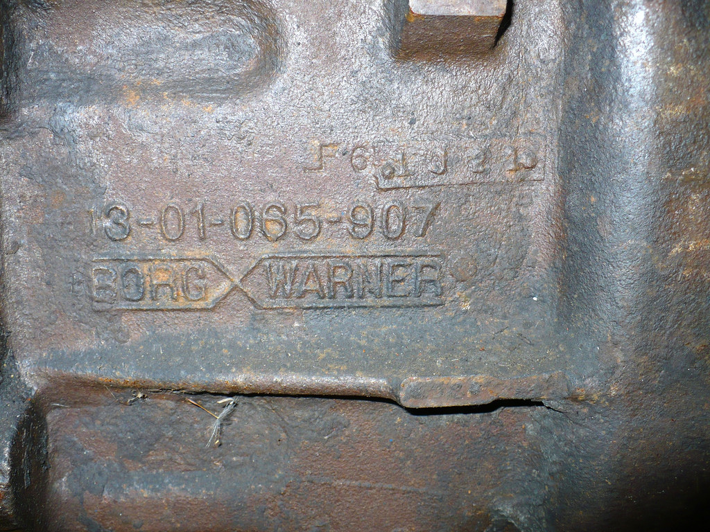

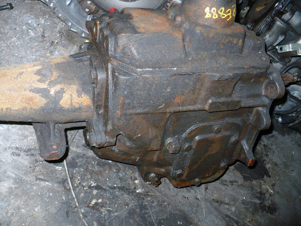

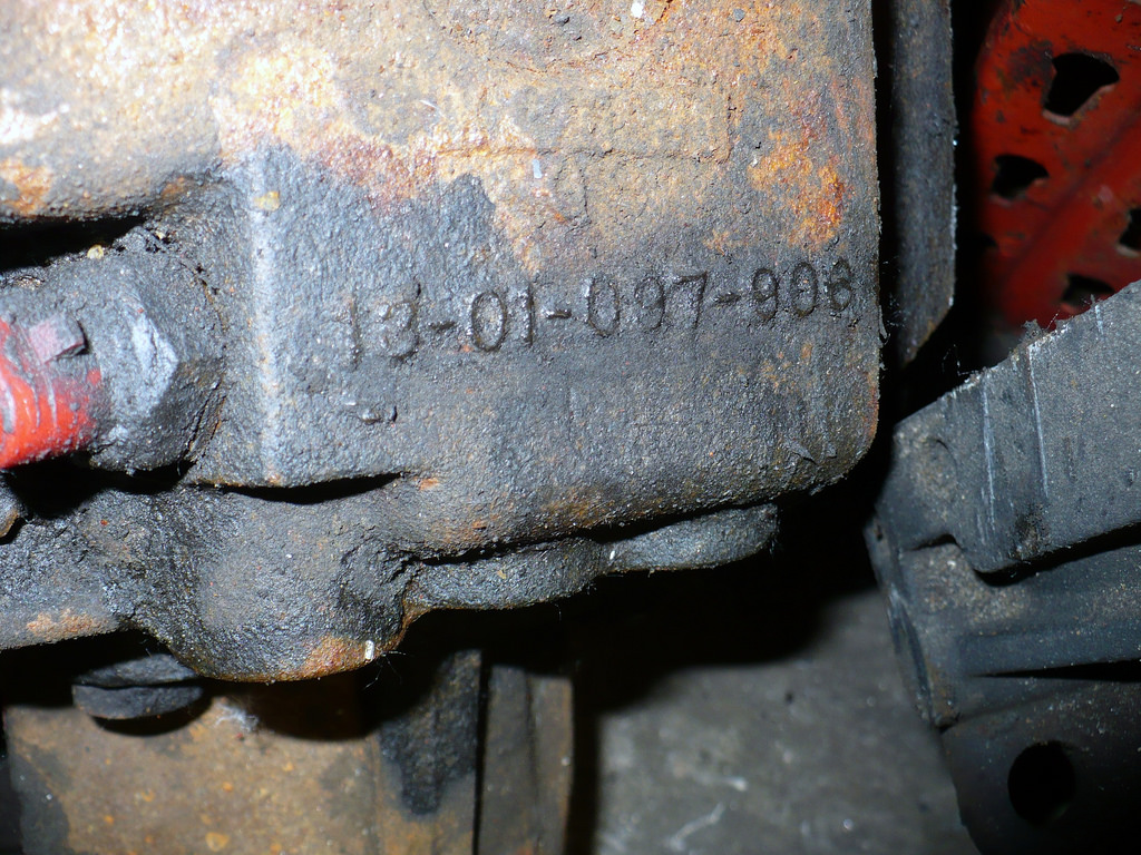

I've been ruminating since I first got BB about getting her more climbing ability. I've seen several posts and I'm thinking about converting a Ford T18 to her. I was at the yard today and by their records what I was looking at (rusty crusty and on the floor) was a 1980 T18 casting no. 13 01 065 007. This seems to be the 2wd version on account of it's long tailshaft. The gearshift was locked so I coudn't detirmine what gear it was in but turning the input shaft 6 time yielded about 110 degrees clocked on the output shaft. Could this be the critter I should be looking for for a bench build?

The 13-01 identifies it as a t-18. 2wd version is 6.32 first gear. That is the critter you want, but will need to get a adapter kit as you will have to change the main shaft, NOVAK
That's a relief, that it is the 6.32, I'm thinking I should be concerned by the tag on the shifter saying "No Oil" what's more while the in/out put shafts spin okay the shifter is stuck, I'm planning a slow bench rebuild but should I be worried?
ckrap I think I see a crack on the right side of the cover...

Well went out to the other yard and they had one that was mis shelved. Turned out we looked in the region it was while we were waiting for help, but I didn't recognise it being hooked up to a Ford transfer case. Having arrived just when they took a lunch delivery of pizza my buddie and I scrounged through the yard and found a candidate (2wd) still in the truck. If I find that local transmission indeed has a crack a friend from another forum has one available that he got as a lot.

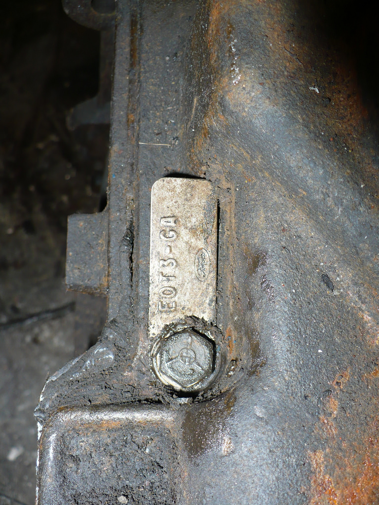

Well I went back to the first yard and with their permission tried to remove the top cover and inspect the gears. I could only get the left side up about an inch and a half but for what seemed a few chips on the reverse gear from what I could see the rest were okay (novice that I am). Asking price was $150 clams last thursday but after I took the guy to the trans. and discussed it with him we agreed at $20 over core for a total of $70. I hope I didn't get burned. Indeed what I thought was a crack turned out to be nothing. Found the date code tag while I was at it;

The E indicates the decade, c=60,s d=70,s E=80,s. The first number is the year "0", so looks like you have a 1980 t18. This info came straight from Novaks wedsite.

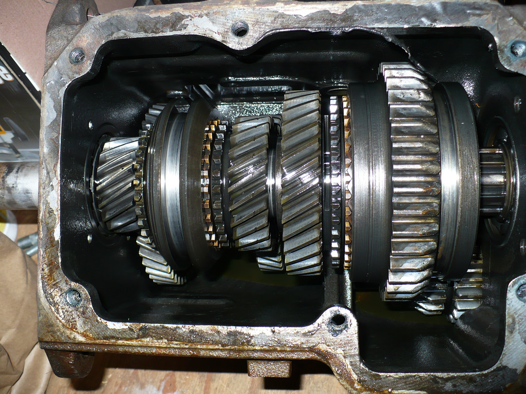

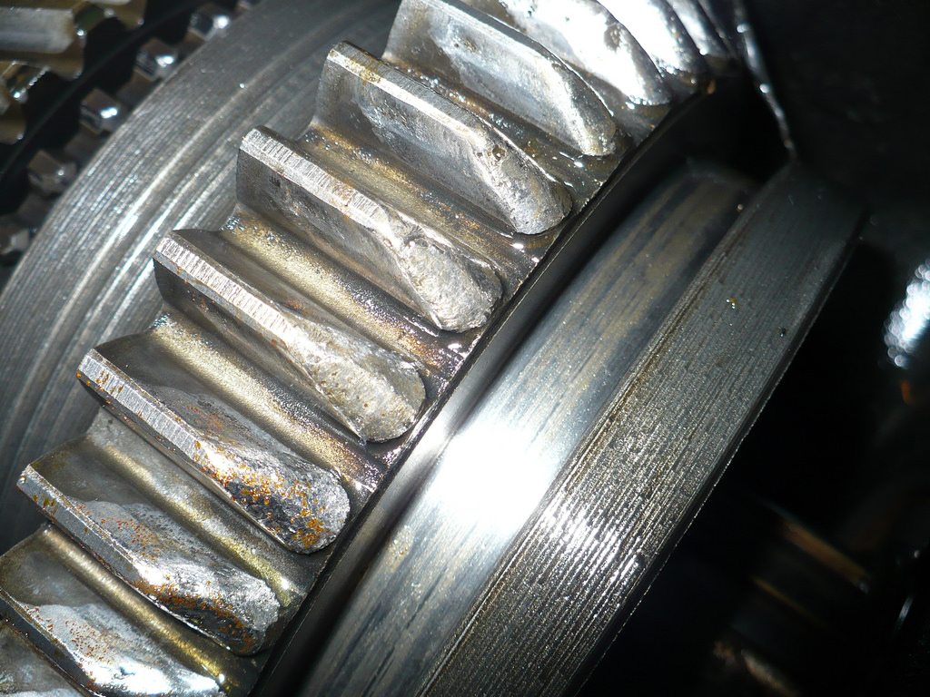

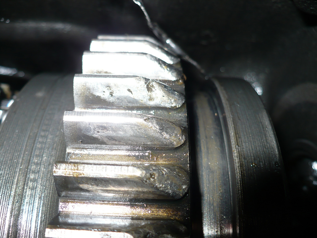

Yesterday with the gearshifter already removed I took my mini mag light and found the 1-2 shifter rail and put 'er in 1st. Revolving the marked input shaft and counting the turns on the output it yielded 6+ turns so I'm in the clear. I removed the Shift Control Housing and rotating the input shaft again I see that the First-Second Clutch Sleeve showed signs of wear on the beveled side while my cursory novice look inside the case I saw no other signs of wear. I took several photos with my phone which promptly were lost, going to drag my work camera home tonight and post photos of what I found so far.
Pics;
The inner sanctum
Close up of 1st-2nd clutch sleeve

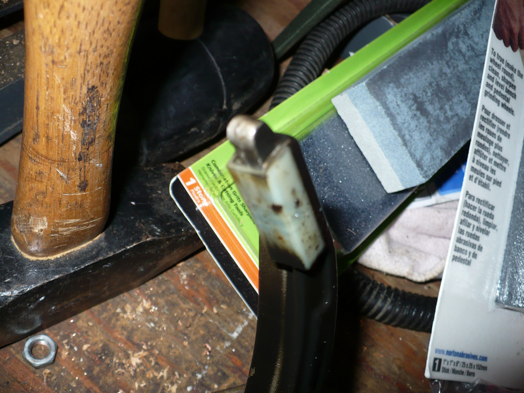

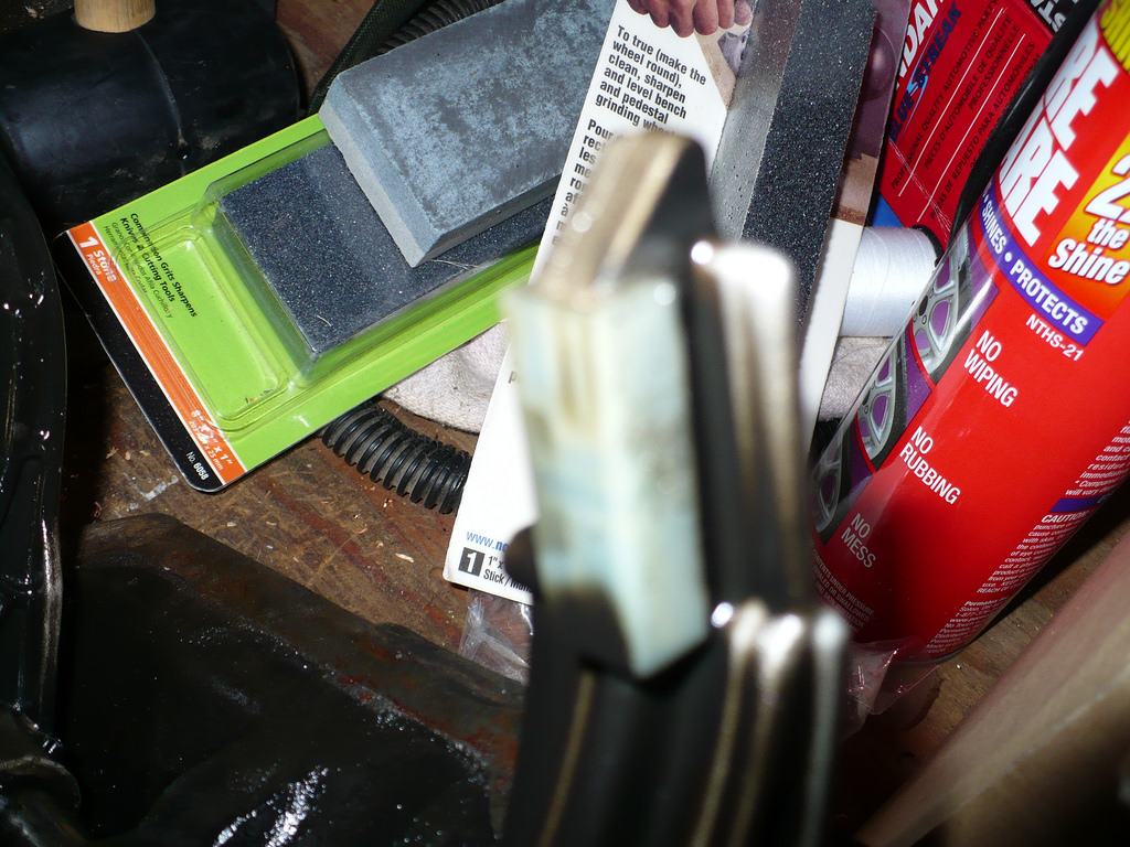

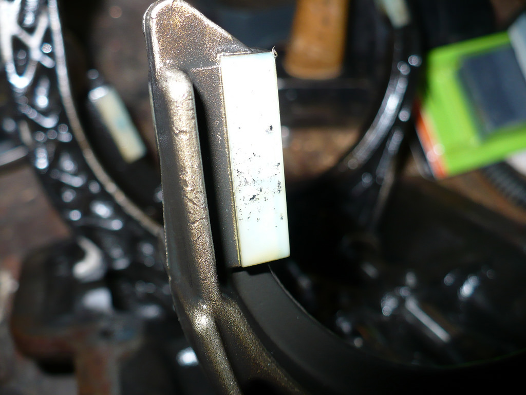

The four telflon pads on the shift forks;
