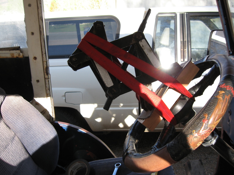

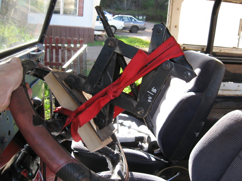

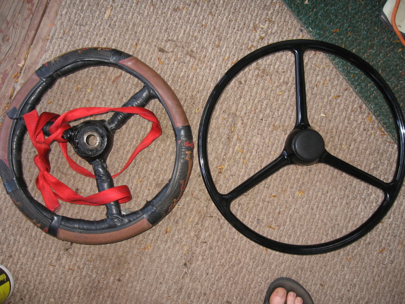

i did some lookin around to see what i had here to get that old wheel off.
i soaked it for a week with gun oil.
and just started crankin.
when that thing let loose it made a crack like a bullwhip.

loosen the nut holding the wheel but dont remove completely.
stack washers over horn button switch.
and go to town!
