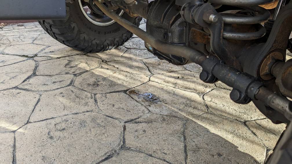

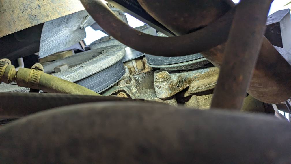

There's a pink puddle under my Jeep that feels slick on my fingers . Looks like my water pump is leaking.

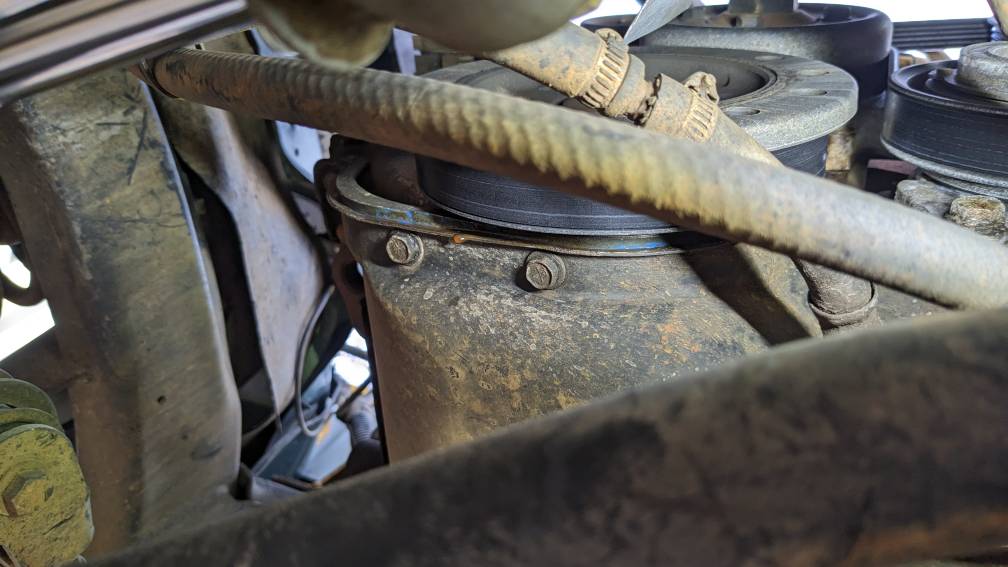

You can see a drip coming down here:
Hard to get a good picture, but it looks wet under the pump:

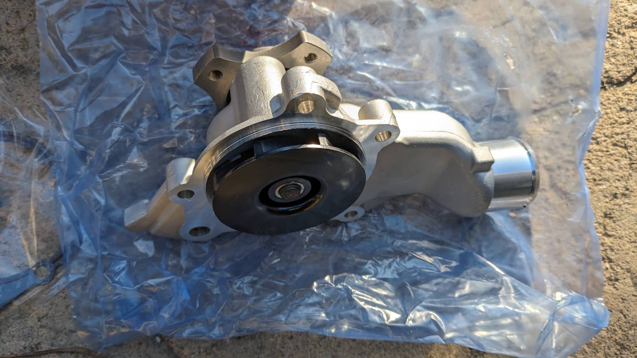

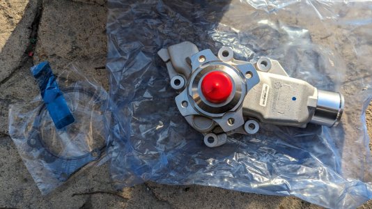

I ended up getting a genuine Mopar waterpump for only $91. It was an Amazon warehouse return (i.e. someone bought and returned it). It was a bit of a gamble, but the pump looked pristine and came with the gasket (the box itself was beat to heck).
The job ended up not being too bad, largely because of some of the tools I picked up lately.

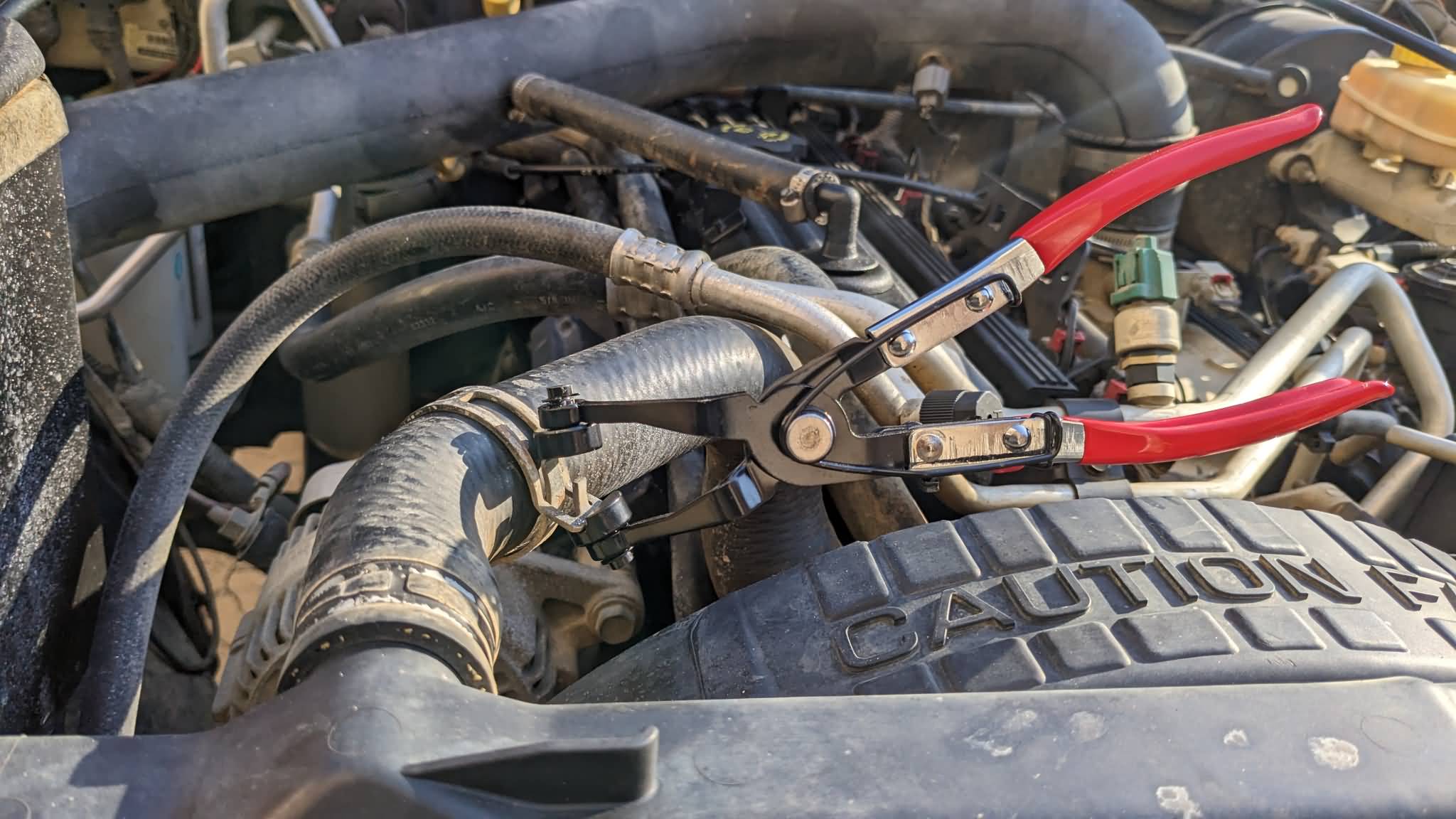

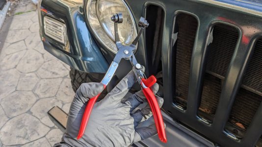

These hose clamp pliers make life so much easier, especially on the larger clamps. They lock into place, holding the hose clamp loose

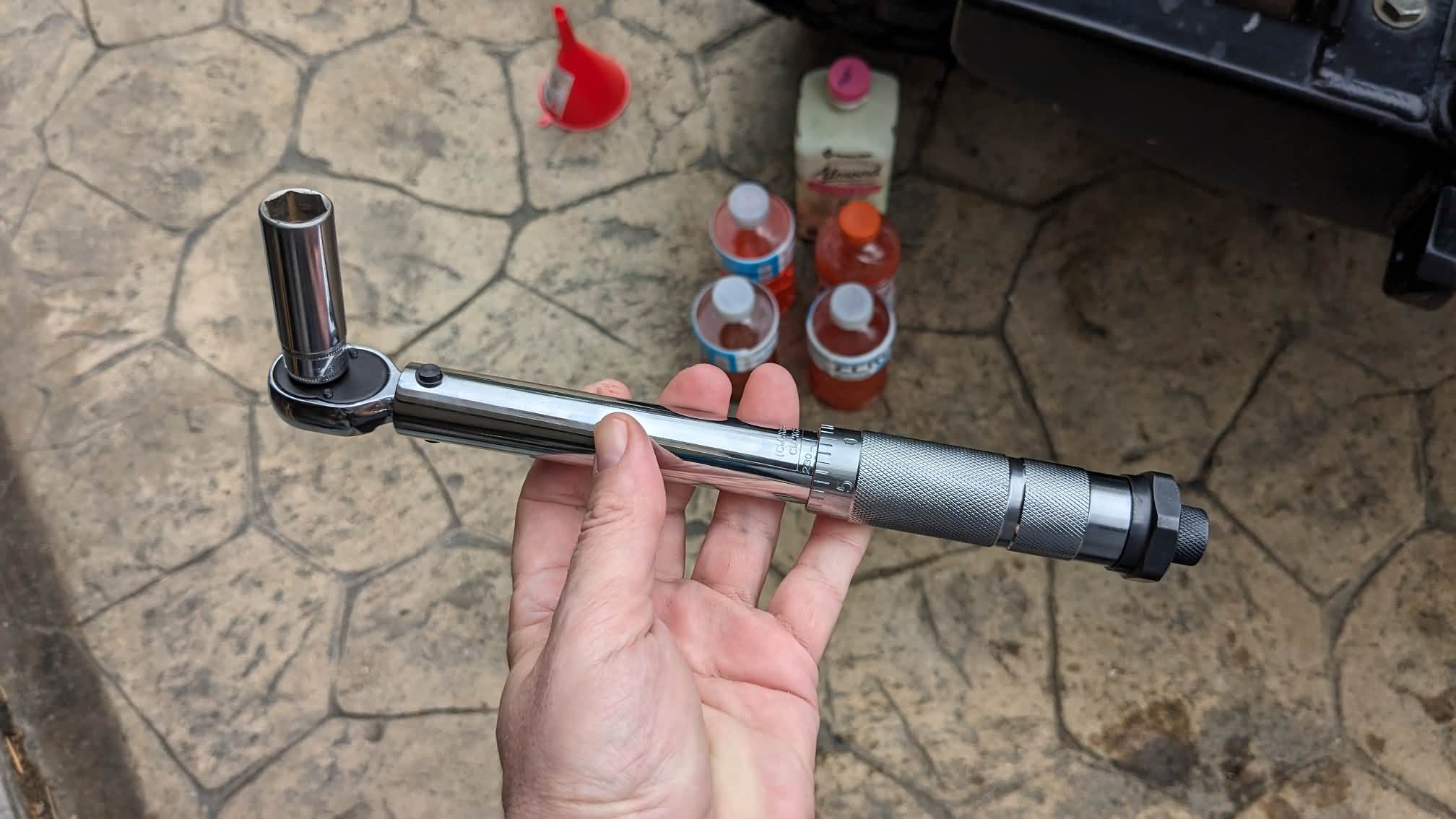

I picked up a new 1/4 torque wrench to use on the bolts. I think it clocked in at $10 on sale at Harbor Freight.

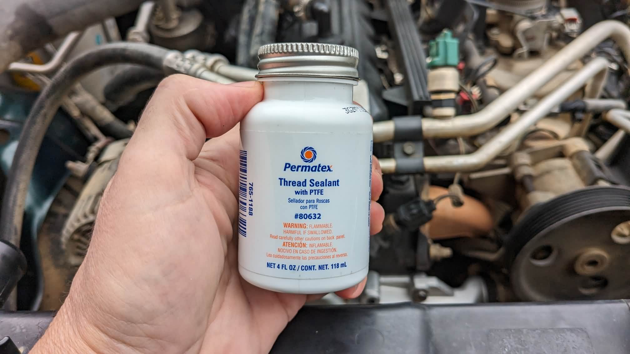

I used some thread sealant on the bolts. I've heard that's necessary as they pierce the water jacket.

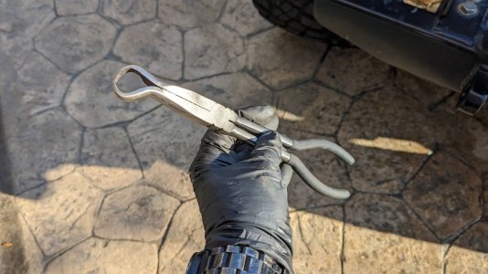

and my good old hose pliers
