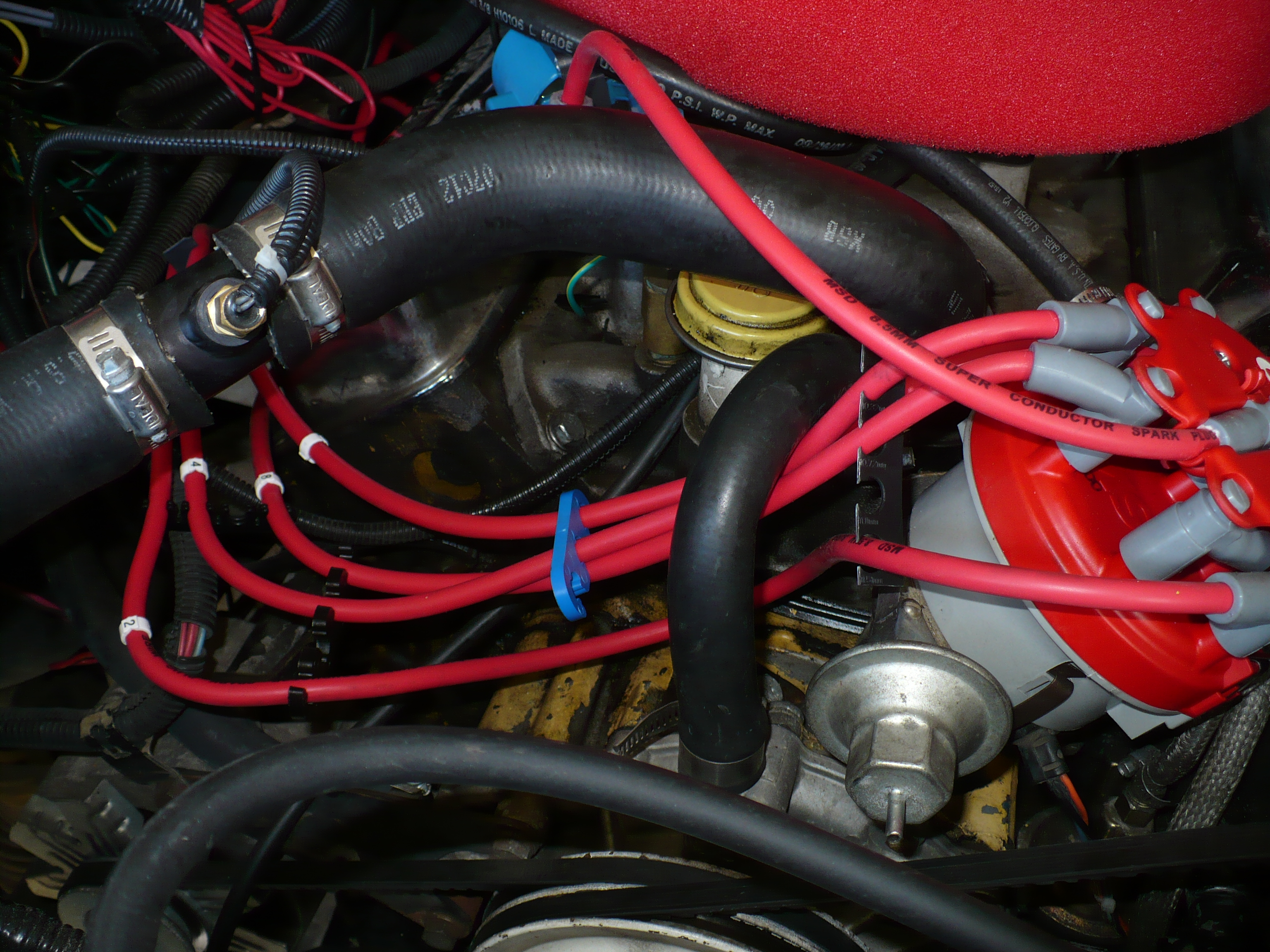

Yesterday after work I modified the route of the right bank spark plug wiring to go under the Bypass hose maintaining as best I could the wire seperation. When I get some more kazooks I'll get more wire sperators, or make some. I was getting Handyman magazine for a while and they kept sending me 'bonus' plastic bolt sizers. For part of this I cut a couple of rows off and used them as surrogate wire seperators.

I re-routed the wiring for the right bank to go under the Bypass hose to get it away from the Coil wire
