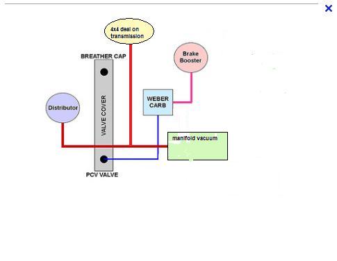

i think i removed all that vacuum stuff on my 87 when i cleaned up the engine bay. edit: i guess i left the one to the tcase by my old drawing
