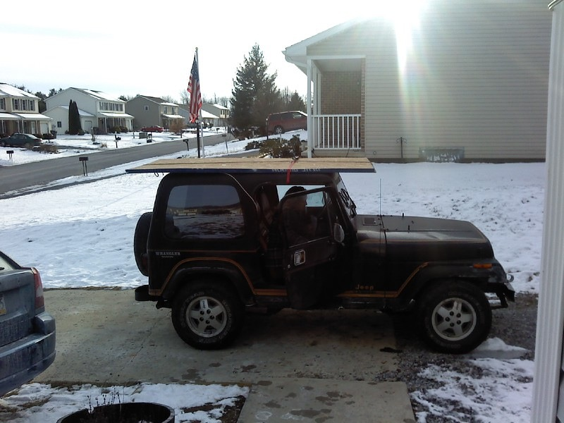

I replaced the cowl seal on my 87 yj bit I still get water on my drivers side floor. WTF. Help please.
