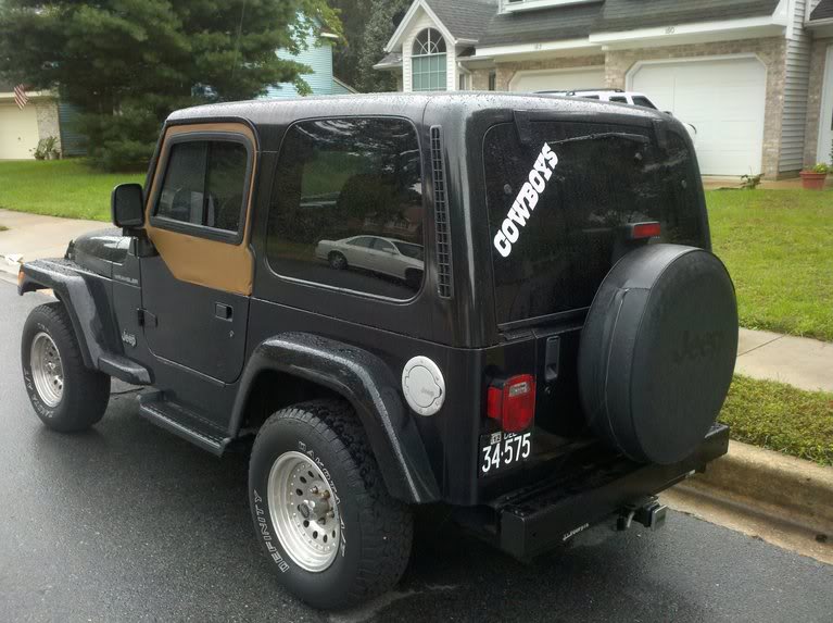

Here's my 99 top you can see the vent behind the vent

Thanks for the clarification. Mine has the side vents just like your's, so that narrows it down. I figured the pic's shown in ads were not the exact item as they appear to be the same pic for all year ranges. I'll get one ordered today. Thanks again!
Yeah, 03 to 06 no vents behind the side glass windows. Now, I believe the rear wiper wiring plug (at left rear) is different for 97-02, vs 03-06.
