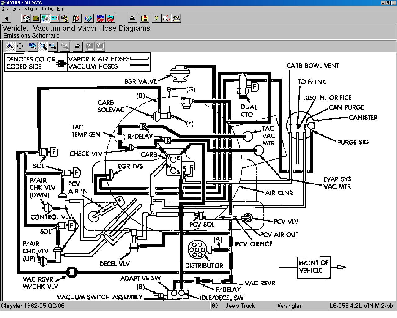

I am having trouble with a weber carb on 89 4.2 that was installed on my jeep before I boaght it. They seem to leave off a bunch of vacuum line in the engine compartment. I can't figure out where the EGR should connect to the weber and also the distributor. If any one with this set up or could walk me throught the set up I would really appreciate it. Or if anyone with this set up could take a picture of where the vac lines connect that would help. Trying to aviod taking it to the mechanic his prices are high for simple things.
Here is a vacuum diagram

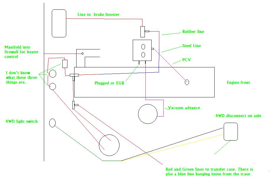

Here's how my vacuum system is set up. Drawing's a little crude. Let me know if you can't read it. I can email it to you if not.
