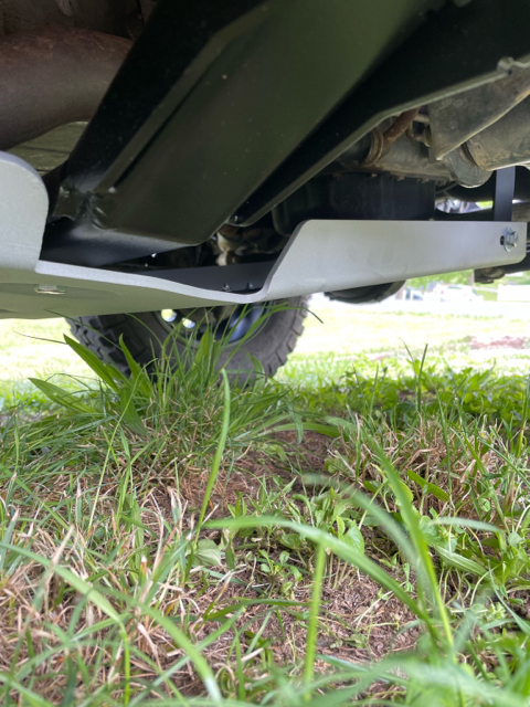

finally put the skid plate drop kit on. it almost completely got rid of the vibration so maybe a washer or two more and it will be completely smooth.
and learned the t-case shift level needs a drop too, or a cable replacement instead of the z linkage. i will try the bracket first and go from there. this was completely disconnected so i think when it rolled, the transmission slid sideways and linkage was knocked out of place. with the skid drop though, its not inline anymore, anyways so.. we shall see how it goes though

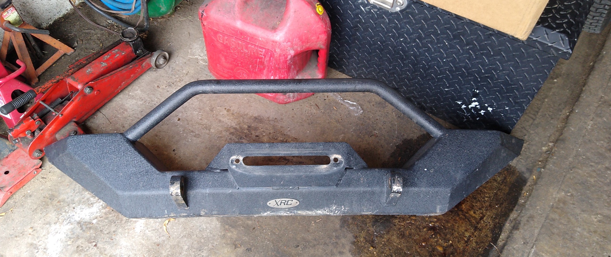

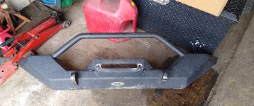

Picked up a front bumper for the ol jeep. Pretty decent price and a nice drive through the coast side to get it image000000_01.jpg

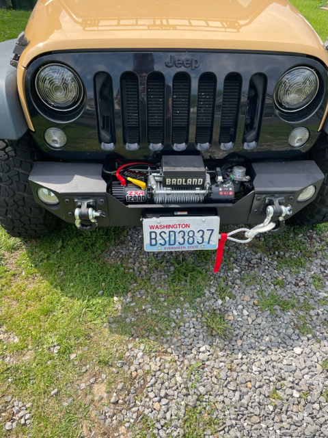

Bumper is on. Took hours because the top holes we 1/8" to close so I had to get a Dremel and make them a little larger. Thannn the stupid welded nuts in the frame, closest to the grill, snapped free. So lots of fun during the install but I eventually got to this point....

Added a winch today. Got a pretty good price yesterday and didn’t want to pass it up. The rail that connects the frame up front really got in the day. Had to completely disassemble the bumper to get it bolted on. Took me a while to get the front grill back on. No room to fit a cover on it. Hoping it gives me a couple uses.

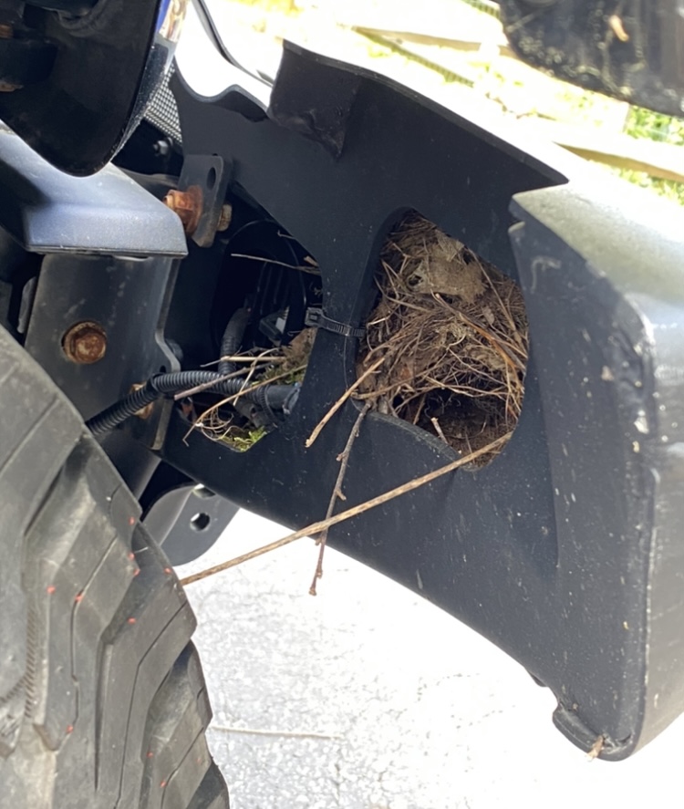

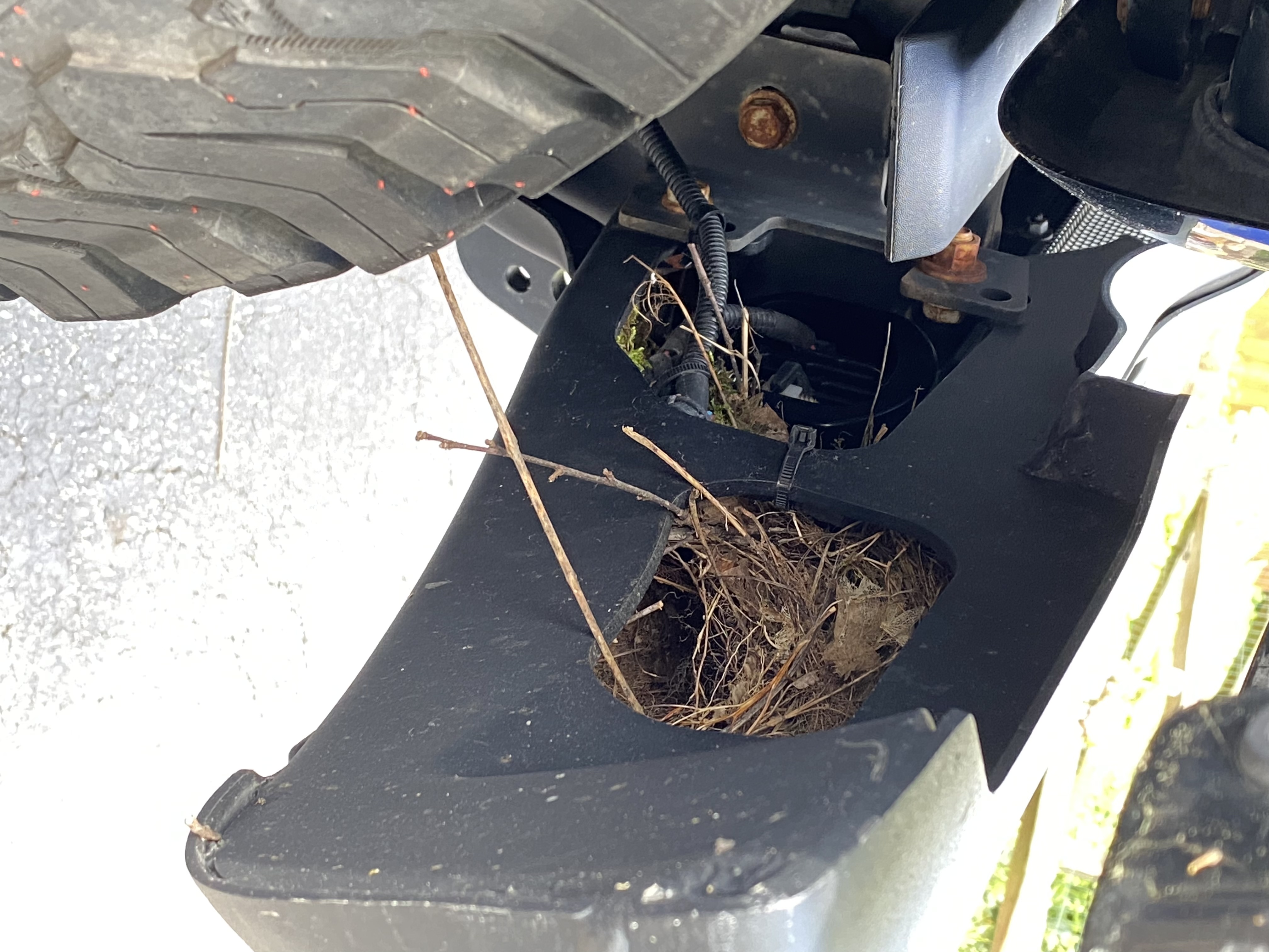

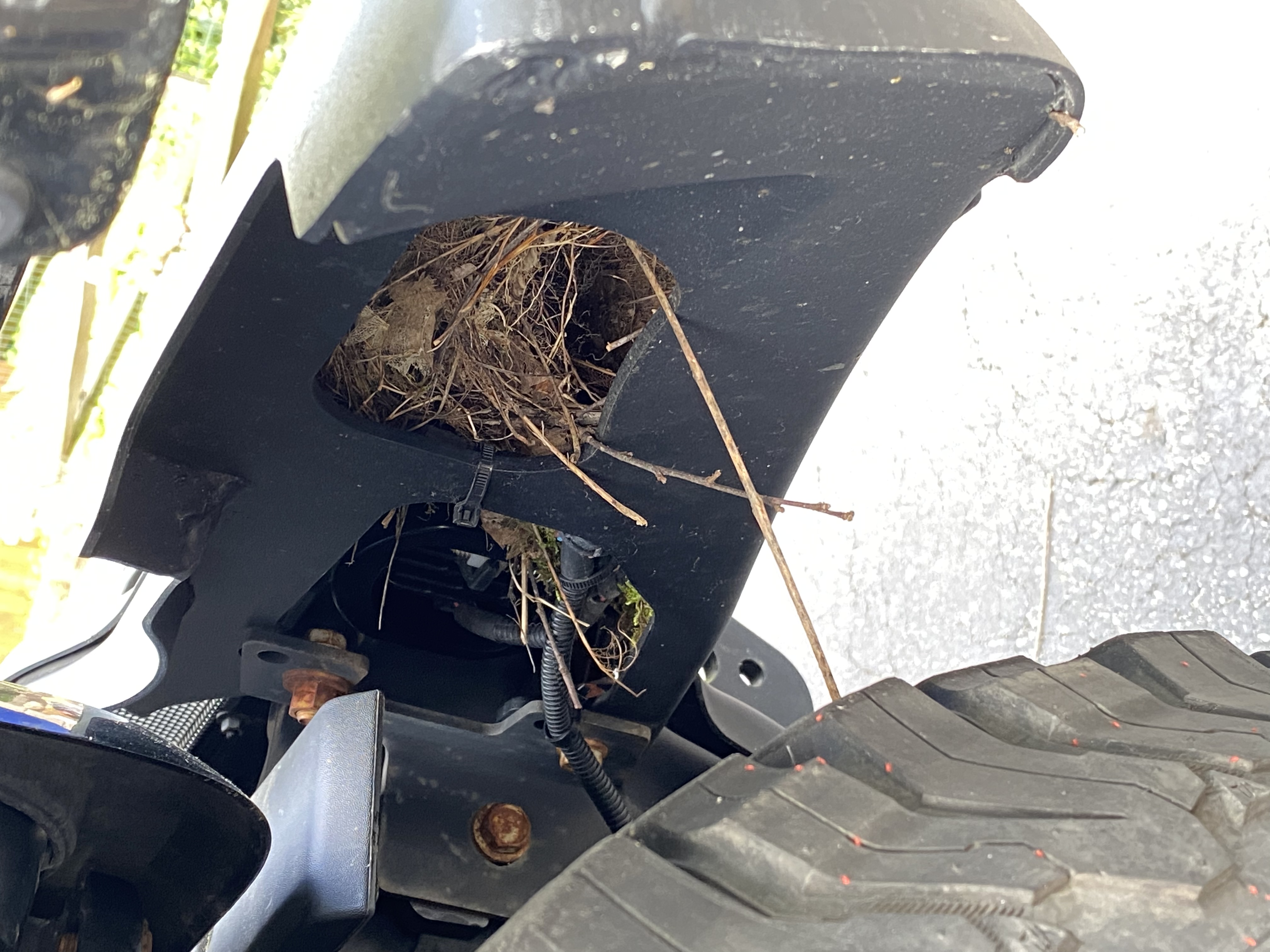

After cleaning up the bird shizz I found another problem….C83E8FFA-2BE2-49E5-80E4-748D51D36D08.jpeg
