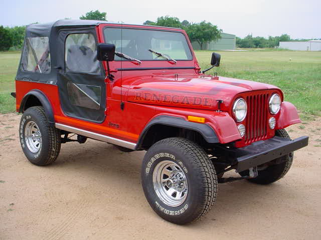

CJ7: Non pcm/tcm. ECU only controls the ignition. Available in a 4, I6, V8. Hood, Windshield frame, fenders, rear tub wheelwell, rear tailgate and dash instrumentation is different from the YJ and TJ wrangler. YJ and CJ's are leaf sprung suspension, Tjs are coil and link suspension. YJ's are the half breed on the PCM technology between the CJ's and TJ's. TJ's and Cjs has the round headlamps, YJ's are rectangular. JK's are a whole different beast overall. Later TJ's and the JK's are available in a longer wheelbase. Jk's is available in a 4 door configuration.

CJ's have a narrower wheelbases, carbureted engines, simpler interiors. They have round headlights which are inset in the grill slots. There are several models of CJ's, most common are the CJ-7 and the CJ-5. The difference is in the body style and wheelbase I believe. The CJ's go up to 1986.
