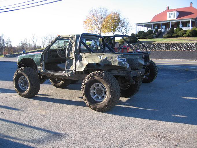

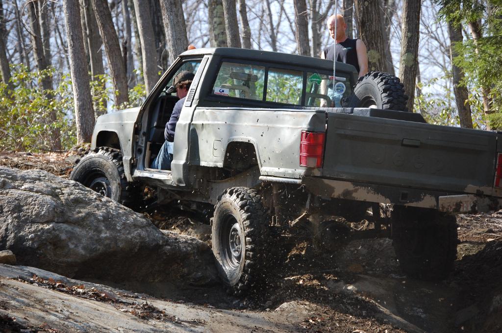

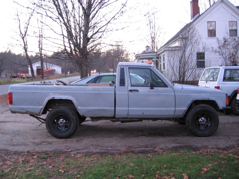

This MJ has been wheeled for about 4 years solid with out doors. you can see it obviously has been wheeled hard, has sub-frame stiffeners and believe it or not, up until about a couple months ago, the doors still closed and latched. Looked funny cause the doors were mint and the rest is well... not. (doors were put on for storage between wheeling trips.)
thanks unfortunately this is what it looks like as of two days ago

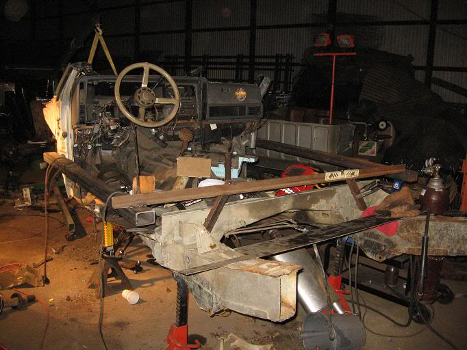

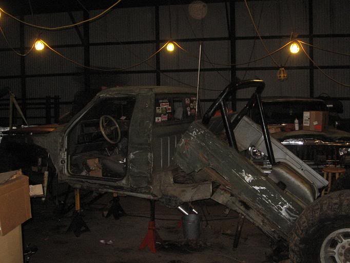

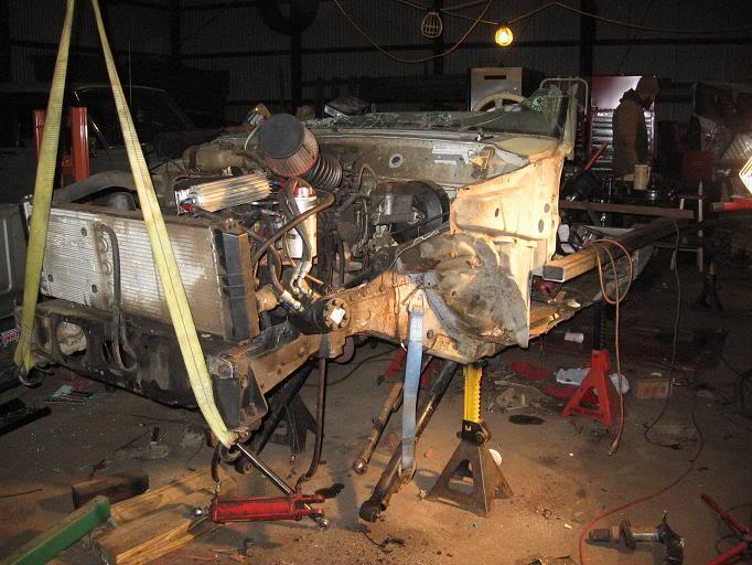

Unfotunately since there was never a cage put in, the body got so beat that when you sat in the drivers seat, half you shoulder was actually outside the cab, really became a safety issue so we removed pretty much everything. we are boat siding it, building a complete chassis for it out of 1.75 DOM, stretching the front 3" and 4 linking the rear. I can see if I can find a pic of it when it was bought.
