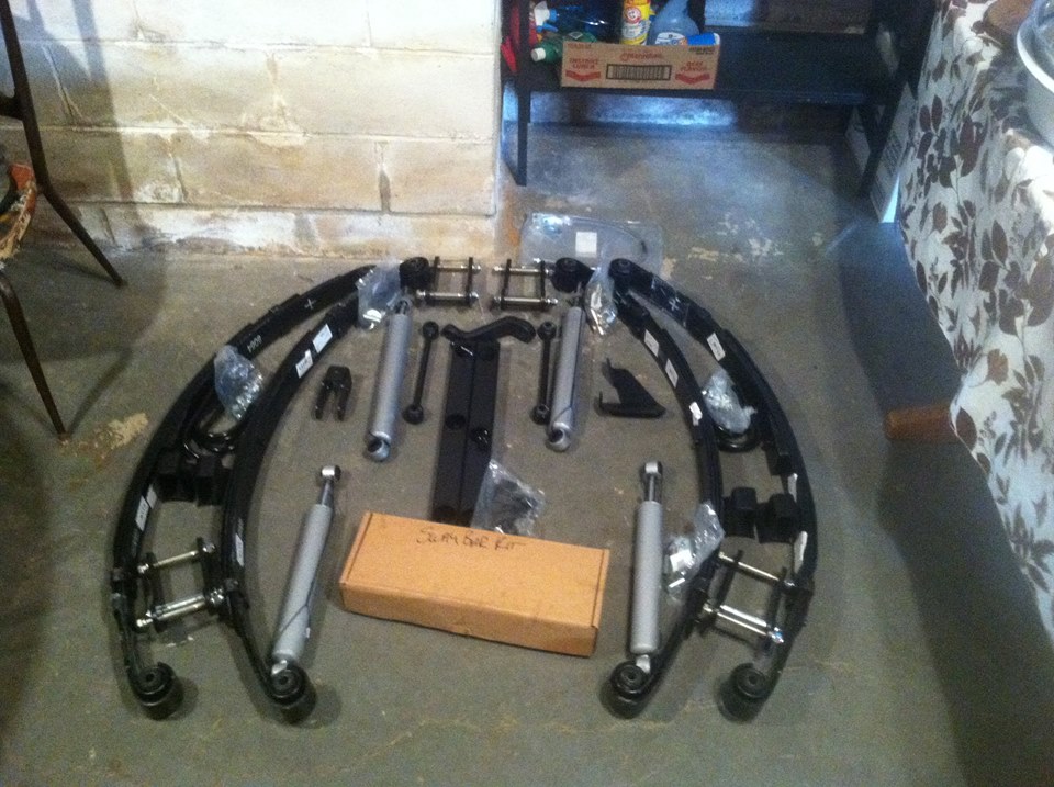

Will upload a before pic and of the kit laid out if I can get this laptop to cooperate
Here's the lift laid out and a before pic for reference. Surprised it worked!

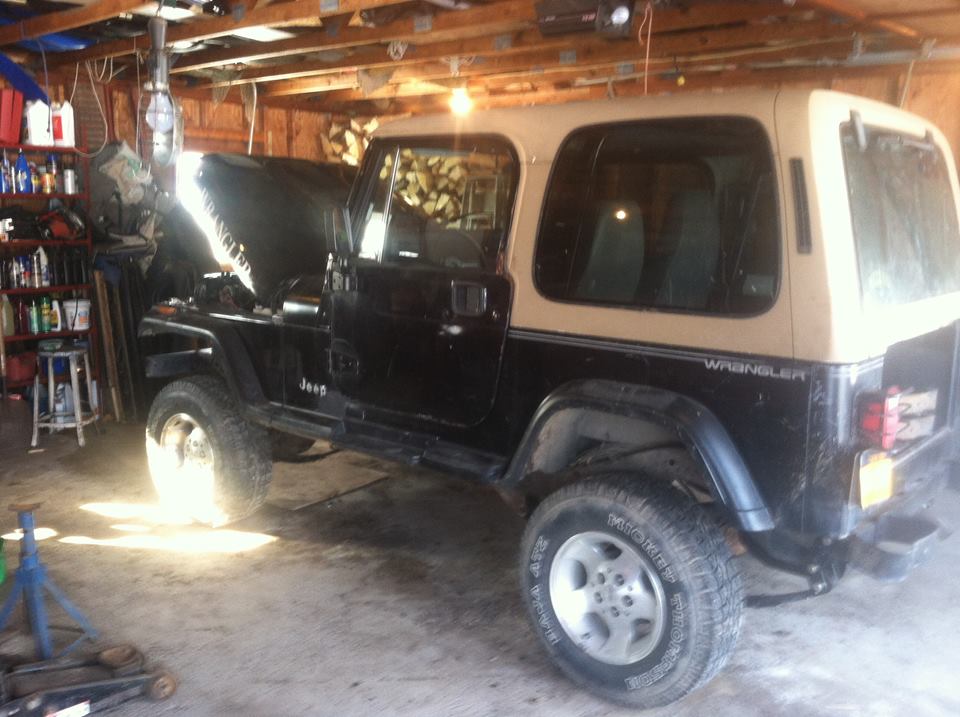

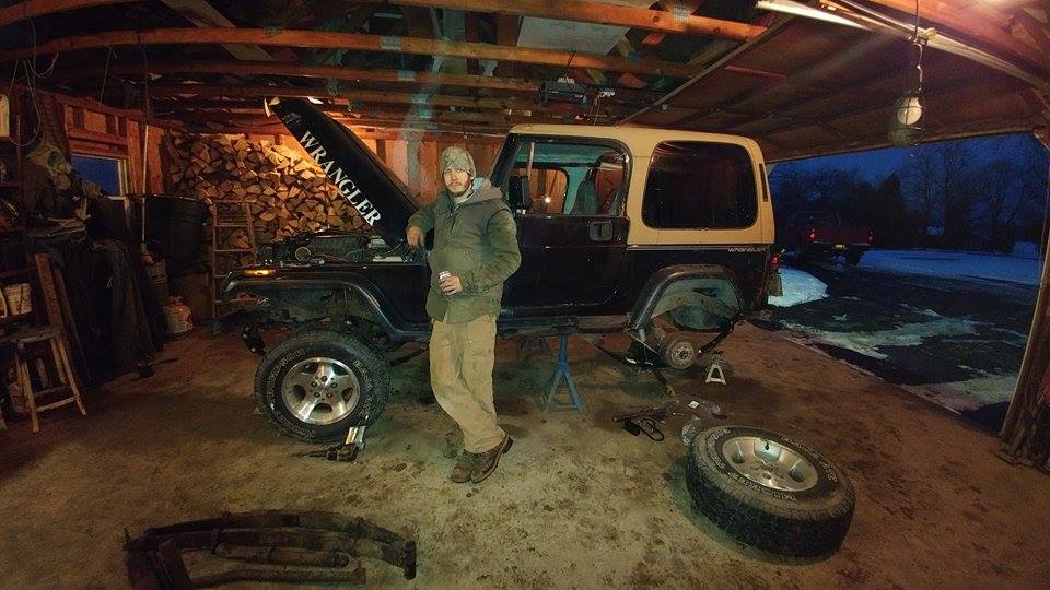

This Is about how high she's going to sit. The back will be an inch or two lower than where it is now!Full weight on the front!

it will settle after some driving. the leafs are just brand new.
