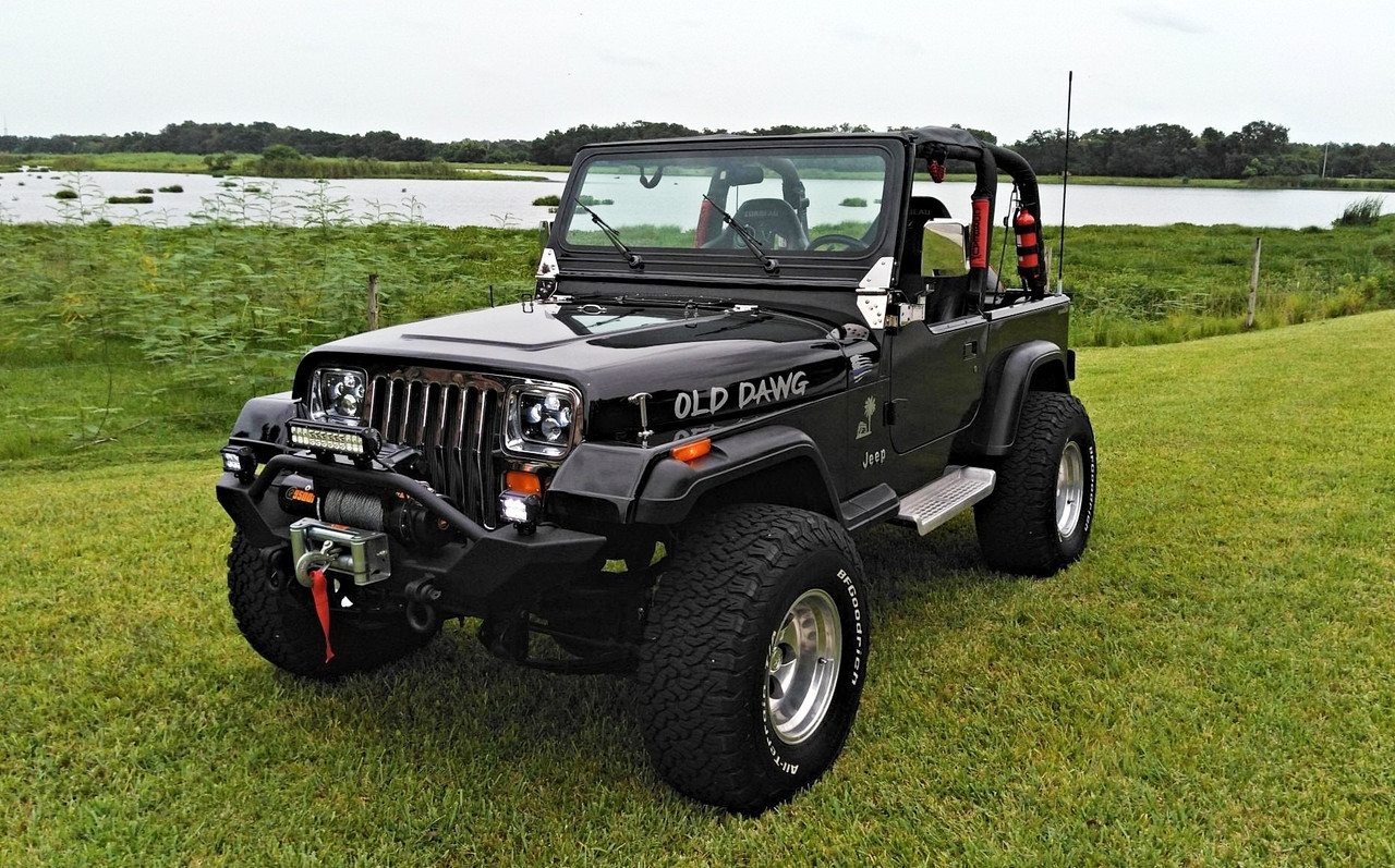

    I thought about doing the same last year, but decided against it after realizing that I wouldn't run the trails as hard in a new one like I do in the Old Dawg YJ. Since the YJ is my fun weekend vehicle and not my primary ride, I decided to keep it instead. At 30 years old its taken a lickin and just keeps on ticking. Good ole bullet proof AMC designed 4.0 inline six. They dont make them like that anymore, it just wont die.
    Plus the money that I've saved from not having vehicle payments, has allowed me to have the funds to maintain its mechanical condition, appearance and upgrades.
