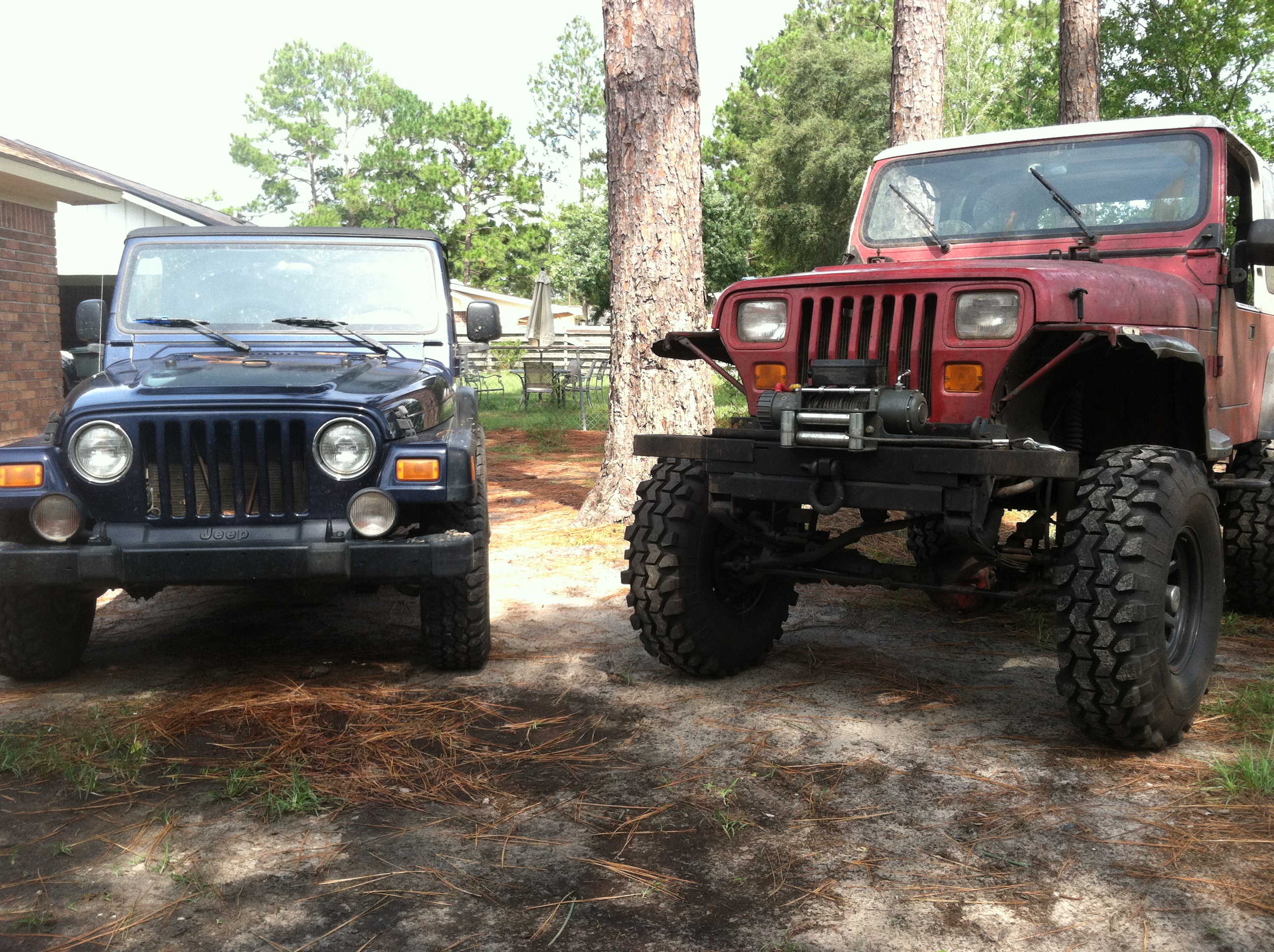

Lock it,weld it,whatever your budget will allow.You will go further than an open diff.Sure its going to increase the risk of breaking parts but thats all a part of going further than your buddies.
