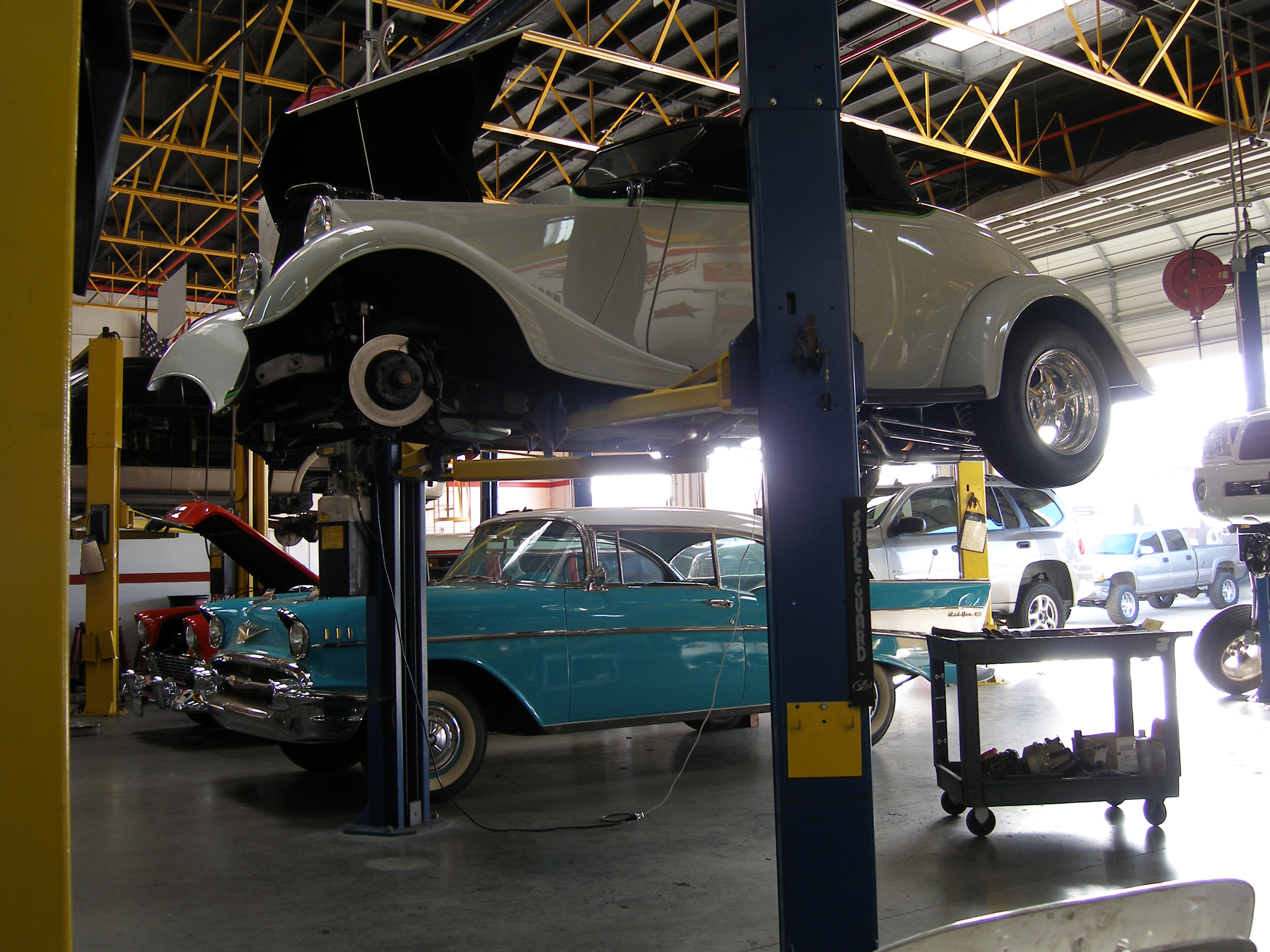

The following are a couple of shots of the shop, my Jeep as they began disassembly and lastly, and after shot of the finished product before I installed the Mac's Cold Air Intake from SkinnyPedal.com. You'll notice the aluminum radiator, silicone radiator and heater hoses, Sears Diehard Platinum battery and twin discharge nozzles for a 10-pound ColdFire foam fire suppresion system mounted to my rollcage in the tub.
